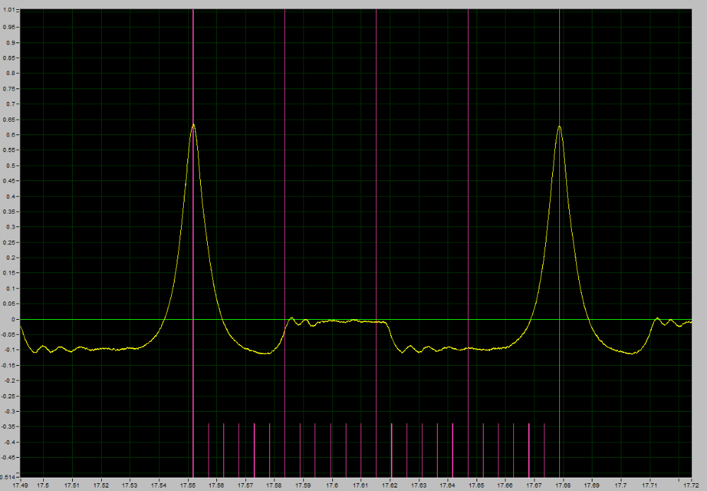

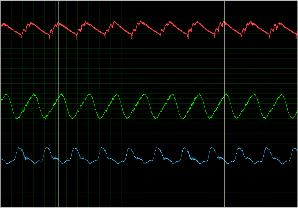

Wow, no preamble or anything! :silly: So I have to make a call based on this waveform alone?
I guess the decompression pocket is a little deeper than the intake... IVO seems a little late... Jumped timing chain?

VVT PIDs might be fun? But probably not necessary. If the intake were truly that late, there'd be more than just a P0300. Plus I rarely see this engine jump time.
Late IVO can also be caused by a wiped cam lobe or smoked cam follower. I see that a lot more often. :lol: Intake pulse waveform, please.

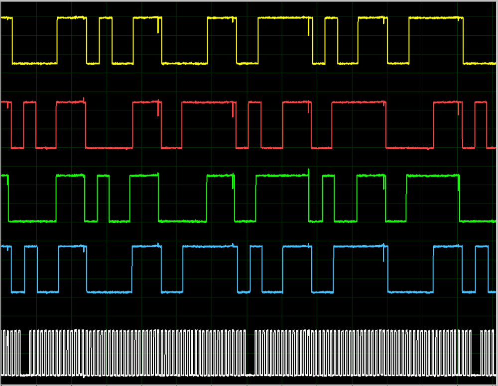

Here you go:
Unknown/Suspect Cams and Crank
eScope File
drive.google.com/open?id=1gFusaVM-E0h1E1mv5iYfXIY4w00puCmO

Tyler wrote: VVT PIDs might be fun? But probably not necessary. If the intake were truly that late, there'd be more than just a P0300.
We'll get to those later, too. ;)
RC - Voltage Inverted
NPS in Intake Manifold
NPS in Exhaust Tailpipe

5 years 10 months ago #45363 by Tyler
Replied by Tyler on topic P0300, Low Power
Annnnnnnd there goes my cam lobe/follower idea. :lol:
Intake on B1 is definitely late compared to B2. Exhaust cams seem to be in time. Why is this not setting timing codes? :huh:
5 years 10 months ago #45366 by Matt T
Replied by Matt T on topic P0300, Low Power
Tyler wrote: Annnnnnnd there goes my cam lobe/follower idea. :lol:
It definitely looks a bit late but only looks to be a few degrees. I was expecting 30*ish......

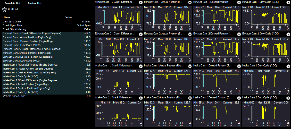

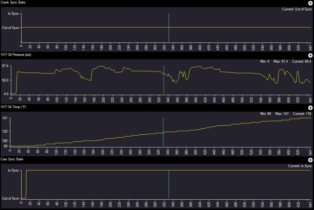

Here you go, Tyler.
Scan Data
drive.google.com/file/d/1IGgWV7FaVtfS7B8...TOt/view?usp=sharing
Last edit: 5 years 10 months ago by Chad.
5 years 10 months ago #45383 by Tyler
That wasn't as illuminating as I was hoping it would be. :blush:
But I did notice something about the camshaft behavior. Dunno if it matters or not. :huh: Using the cam/crank PIDs, with the phasers parked, intake #2 is always a positive value, while all other cams are negative.
Plus, intake #1 is always about five to seven degrees retarded of #2. Even when the intake cams are being advanced, intake #1 is always behind #2 by about the same amount. Maybe just a little bit of stretch in the chain?
Can't say that'd cause a P0300, though.

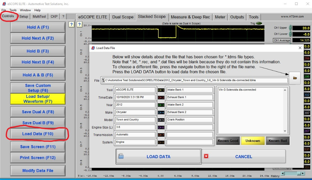

Crank "Out of Sync" :huh: I downloaded that escope software. CKP trace looks kinda rough.....
Last edit: 5 years 10 months ago by Matt T.
5 years 10 months ago #45386 by Tyler
Matt T wrote: Crank "Out of Sync" :huh: I downloaded that escope software. CKP trace looks kinda rough.....
I couldn't figure out how to open Chad's capture with it. :( It'd only let me poke around in Demo mode.

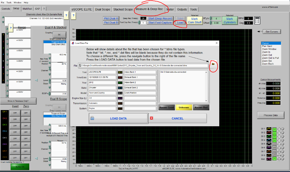

Tyler wrote: I couldn't figure out how to open Chad's capture with it. :( It'd only let me poke around in Demo mode.
As well as the way Matt T showed, you can also load files from the Measure and Deep Record mode. This is where any zooming and cursor work is done.
5 years 10 months ago #45389 by Tyler
That's what I needed. Thanks guys. B)
Can't say I'm good at it yet, but I'm getting somewhere. The CKP/CMP would seem to agree with the scan data about their being about a five degree difference between the intake cams. Still not sure that adds up to a rando miss, though. :unsure:

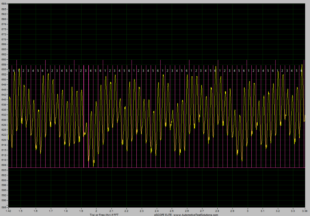

Okay, guys and gals. This one has taken an unexpected turn. I was wanting to call a timing kit, on this one. Scan Data showing "Crank out of Sync" lead me to go In-cylinder. I thought I was seeing late valve events in the In-cylinder waveform. However, looking at the Cams/Crank correlation, rather than seeing Bank 1 Intake as late/retarded, I was seeing Bank 2 intake as being early/advanced, about 5° - 6°. Bank 2 is buried under the plenum, so I can't go I'n-cylinder. Scan Data Showing Bank 1 cam/crank difference of -3.5°, and Bank 2 showing +2.5. Although I am seeing small Timing Issues, I just can't bring myself to pull the trigger on doing a timing kit. That is why I brought it to the forum. I was hoping to get some confidence in doing a timing kit. Or, I was looking for someone to tell me to quit going down the rabbit hole, and guide me in the right direction.

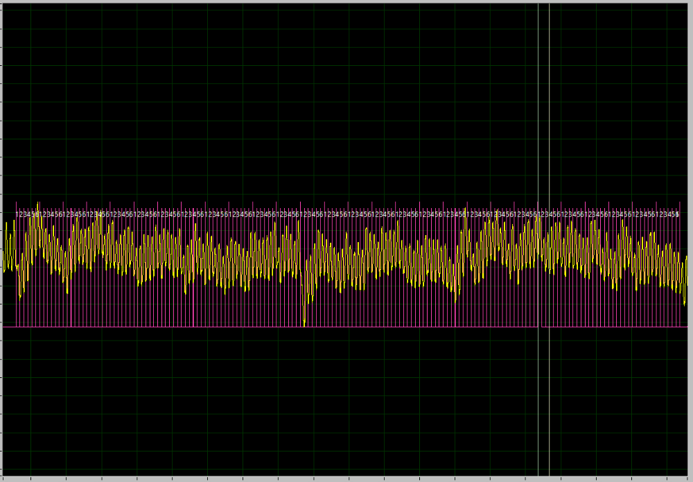

I reached out to Weycraze, as he has steered me in the right direction a couple of times before. He recommended taking a frequency of the crankshaft to see if we could see a Bank-to-Bank contribution difference. A great idea! I used the CKP/Misfire function of the eScope to plot crank frequency, with the cylinders labeled. However, the results leave me more confused about what is going on than before.(on a side note, the ATS CKP/misfire function is awesome!)
The Crank Frequency doesn't look pretty. However, I can see no rhyme, or reason, for the frequency changes. They seem to be all over the place. I, finally, decided to perform a Cam/Crank relearn, clear codes, and go for a long test drive to get a fresh look at mode 6. The thing performed beautifully. It didn't miss a beat. Mode 6 showed no misfires over a 50 mile test drive. No loss of power. Fuel trims look great. Suddenly, the vehicle seems fine. However, scan data VVT pids look the same. :woohoo: It, still, says "Crank out of Sync". Scan Data, still, shows Bank 1 cam/crank difference of -3.5°, and Bank 2 showing +2.5. :dry:
I recaptured Cams/Crank correlation, and can still see a 5° advance on the Bank 2 intake but, haven't compared it to the first capture, yet.
Right now, it is running so good that I can't justify fixing it. :ohmy: :sick: :blink: :woohoo:
