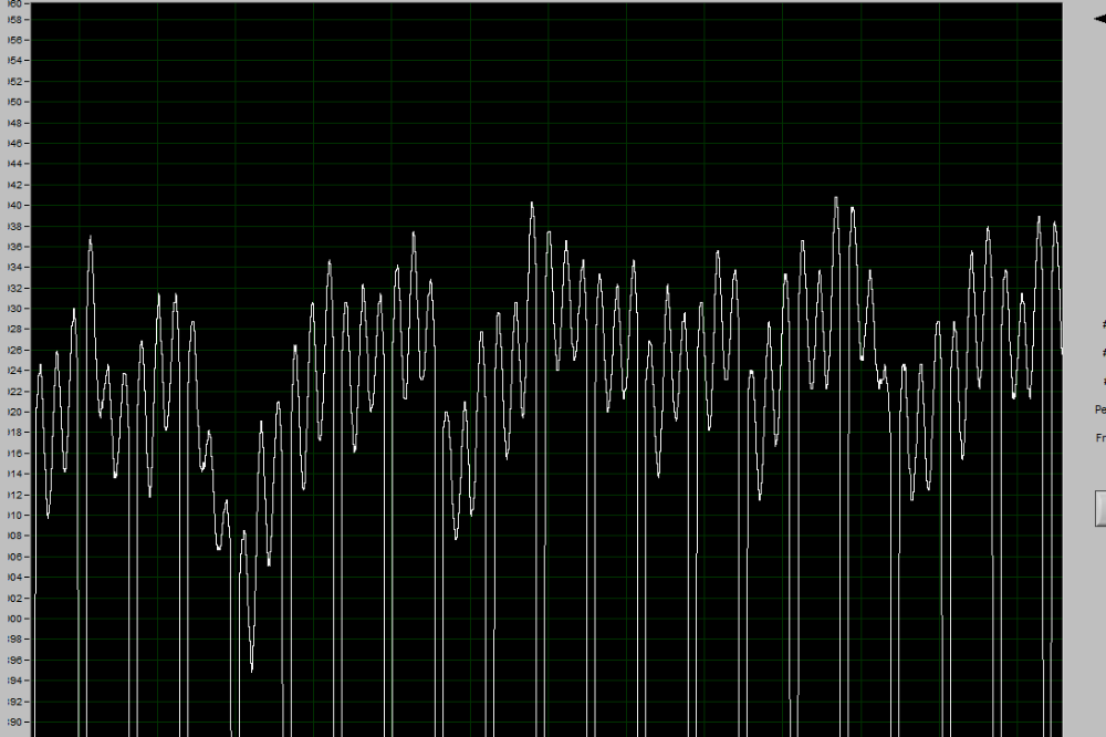

Chad wrote: [I thought I knew where this one was going, but ended up clueless. :(
And here I was thinking that you'd already fixed it! :lol: I'm right there with ya. I dunno that I could have called a timing set. Five degrees doesn't add up to a cam tooth, and doesn't necessarily suggest a stretched chain, IMO.
I reached out to Weycraze, as he has steered me in the right direction a couple of times before. He recommended taking a frequency of the crankshaft to see if we could see a Bank-to-Bank contribution difference. A great idea! I used the CKP/Misfire function of the eScope to plot crank frequency, with the cylinders labeled. However, the results leave me more confused about what is going on than before.(on a side note, the ATS CKP/misfire function is awesome!)
I was figuring out how to do exactly that when you posted. Couldn't make it work the way I wanted. :( Definitely feels like I'm wandering around in the eScope software. Part of the learning curve, I guess.
The Crank Frequency doesn't look pretty.
Truth. I'm not super familiar with these frequency plots, but it definitely looks like the trace usually peaks out around 6-1-2, and bottoms around 3-4-5. I'm sure that means... something? :silly: Again, I'd probably be able to make something of this if I looked at these more often.

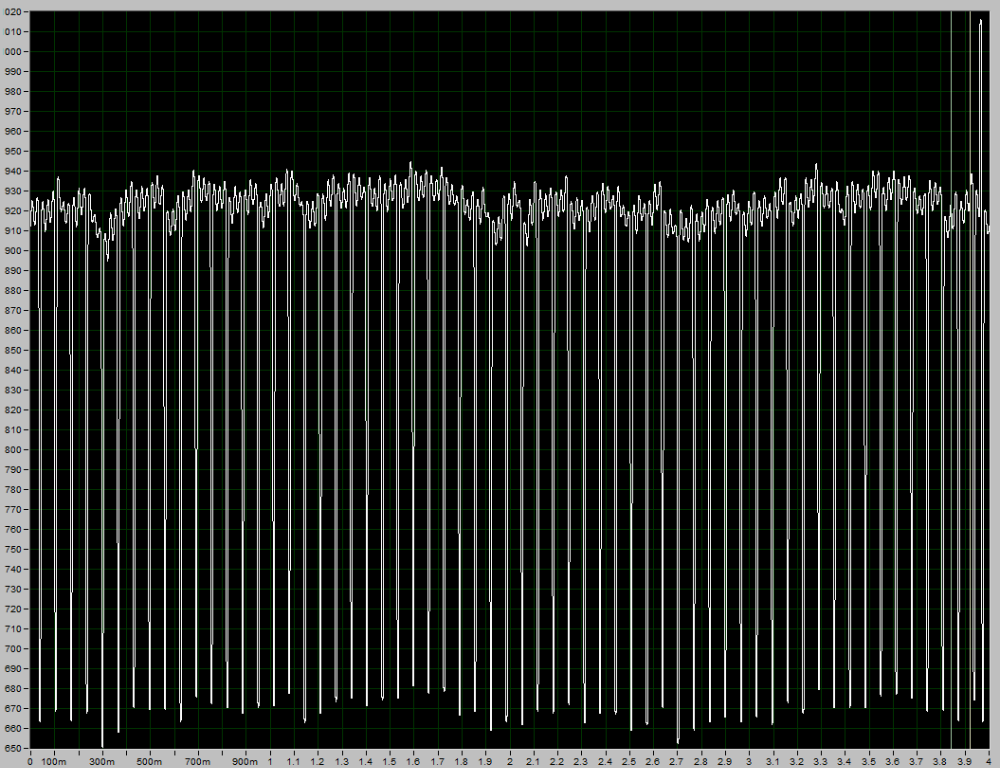

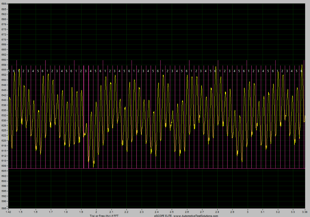

You can plot the frequency of ANY channel, after the data has been saved. But, to use the CKP/Misfire function, Channels 1(Yellow) and 2 (Red) have to be on the CKP and trigger, respectively. The Function must record LIVE data. I don't think you can apply it to a saved file. :unsure: There is a BIG difference between, simply, plotting the Crank Frequency (which Pico can do, too), and Using the CKP/Misfire function. The difference is that the CKP/Misfire function fills in the Sync Notch. Plotting Frequency does not.
This is a simple frequency plot of the Crank. The sync notch looks like a huge drop.
The sync notch makes reading the pattern a pain in the @ss.
The CKP/Misfire Function fills in the sync notch, and makes it much easier to see/read (although this one is ugly) . It's things like this that make the eScope shine.
