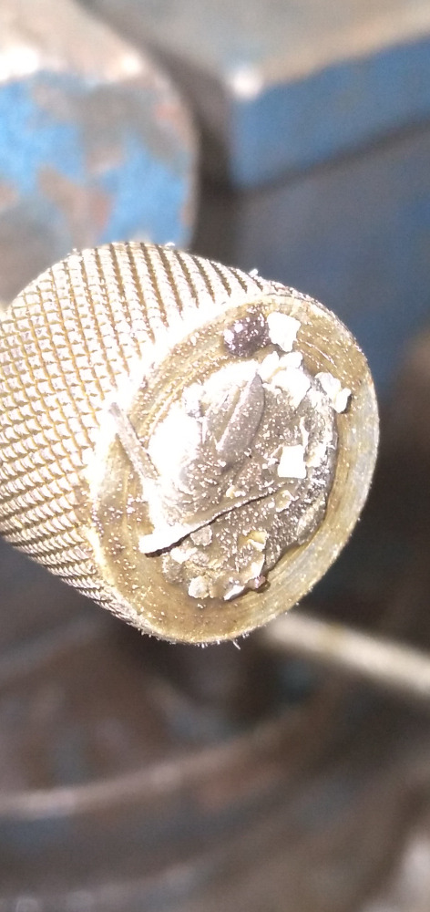

It turned out to be #2 rod bearing (#2 and#3 are companion cyliinders). Sitting on the ground, I would have bet money that the noise was in the UPPER end. I would have lost. When I, finally, got it into a bay with a lift, It was clear that it was LOWER end. I pulled the oil pan:
and removed the oil pump.
Video
For those that are thinking it, I will go ahead and say it. Old-school methods would have diagnosed this in about 15 min, or less. But, I would not have had NEAR as much fun.?
Video

It was certainly interesting, and it was a good opportunity to brush up on in cylinder waveforms.
So the No1 low compression was a red herring - but still there.
What old school method would you have used for this other than perhaps a stethoscope might have nailed it bottom vs top then get the spanners out!

With that much play in the rod lower end, that piston may have been contacting the cylinder head. A borescope inspection in the cylinder may have exposed a clue in the piston carbon deposits being "modified" by the contact.
