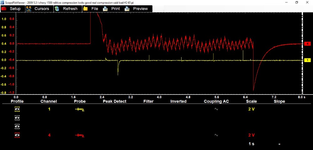

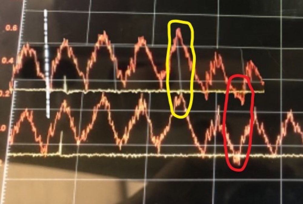

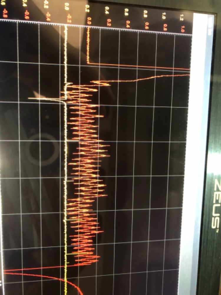

Hey guys i just wanted to talk about what i found today and what yall think about it. I got in a job today it was a misfire. They already shot it with a parts gun. they said when they went to autozone the scanner said #4 cylinder miss fire so he did plugs wires. Then a new coil on #4. When the truck came in it had P0121- TP sensor, P0300-Misfire Detected, P0573-Brake Switch codes. On the scan tool it showed 48,750 misfires on Number #4, 200 on #8. So I got out the scope and started testing everything.. I need to get better at scoping anyway. Well I did a relative compression test and as far as I can tell its good. I tested injectors and spark on all the coils with my probe that i have to hold on there. And everything looked good. So then I went back to my other tools ... Fuel Pressure, injector pressure drop and then compression test. Turns out #4 compression was a little low 95 psi, still I didnt see the problem. So i checked the next easiest one to get to and it was #2 Turns out it only has 65psi. Of course I didnt trust it so I went back and forth and cleaned out my test hose and gauge. But it wasnt lying. So I got the scope back out! went back to doing a relative compression test I new what i was looking for and still couldnt find it with the scope lol.. did i miss something??? I will post a picture of the test in a minute off my phone. Has anyone else had a problem like this???

5 years 8 months ago #46886 by Mike T
Here you go
5 years 8 months ago #46887 by Matt T
I'm really not sure what settings you used to capture that waveform??
Anyways there do appear to be some repeating high and low points which suggest there is a compression problem.

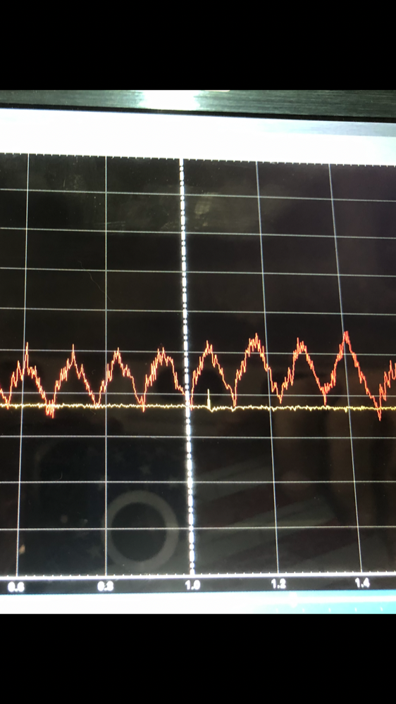

5 years 8 months ago #46889 by Mike T
I used my amp clamp inverted to make it go up set at 2v on 2s screen and my probe to mark a cylinder. The cylinder with the mark is #2 the problem child

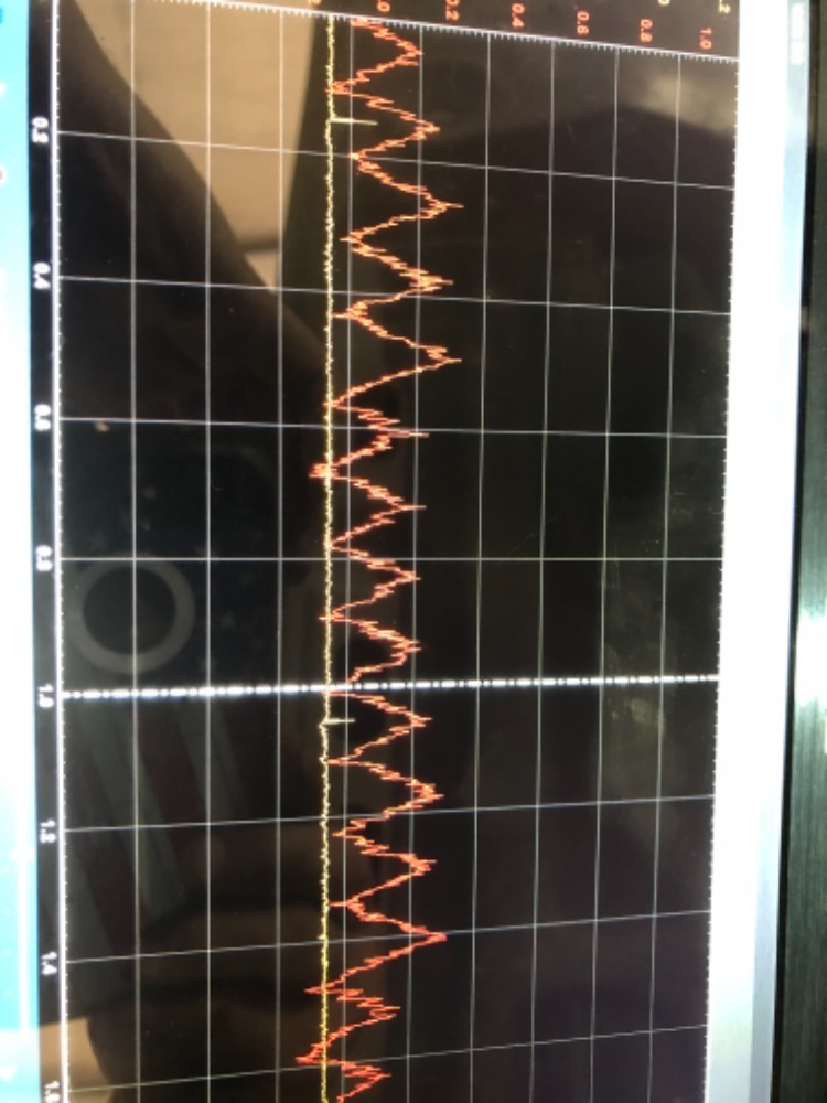

5 years 8 months ago #46893 by Mike T
This is all 8 cylinders. Firing order is
1-8-7-2-6-5-4-3
  • Mike T

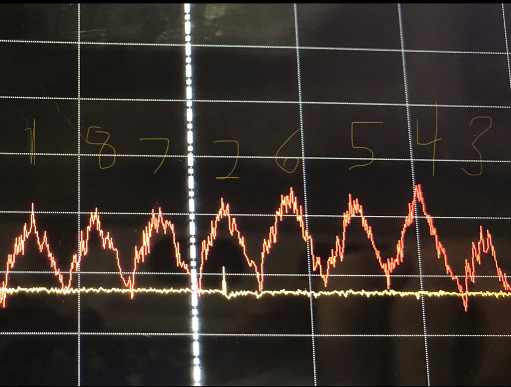

  • Mike T's Avatar Topic Author
5 years 8 months ago #46894 by Mike T
Here is a little better pic the one on the end does look low but I checked #4 and #2 on compression I didn’t check anything else.
5 years 8 months ago #46899 by Tyler
Did you happen to save the .VSM file for the scope capture? Would you mind sending it to me? wrenchturnsyou@gmail.com
There's something too symmetrical about those compression humps, IMO. You're positive you were clamped around the correct battery cable?

5 years 8 months ago #46902 by Matt T
Mike T wrote: I used my amp clamp inverted to make it go up set at 2v on 2s screen and my probe to mark a cylinder. The cylinder with the mark is #2 the problem child
Were you using AC coupling? Looks like the current trace drops below zero.

Yes I was using AC coupling
5 years 8 months ago #46906 by Tyler
Thanks for the email, Mike T. B)
Like Matt guessed, I believe the problem is AC Coupling on both channels:
If you were using an amp probe on channel #4, then that'd be why the waveform missed the obvious compression issue. :blush: Do you still have the truck? Try retaking the same waveform with coupling off on both channels. Should generate a much clearer picture.

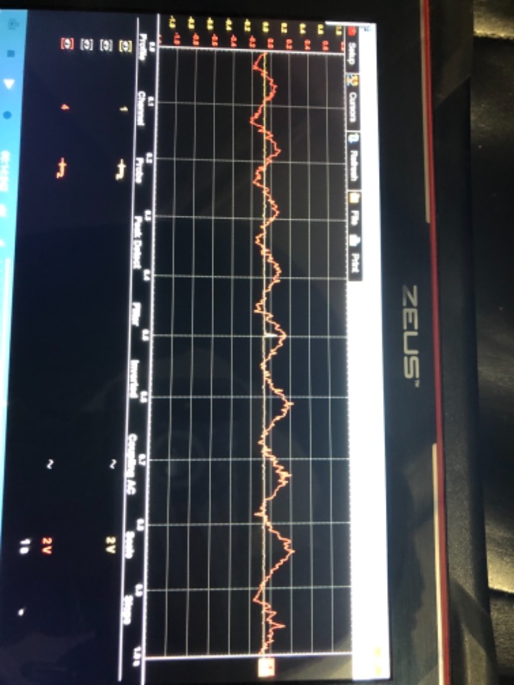

5 years 8 months ago #46907 by Mike T
Here’s another pic

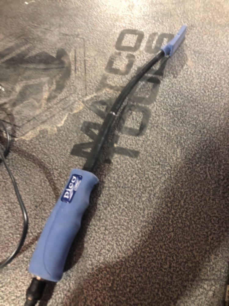

5 years 8 months ago #46909 by Mike T
So I should leave all the voltage the same Just No ac? Here is a pic of the probe I was using for ignition mark
5 years 8 months ago - 5 years 8 months ago #46910 by Tyler
Mike T wrote: Dang, No I don’t have the truck anymore he just wanted Diagnostics when I found the issue was compression.
I wouldn't sweat it, sir. You're learning a testing method. You made the right call with no parts changed. :cheer:
So I should leave all the voltage the same Just No ac? Here is a pic of the probe I was using for ignition mark.
Probably? If you were using a low amp probe on the 10 mV/A setting, then 2V will work for the relative compression trace. With the Pico wand, I'd probably turn on Peak Detect to make sure you get a solid ignition event.

5 years 8 months ago #46913 by Matt T
Mike T wrote: Dang, No I don’t have the truck anymore.
Experiment on another vehicle. You can pull a spark plug to create an obvious compression problem. Then screw in a compression tester hose to make it less obvious.
Once you get the voltage settings figured out then experiment with filtering to clean the waveform up.
