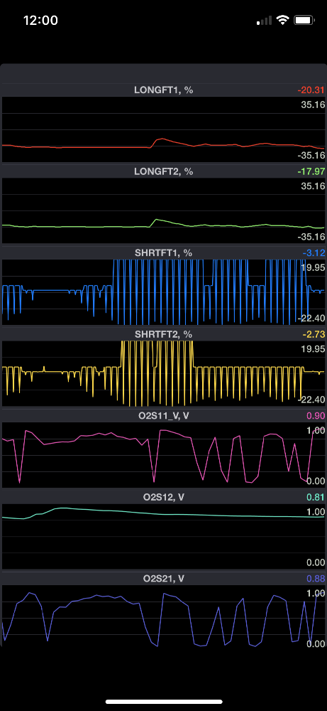

I have a 2000 3.0L FFV that is having high negative long term fuel trims at idle, and I'm not sure what to troubleshoot next. The trims stabilize around -8 LTFT/+2 STFT when driving, but will spike to -15 after pulling off the freeway and idling.

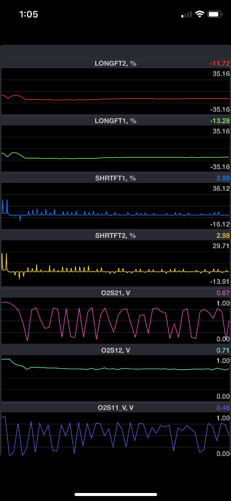

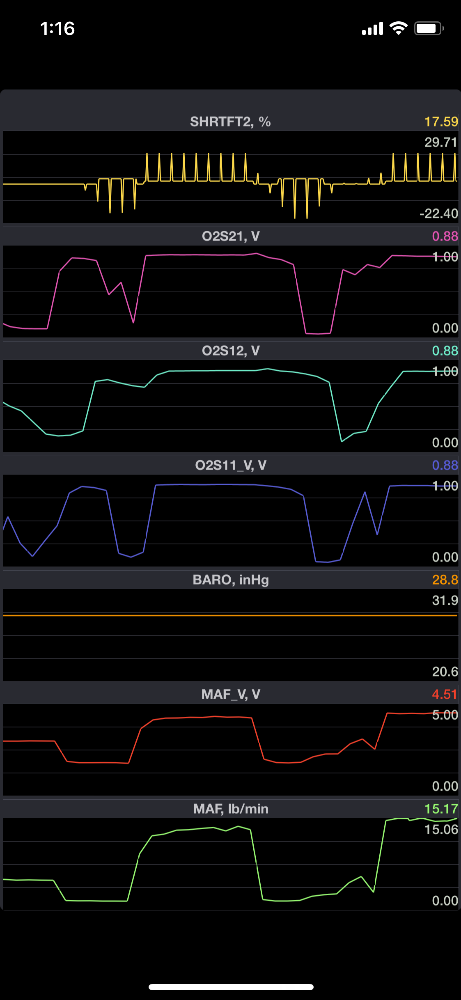

Driving at cruising speed -
After exiting freeway and sitting at idle:
WOT in 4th gear-

Replacement MAF from Autozone - original looked slightly burnt and BARO value was slow to update

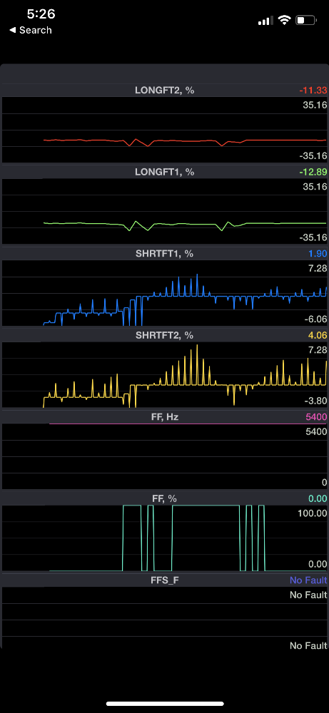

The first question that came to my mind when I saw FFV, is what does the Fuel Composition/Alcohol Content pid say?
The second thing I would look for is a leaking Fuel Pressure regulator. Remove the vacuum hose from the regulator and make sure it is dry. If you it is wet with fuel, it is leaking.
Fuel pressure should be higher KOEO. It should be about 10 psi lower KOER. Engine vacuum allows more fuel to pass through the regulator and return to the tank, lowering fuel rail pressure. When vacuum is low, fuel pressure is high.

A user on another forum suggested the Flex Fuel sensor as well, and the value is spiked. I'll try to look for a replacement unit from the junk yard tomorrow.
