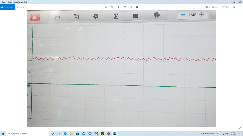

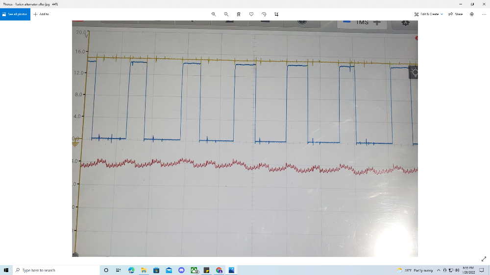

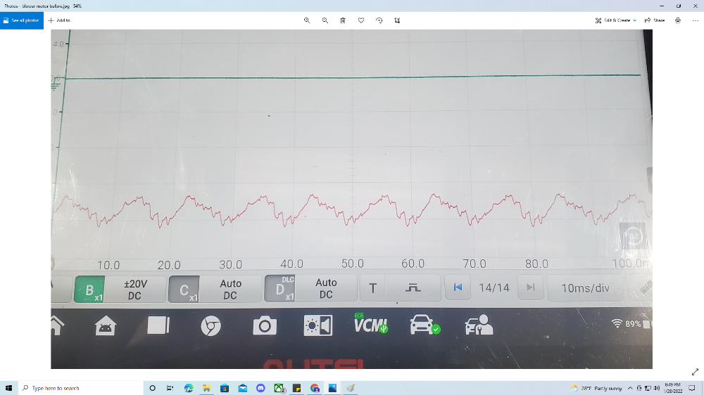

first pic is a 13 fusion alternator, i current ramp with a 1mv to 1mv1 65 amp amp clamp at the alternator. i used the gen comm and gen mon. i dont think the monitor was captured at the point the pic was taken. either way, the "check charging sytem" message came on the dash randomly. i scoped and got that image. seems fine to me till i got the new alternator and recheck and you can see the amperage is much more constant.
second pic is an update with the new alternator, no message on dash, you can see the amperage on the scope reading much more "steady" any help or input for an explaination would be great
third photo, is a blower motor inop at times. i current trace the motor, just to see, and i figured the amperage reading would be a square wave? just a normal blower motor.
fourth photo is the motor, resister and the power wire repaired, got a little hot. current is "steadier" again

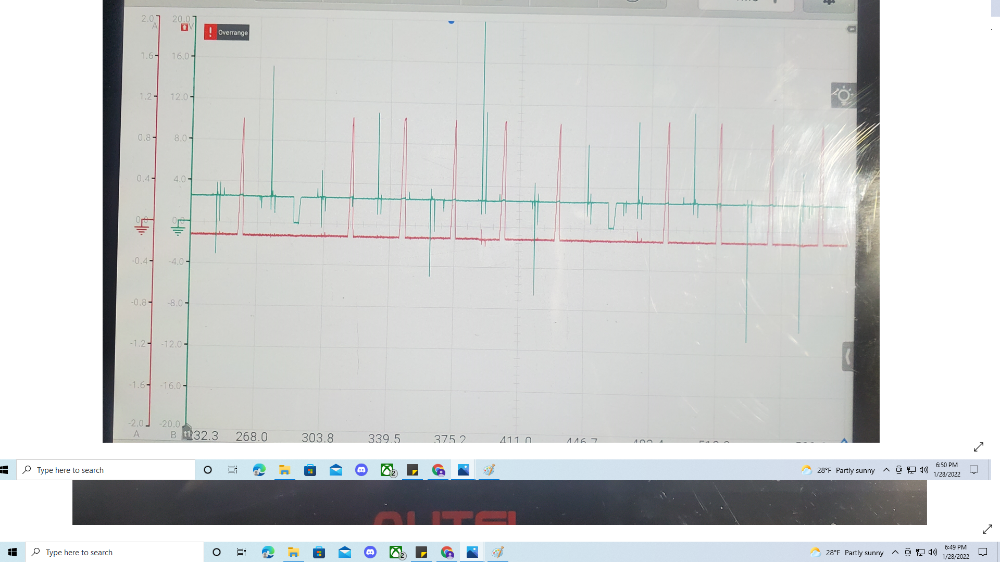

5th photo is a current for main power to injectors and a trigger on injector 1, open circuit. again, i figured my traces would look different than they do compared to what i see on youtube, i know they use a pico and snap on scope but voltages should still graph the same?
thanks in advance for any help. not looking for you to diag my problems, just want help understanding what im seeing, am i doing it correct, etc.

injector current plus trigger off injector 1

Regarding the blower motor pics: they seem to be taken with different time bases and different vertical resolutions. This doesn't help while trying to compare them 1o1. You may want to use the screenshot function within the Autel itself. This will allow to see the settings/scope configuration. That said, there is nothing in the "before" capture that'd had raised my suspicion, the commutator transitions look fine. Again, there is no indication of total current consumption.
The injector capture shows a lot of drop outs and noise, especially on the (green) voltage scale. Actually most of the events do not match with the current ramps, they happen at different points in time. Often they look like some kind of interference from the ignition system. I am not sure if the green trace was connected correctly to injector #1 control side, the capture showing less than 4 volts as "base" voltage when there should be present system voltage?

for the injector it was main power in, red, and green was the control on the injector. i current ramp, red, to main power feed and thats where i saw the no current draw on the scope and triggered off cylinder 1. i knew i had a bad injector with the fault. i ohm the injector and again i just wanted to see that waveform. thankfully my job is hourly and allows me to use my scope.

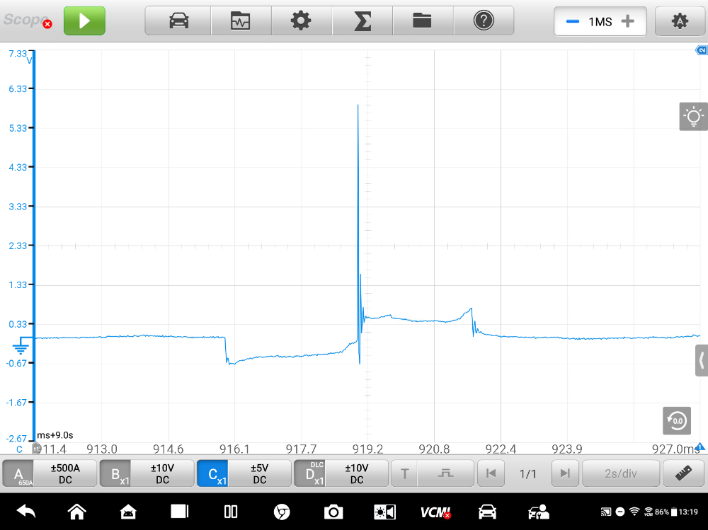

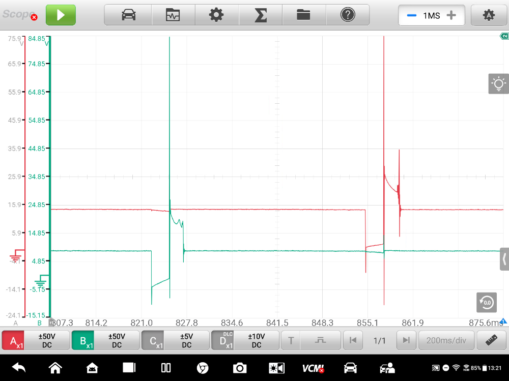

Here's a screenshot of a secondary ignition capture I took with a homebrew sensor:
Another with two primary ignition events:

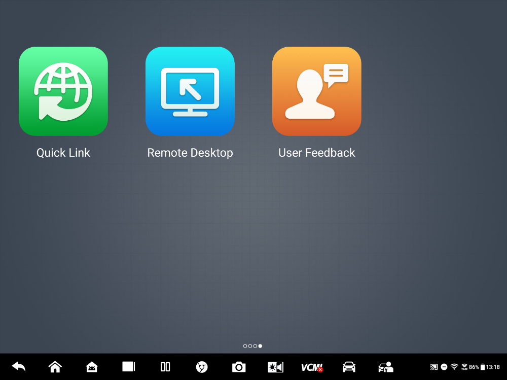

Speaking of screenshots, I've found the easiest way to get captures off the Ultra is to use the Remote Desktop feature:
It's really just a link to TeamViewer, which you can use for free from start.teamviewer.com.
