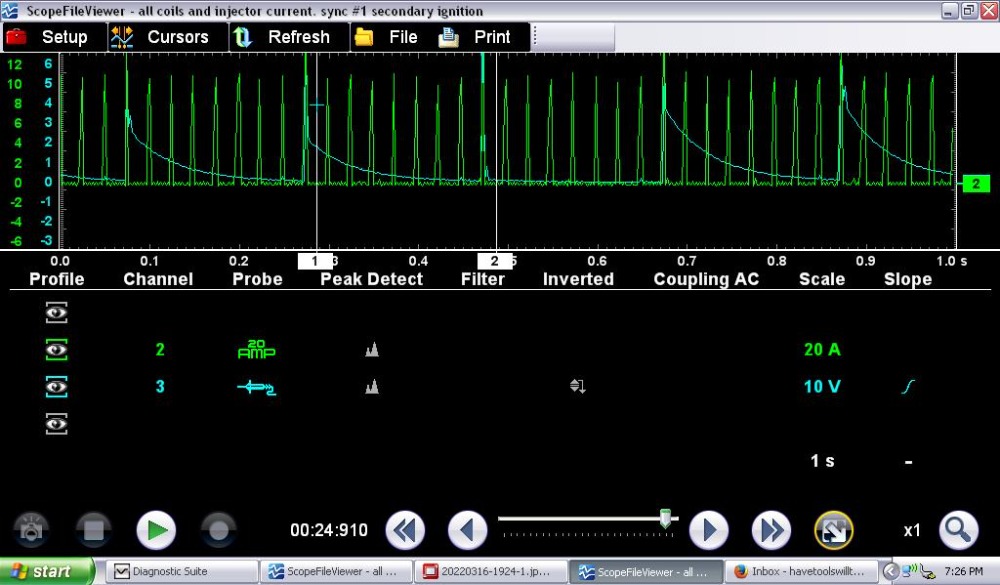

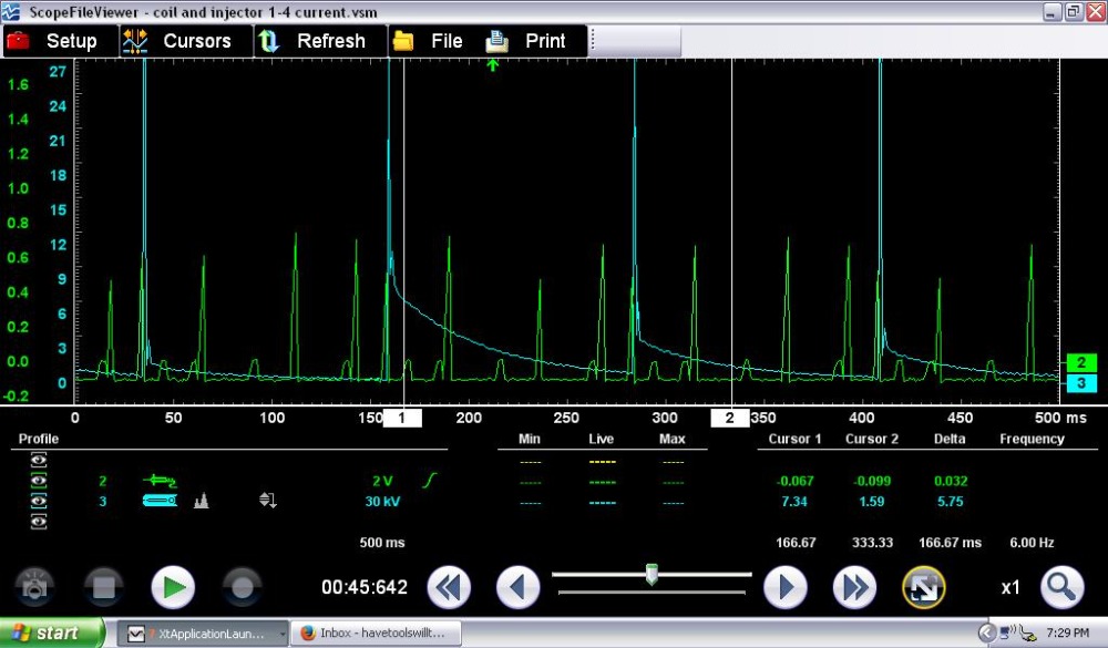

Hello, Im looking for any pointers on how I can capture a better waveform, and how to better understand what I have captured.I am using Snap On Verus. Channel 2 is low current clamp. 20A scale is 100mv/A. I have Verus on 2V scale. 2v is 20amp on the Verus. I have a fuse)s) out with current loop for coil and injector feeds. Channel 3 is aes wave secondary ignition pickup. 1000:1 attenuation. I have tried a couple different scales. I get different measurements depending on the probe I choose. Trying to make sense of that. The ignition events dont look the way I expected either. Unless I use a aes wave COP Paddle Probe, then the waveforms look more like ignition events, but the measurements are different there also. The current readings change depending what probe I select. Just looking for some clarity. Appreciate any thoughts

The ignition pick up you´re using is just that... a pick up that´s capable of showing you that an event is taking place, not more not less. It is NOT a secondary probe, these are dedicated ones.
The time you put on the capture with the paddle is way too much for the SO scope to give you detail, it will work the other way around: set the timebase to 20ms per screen and later you can zoom out if you want repetition.
The attenuation of the SO scopes secondary probes is 1:5000, different from othere makes and important for proper scaling, hth.

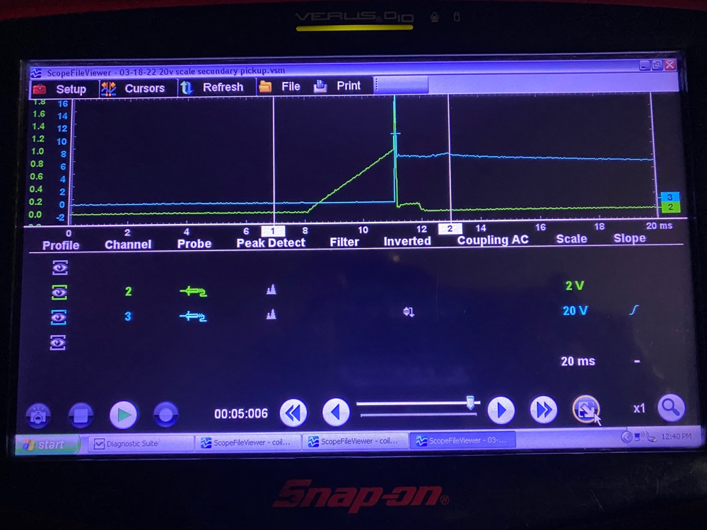

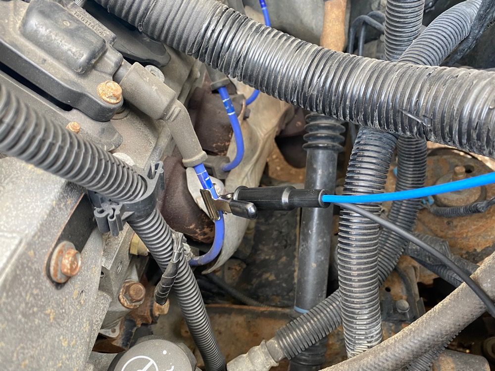

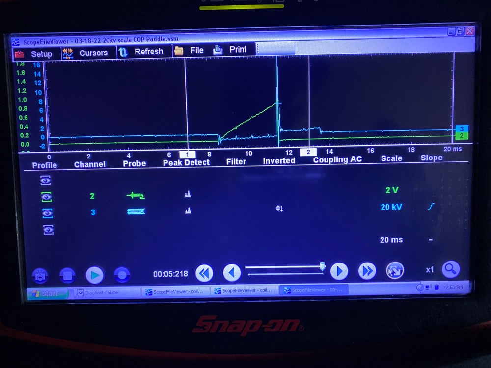

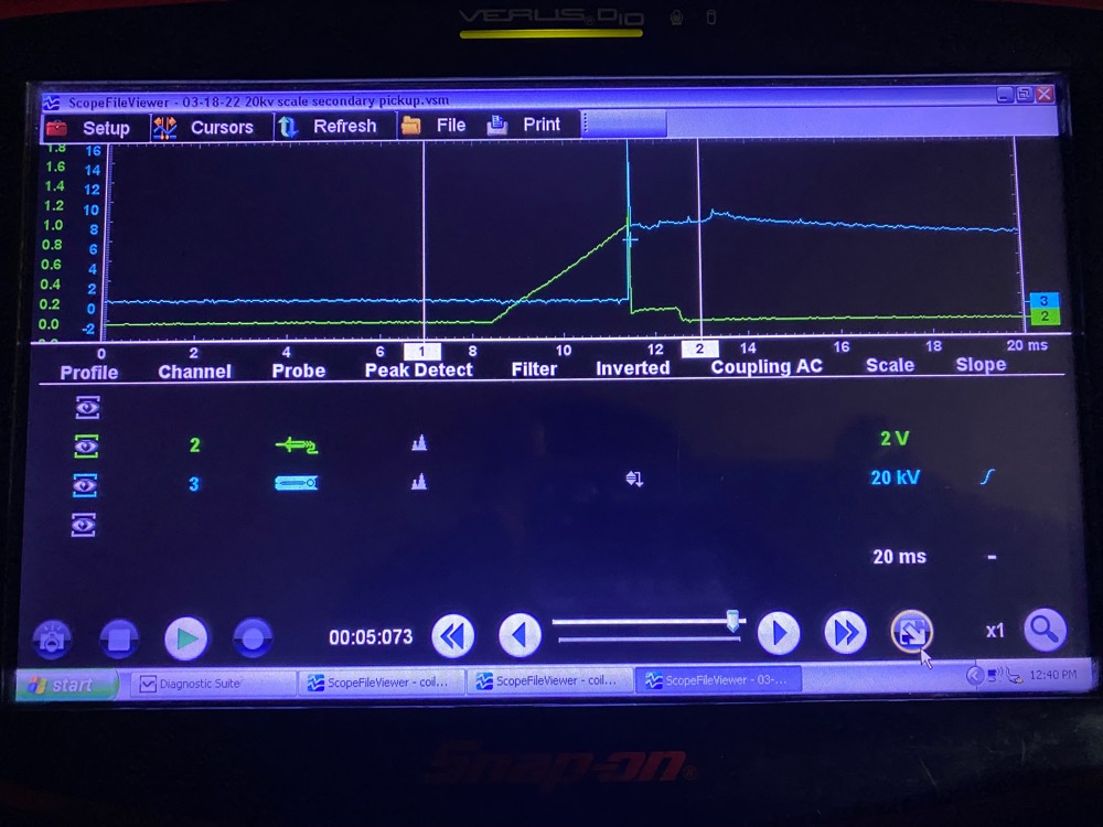

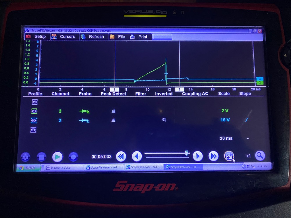

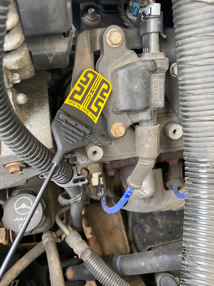

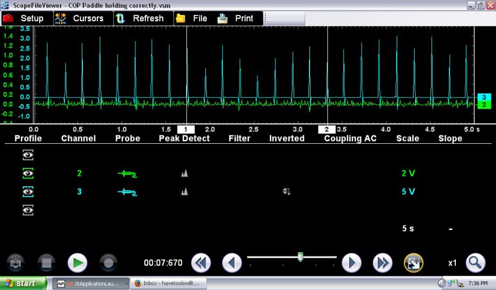

Finally got some better waveforms. 20ms time base was key. Thanks! I have included pictures of my pickups and some screenshots. I am getting 16kv at idle using my aes wave secondary pickup 01-12 regardless of what scale I am using. So I am getting different results today. Not sure why. I saw 25kv the other day. Today I consistently get 16kv if I measure in KV or volts dc since my pickup has 1000:1 attenuation. So that is making sense now. My COP Paddle (Aes wave 01-16) is giving me discrepancies though. I am measuring 16kv with it using the ignition probe setting. and I am measuring 5kv with it using the DC probe and 10v scale. My COP Paddle pickup also has 1000:1 attenuation, so I would expect to be able to measure in volts dc also and get the same measurement. And I think I figured out my amp clamp problem. My 9v battery was dying. and I was wondering why sometimes I had a good reading, and other times I wasn't.

Replied by Andy.MacFadyen on topic Looking for advice with Snap On Verus and secondary ignition
Secondary reading with a paddle probe can be inconsistent when used on COPS a couple of years back we wave form from had a Jag XJ owner who had replaced some of the coils to cure a misfire. The misfire was fixed but the secondary from the aftermarket coils were completely different from the known good OEM coils even when switched between banks.
