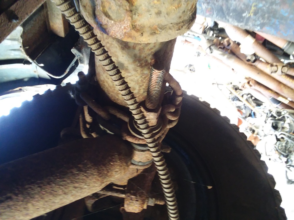

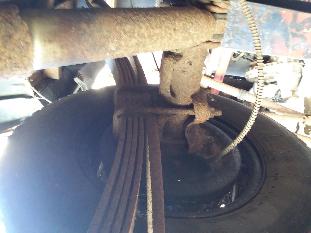

Somebody really wanted to use this rear end in their Chevy truck

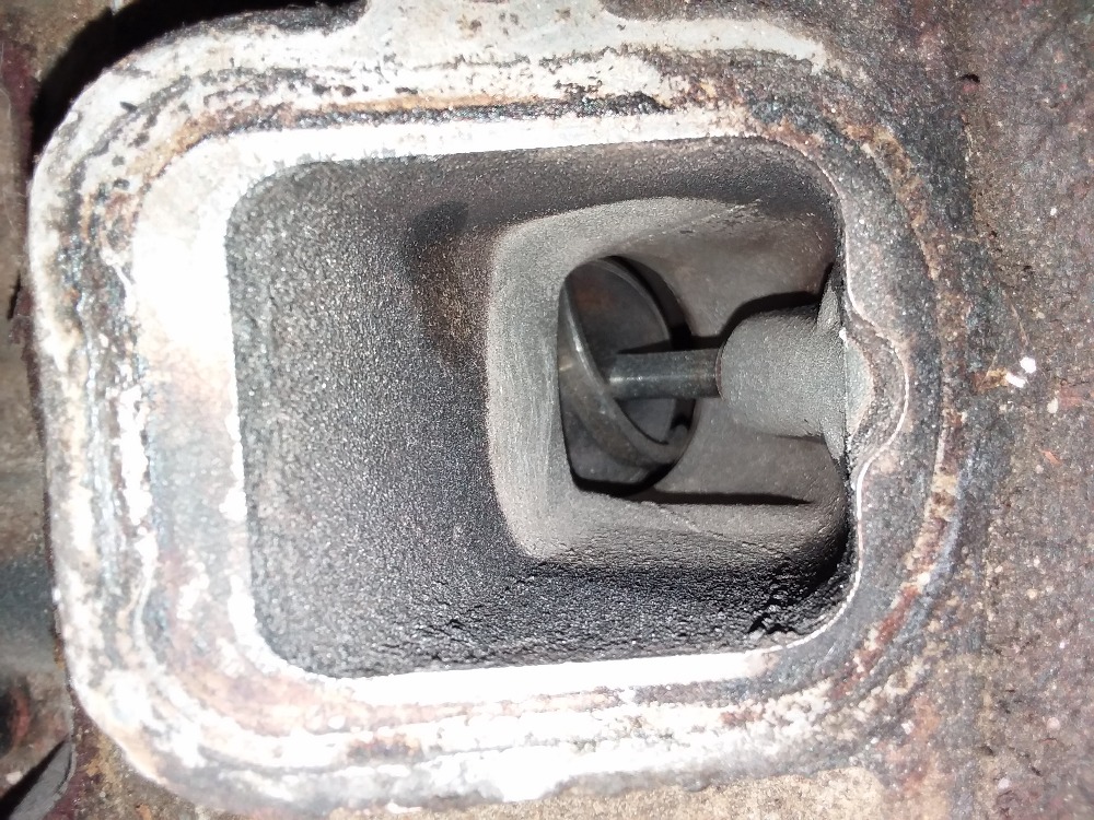

You guys seeing a lot of these?

Holy crap is that your wedding ring Noah? :)

Only on the 3.7 jeeps..
8 years 3 months ago #18131 by Noah
Replied by Noah on topic Re:Strange things you have seen
That customer said his Hemi Ram was idling in the driveway, when all of a sudden it sounded like a bag full of hammers and stalled... Forever.
8 years 3 months ago #18132 by Ben
Replied by Ben on topic Re:Strange things you have seen
Had to be a Chrysler product ... there usually caused by overheating, the head expands more than the valve seat

Anyone remember the sohc cvh motors in the mid 90's escorts and first Gen focus? Pretty much guaranteed to drop a valve seat!

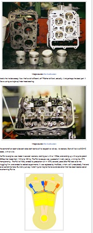

I have seen that type of failure on a 1960's Lancia Fulvia, that was a really odd ball engine the classic narrow angle V4 layout that Lancia had been using since the 1920's --- V4 but both banks shared a single cylinder head ! and twin Weber 40DCOE carbs
