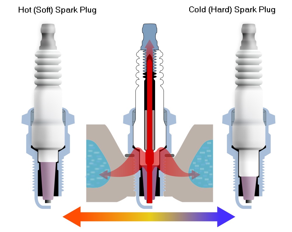

Heat range: All these early spark plugs had a limmited heat range which caused problems with either cold fouling or plug overheating.
To resist cold fouling and avoid overheating the tip of the spark plug should run a temperature between 450 and 800c
Hot spark plugs resist cold fouling but risk plug over heating and pre-ignition Cold spark plugs run cooler. Manufacturers produce a wide "heat range" of spark plugs to produce the most suitable plug for any engine.
Cold fouling was a real problem often spark plug manuafacturers would list two different spark plugs for town and normal use, as late as the 1970's Champion for the Mercedes fintail 190 and 200 listed the N6Y plug for normal use and the hotter N9Y for town centre or taxi use.
Back in the old days before electronic fuel injection, and high energy ignition systems pre-1960's it was not uncommon for racing car and bike engines to be started on hot spark plugs which were changed for cold plugs before going out on track. Racing mechanics traditionally called Hotter spark plugs "Soft" and Colder rated plugs "Hard".
This image is from the NGK Website
The difference between a hot plug and a colder plug is the amount of ceramic core exposed to hot combustion gasses and area of heat path available to conduct heat way from the core.

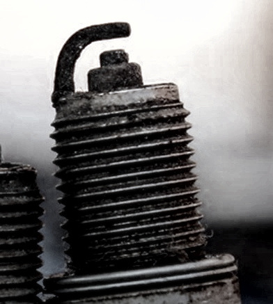

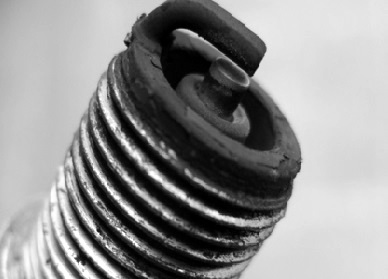

In the early 1960's Champion first marketed spark plugs with a extended nose core,. The tip this style of spark plug reaches running temperature quickly but air from the inlet valve flows over the tip of the spark plug during the induction stroke and prevents it reaching damagingly high temperatures.
This is the business end of a champion N9Y one of the first projecting nose spark plugs to reach the market, with Champion spark plugs the Y suffix on the type number indicates a projecting nose type
Compare the nose of the plug with the picture below a Champion N5 the spark plug it replaced in a lot of european car applications

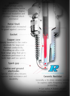

NGK took a different approach to the same problem they introduced the Copper Core On a copper core plug the centre electrode is built around a copper inner rod the acts as a heat sink to remove heat from the nose of the plug, effectively allowing a hotter (softer) heat range plug to be use without it over heating.
Thaking a que from Japanese motor cycles these plugs were much in demand for car racing in the 1970s. Champion and Bosch had no equivalent at the time.

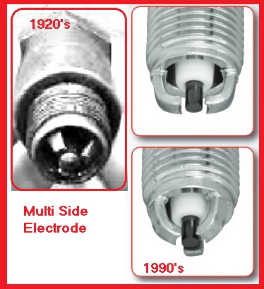

At the start of the 1990's car manufacturers were looking for ways to extend service intervals, this required finding away to extend the life of spark plugs. One of the methods used was to revamp a 1920's idea and use spark plugs with multiple side electrodes. With this type of plug although there are between two and four side electrodes only a single spark will jump (always from the side electrode with the narrowest gap to central electrode) on each ignition event
