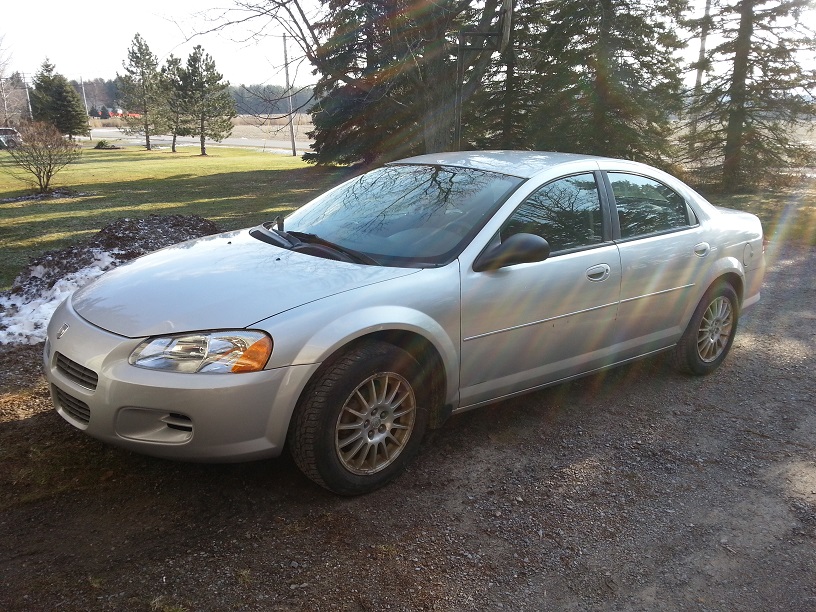

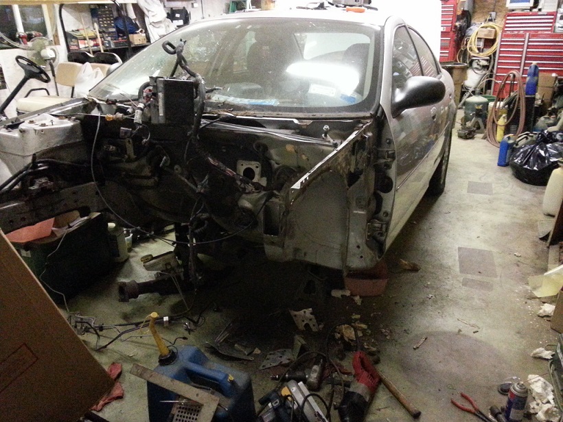

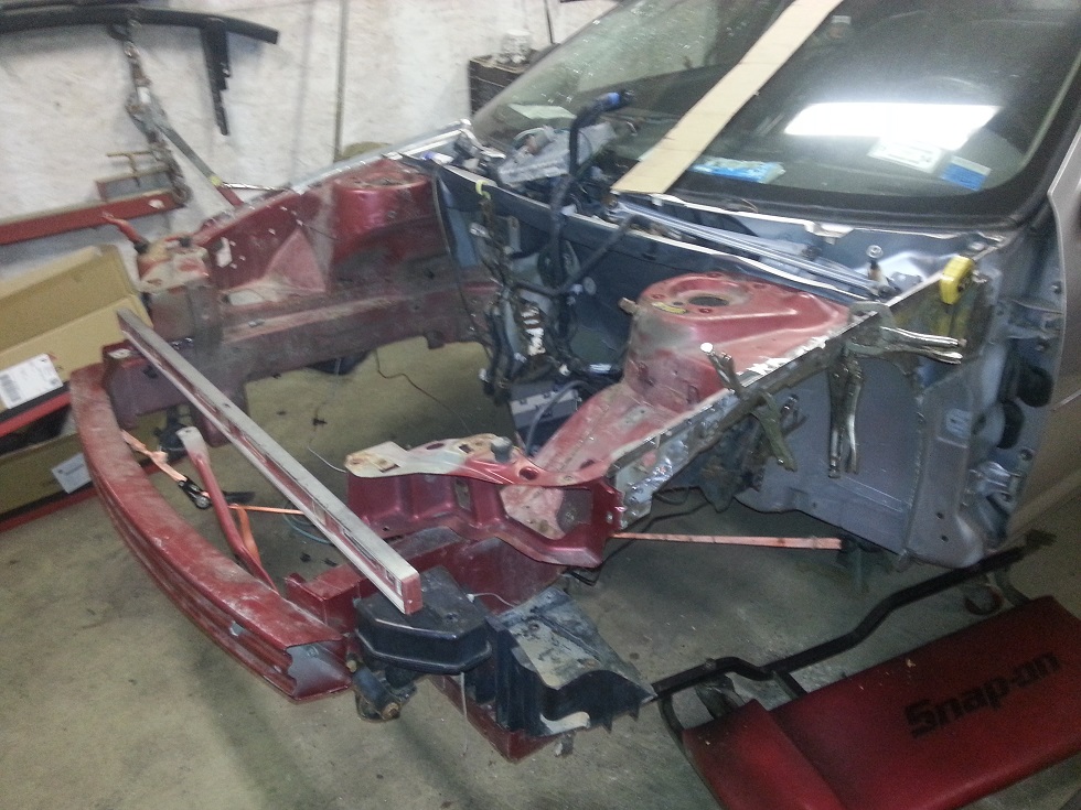

Here is a series I took of a car that I fixed for my neighbor. I sold the car to her son after replacing the engine and some other mechanicals. He proceeded to try moving a cement barrier 3 weeks later, totaling the car. His mother was still paying for the loan and had just lost her husband, so I didn't have the heart to sent it for scrap. It took me the better part of 8 months to get up the nerve to do this as I am not a body man. Almost 2 years trouble free since done.
After removal of the carnage
donor chassis
Floor pan pulled back out
test fitment
Panel tests
Finished product

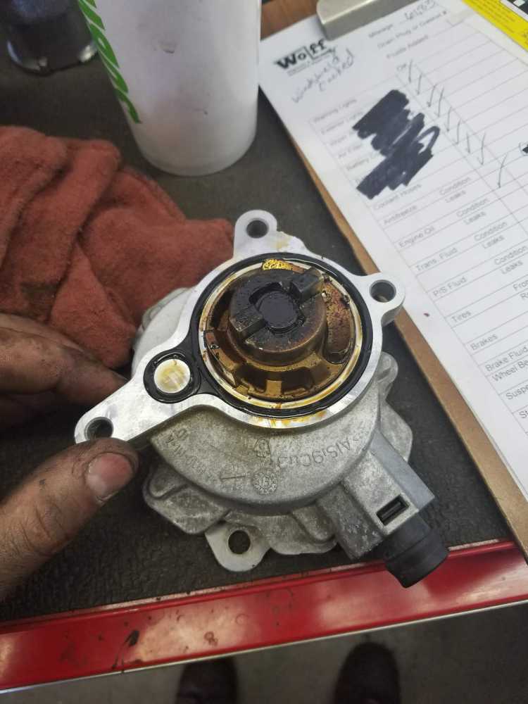

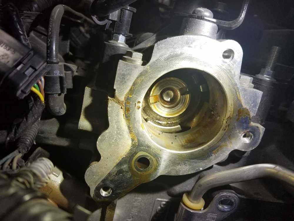

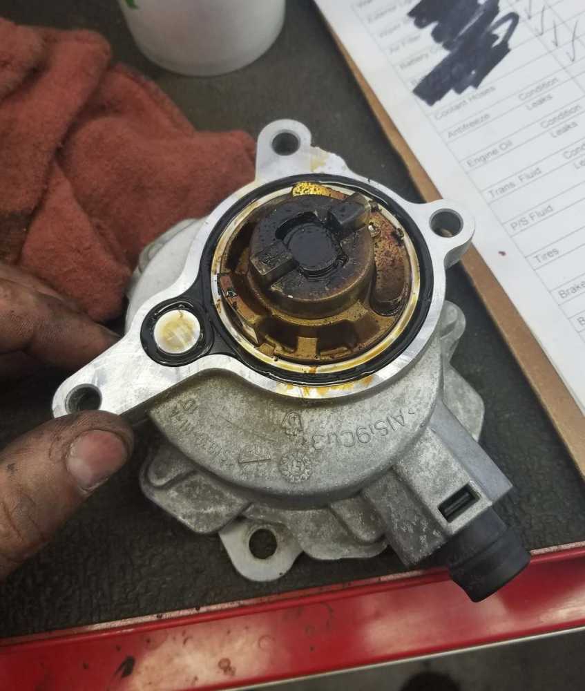

2015 Land Rover comes in with no power brake assist. It uses a normal vacuum booster, with a vacuum pump on the intake camshaft. Tech finds no vacuum at the pump, no other controls present, sells a pump. Here's a shot of the engine bay:
And the back of the pump itself:
Gets the pump off, and his exact words were, "Houston, we have a problem." :lol:
Oops! The drive plate for the pump snapped off in the intake cam when the vacuum pump seized up. Just curious, can any of the Euro guys tell me if this is a common failure?

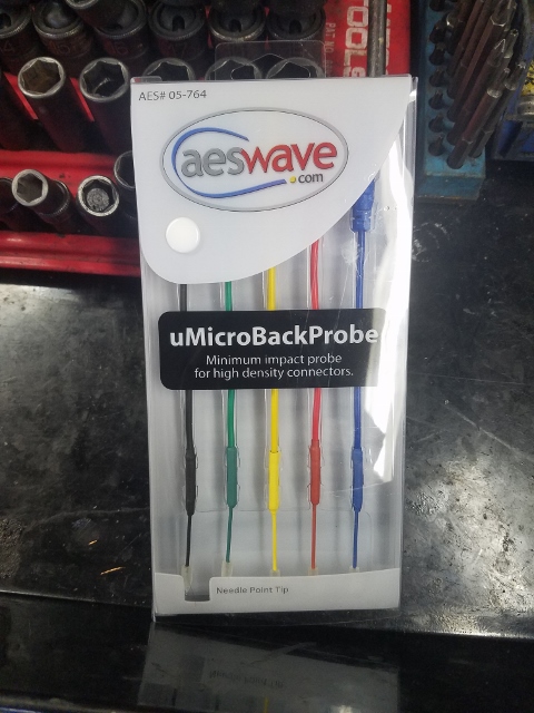

New toys!

I was just checking those out on AES Wave! I'd like to know how they work out for you.

Love 'em so far. Didn't have many opportunities to play with them on Friday, but they look like they'll work well.
Only concern I have is having the pins themselves bending. The regular backprobes have replaceable pins, but not these :( I'm somewhat hard on backprobes, so I'll have to be careful how/when I use these.

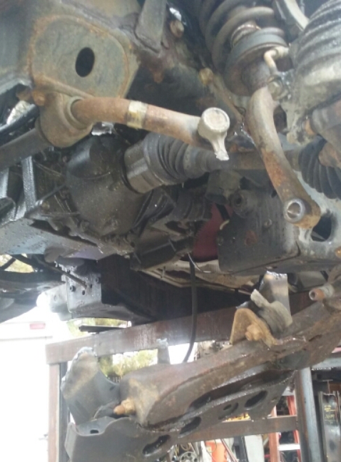

Trailblazer front chuck?
I Win!

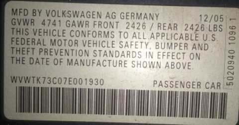

This is exactly why I'm so strict with my guys about going by the tenth digit of the vin instead of the date of manufacture!
This 2007 was manufactured in 2005
  • Tyler's Avatar Topic Author
9 years 11 months ago #3828 by Tyler
Replied by Tyler on topic Post your work pictures here!
Whoa, seriously? :ohmy: Yeah, always go by the 10th, but I can see how someone might get confused there.

A similar story from about 1980, a lady customer bought a new Lancia Beta.
Now the Beta design was good but it was was probably the worst car ever for disolving into rust even by Fiat standards it was a lemon and destroyed Lancia's reputation in the UK market to the extent Fiat withdrew the Lancia brand and ran a buy back and crush.
So two years the lady realises she is driving around in car full of holes and complained to Fiat.
Fiat offered her a 50% discount on a new car, new car arrived so she started to fill in her insurance forms --- the chassis number was only 5 higher than than the car it replaced it turned both cars had been built in 1976.
Fiat and Chrysler the perfect storm.

Heuh?? Manufactured in 2005 :dry:

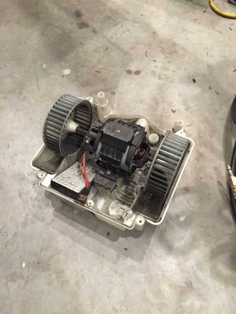

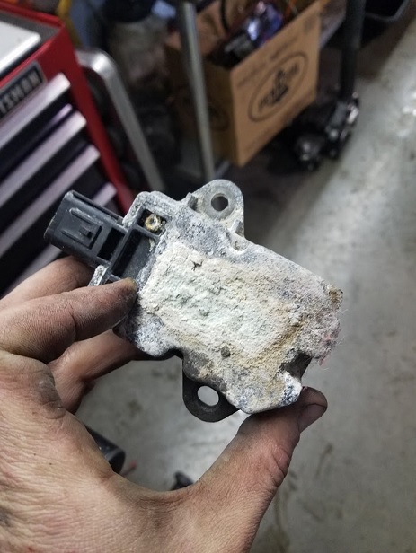

Replacing a blower motor on this ugly rust bucket.... the part alone was 400 at the dealer.
