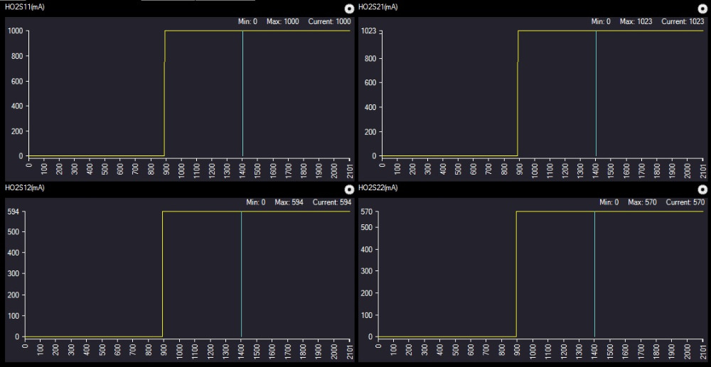

It might work? :blink: I know that on most makes/models, one big difference between the upstream and downstream sensors is the amount of heater current draw. For example, an '08 Escape:
It's possible that you may end up with a functional sensor, but still get a heater circuit code because the computer doesn't like the current draw. Some cars monitor heater current, some don't, so that'd depend on the specific vehicle.

I was unaware of that Tyler! Could it be due to duty cycle variation of the heaters between upstream and downstream, or those just straight power and ground when activated?

Noah wrote: I was unaware of that Tyler! Could it be due to duty cycle variation of the heaters between upstream and downstream, or those just straight power and ground when activated?
I believe these are the result of a full field test, but I could be wrong! These numbers also fall in line with what I've come to expect from O2 heaters. I can double check these numbers later this week.
