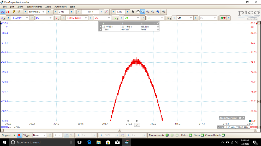

What is ignition timing supposed to be for a small 2 stroke like a weed eater or ice auger?

Thank you, and yes that's all true but I'm looking for the ignition timing spec. I am diagnosing a small engine and want to know if the flywheel has turned without having to take anything all apart.
  • EricGoodrich
  • EricGoodrich's Avatar Topic Author
8 years 10 months ago #16363 by EricGoodrich
Replied by EricGoodrich on topic 2 stroke weed eater ignition timing
From what I found, 8-12 degrees BTDC. I figured. Combustion is the same. Well, now we know.

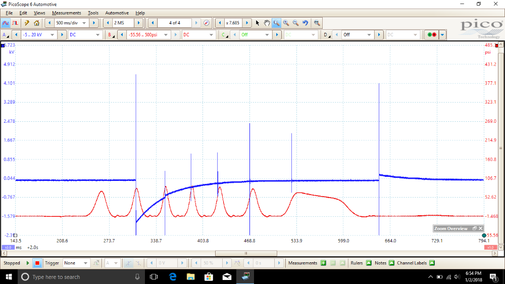

How does one check the timing on a weedwacker? Are we doing some fancy scoping (is that a word?) here? Pictures & video, please. Inquiring minds want to know.

Pressure transducer in the cylinder and capacitive pickup on the secondary ignition wire.
I'm suspecting based off a symptom that the flywheel has spun and I want to confirm it without taking anything apart.

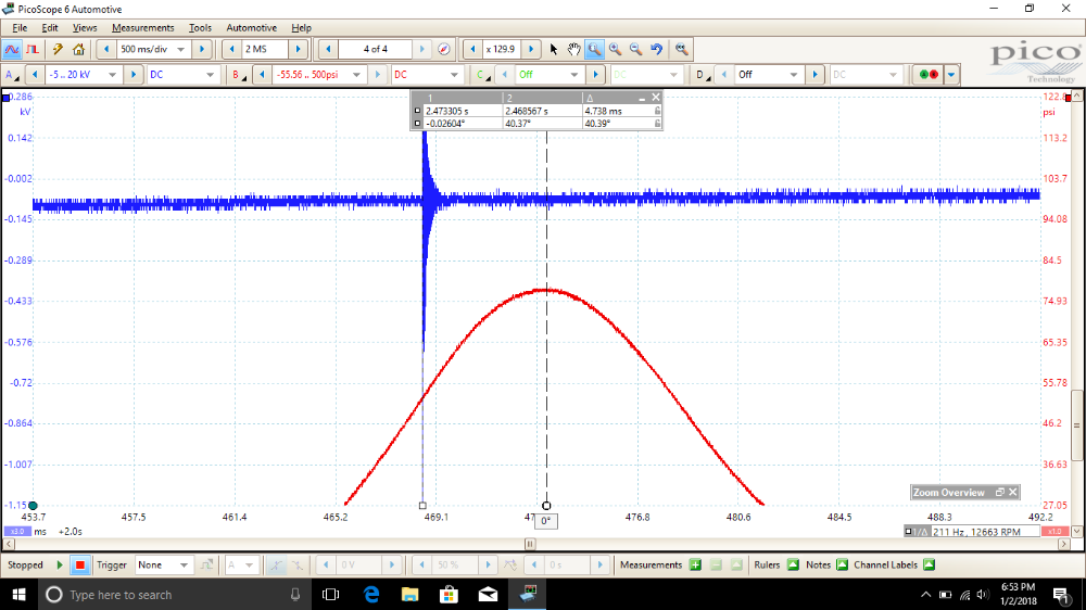

Faulty ignition module.
Timing starts at 8 degrees and gradually advances to 40 degrees. Key is in tact. Flywheel ok.

The engine tries to run backwards due to advanced ignition timing.
