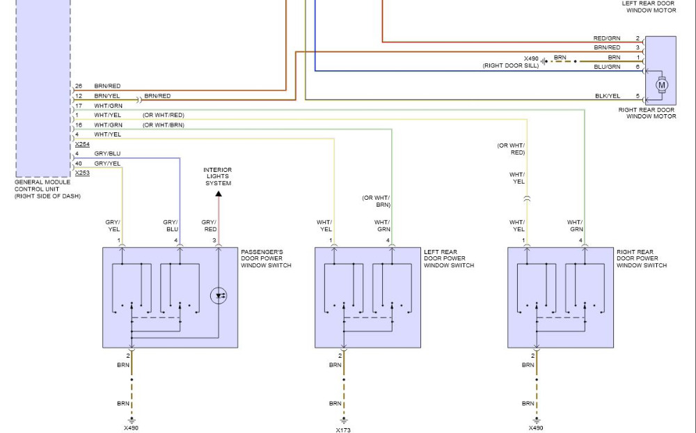

Hey what's going on guys. I'm new to this forum and been a member of the premium channel. But if anybody has suggestions for me or has done it before or resources I can go to to get better at reading wiring diagrams. I have 4 months of this engine diagnostics and honestly it's going pretty well at the shop. But the shop is very limited in resources as far as scope equipment or guys in the shop with knowledge. We have alldata but I see michell has better diagrams when Paul uses them. But this 04 bmw wiring diagrams for the window power switch is really tough to dissect with a bunch of wires it has on it and really nailing which wire to send 12 volts or ground it. Bosses don't understand that. They just say how can't u figure out how to put the window up. Mind u I'm the youngest guy in the shop and the guys with 30 or 40 years of experience can't figure it out either. It's just frustrating with the pressure and the lack of resource we have there and really no one to turn to as far as other techs because they are just parts changers and throw parts and after three parts thrown at it then the fourth one is the problem. And the bosses don't care because they see money coming in but it is biting them in the butt with all the comebacks these guys are having and then the boss throws it at me and expects me to figure it out. It's just really frustrating and I don't mind the challenge but if anybody knows of resources,books, training courses, or something i would greatly appreciate it. I'm studying everyday even when I come home from work. Paul is the best teacher I've had and really grateful to be part of his premium channel. Thank u guys. By the way I live in new jersey just in case if anybody knows anything in my area. And who knows maybe I can meet some of u guys if ur from around here and become good friends and help each other out when we have problems. Thank u and God bless all of u

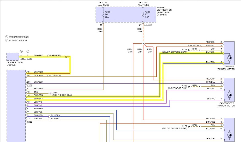

04 bmw x3. Driver door window doesn't go back up
8 years 8 months ago - 8 years 8 months ago #18218 by Chad
I'll see if I can find more on the Drivers Door Module.
As far as how to get better at reading wiring diagrams, just keep doing it. It's, really, not as confusing as it seems at first. Access to GOOD schematics is a must. I, highly, recommend a subscription to ShopKeyPro.com. If you are going to do this sort of thing, everyday, for a living, you need SOMETHING. I used to think that I couldn't afford the $169.00/month. Now, I KNOW I cannot afford NOT to have it.

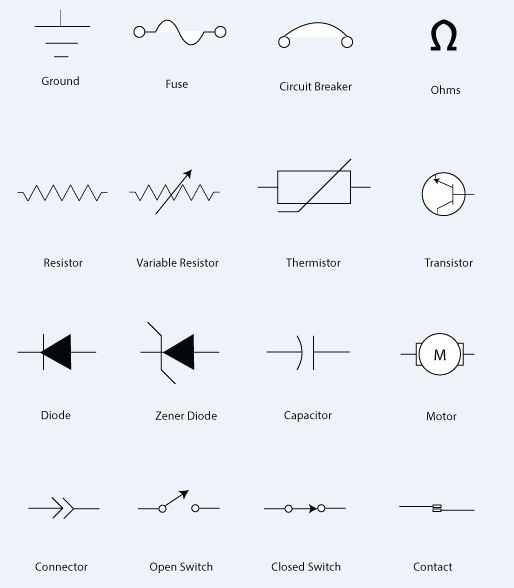

This might help you get started.
A quick google search find MANY more symbols.

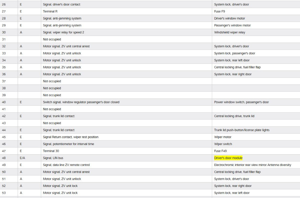

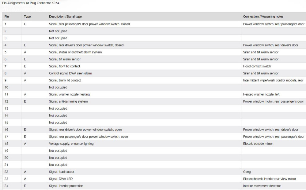

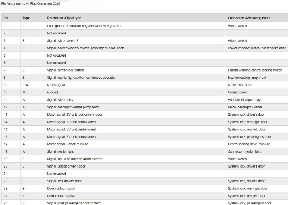

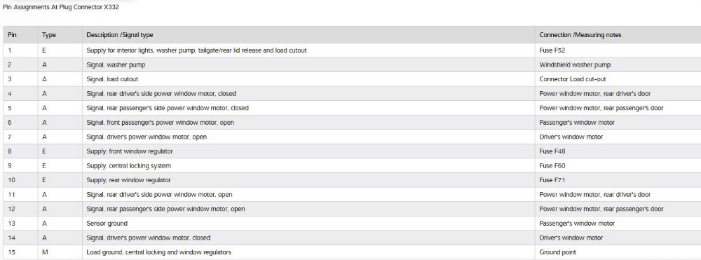

I'm not finding anything on the Driver's Door Module OR Connector X887. :dry: I think, that is what you are, really, after. :(

8 years 8 months ago #18221 by Jay2034
U don't know how grateful I am that u can look this up for me. The alldata wiring diagram looks nothing like this. I take it that this is from shopkeypro? My friend as I was looking at this bmw yesterday and I had no power going to the switch so then I had to go find the location of the fuse box and that 7.5 fuse was blown. I'm like great this window should work fine. But before I did that I said since I'm still here let me put the fuse in and verify it doesn't blow again. Because I know better that fuses just don't blow on their own and for no reason. So with my multimeter I checked on the fuse and no power going in for both ends. So I'm like no way. I pop the fuse out and gently checking both pins and one has 12.1 and the other has 1.2 volts in the fuse box. Now she has dealt with this issue and has taken it to this place she knows that whenever she by accident puts the window down this person can pull it back up. Now I don't know if this person grounded or shot 12 volts to the wrong wire and blew out the fuse and messed up the fuse box driver but definitely u can go straight to the motor once u know the system and shoot power to raise the window. So I showed the bosses this and to address this issue and that I would need more time but she couldn't wait and will bring it monday. How do u think I should attack this issue cause this will be a tough call the fuse box. And this doesn't look like a couple bolts hold this fuse box and boom it pops off. Lol. Freaking bmw makes things so complicated. Any advice my friend. Like I said in the beginning of my post I'll do my research and get to the root but if i need a second opinion this is where I stop and ask for advice. This is where I'm at with this my friend. If i had this diagram at my disposal yesterday it wouldn't look so difficult as a pose to the alldata. And this has colors too. Lol. I gotta talk to the bosses to switch to shopkeypro. Thanx again my friend God bless
8 years 8 months ago #18223 by Chad
Jay2034 wrote: Now she has dealt with this issue and has taken it to this place she knows that whenever she by accident puts the window down this person can pull it back up.
If you just need to get the window up, you can apply power to the BLK/GRN wire on pin 6 (at the motor, or pin 14 at the General Module Control Unit) and a ground to the BLU/GRY wire on pin 5 (at the motor, or pin 7 at the General Module Control Unit). This will either make the window go up or, make it try to go down farther. If the latter is true, Reverse power and ground.

I think alldata uses OE diagrams where Mitchell/shopkey redraw all their diagrams so that they are the same across all manufacturers but they leave out some details that may be needed sometimes.
8 years 8 months ago - 8 years 8 months ago #18225 by Chad
bruce.oliver wrote: I think alldata uses OE diagrams where Mitchell/shopkey redraw all their diagrams so that they are the same across all manufacturers but they leave out some details that may be needed sometimes.
That is true. AllData's selling point is that their schematics are UN-altered Manufacturer schematics. Mitchell's are MUCH easier to use. The colored lines. Highlighting circuits. With a Click, you can make all circuits that are not relevant to your diagnosis disappear. Making it MUCH easier to follow. And, the way Mitchell indexes their schematics, it makes it A LOT easier to find what you're looking for, IMO. All that is a plus. BUT, as bruce.oliver stated, sometimes, they not only leave out some details but, they are WRONG. Not a lot. But there ARE instances.

Thank u once again guys. So what bout the fuse 7.5 that inside the box that only has power on one pin and the other has 1.2 volts. How can I attack that. But yeah pole thank u again take care my friend
