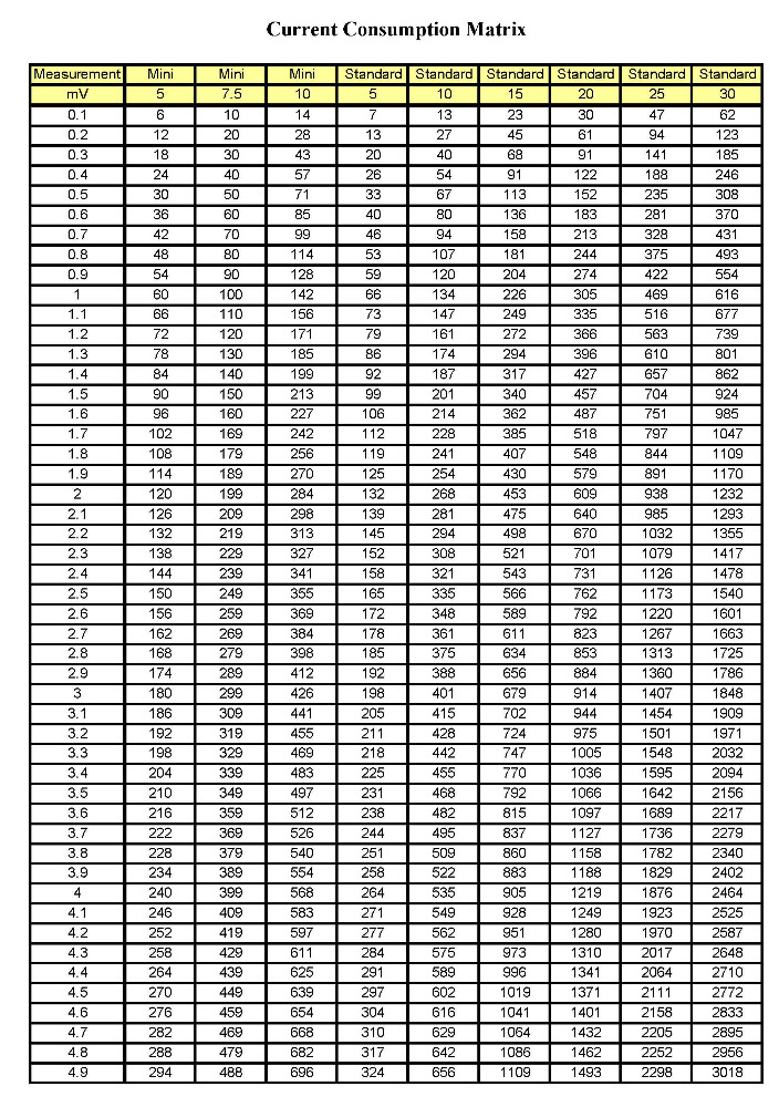

8 years 8 months ago - 8 years 8 months ago #18263 by Chad
This is a handy chart that will convert the milli-volt reading you get, into a Mill-amp value for the different fuse types.
You can operate the windows and watch the amperage.
Last edit: 8 years 8 months ago by Chad.

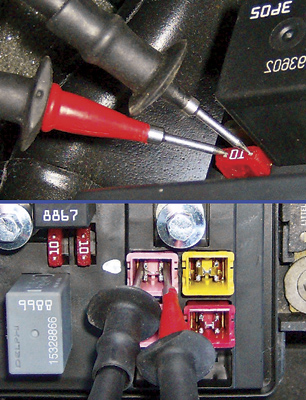

8 years 8 months ago #18268 by Chad
Just to make sure we are on the same page, when you say:
Because with the fuse in and I touched the pins there were 0 volts on each pins with it in
Do you have the negative test lead touching a ground? (you should read 12v on both test points) Or, are you measuring like this:
If you are reading 0 volts, measuring like the picture, this means you have 0 voltage drop...no current flow.
If you are measuring like the picture and get a reading, other than zero, this is a voltage drop across the fuse. This indicates current flow. Compare this reading to the chart.
