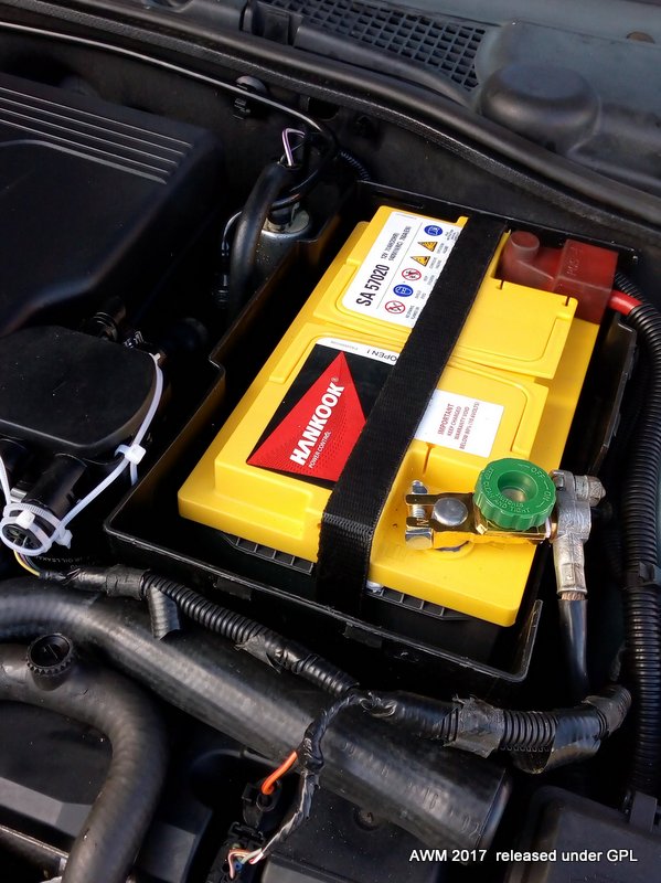

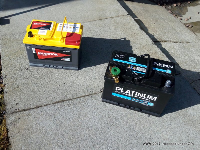

I bit the bullet and bought a Hankook AGM battery the old battery passed every test with old school and high tech tester but even disconnected from the car it dropped 0.2v per day.

Impressive zip-tie skills!
8 years 7 months ago #18758
No joke! :lol: Also Hankook makes batteries? Probably not the same as the tire company...
Replied by Tyler on topic AGM battery retro fit --- worthwhile
Noah wrote: Impressive zip-tie skills!
