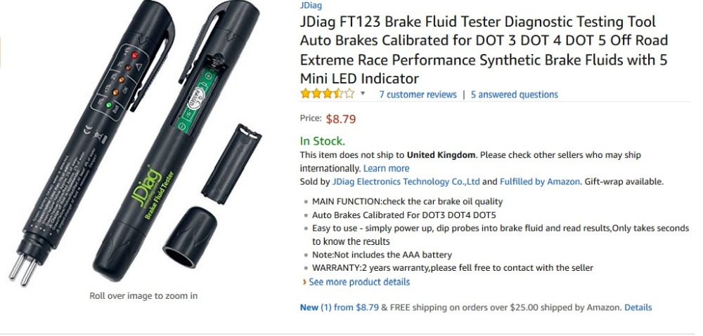

8 years 6 months ago #20304 by Andy.MacFadyen
Replied by Andy.MacFadyen on topic Acceptable brake fluid flush technique?
Simple low cost pen style device that estimates moisture content by conductivity
8 years 6 months ago #20306 by bruce.oliver
Replied by bruce.oliver on topic Acceptable brake fluid flush technique?
Andy.MacFadyen wrote: Simple low cost pen style device that estimates moisture content by conductivity
How well does that work? The way I understand it, moisture isn't the most important check. Copper content causes corrosion in the system, so testing for copper is most important. Or so they say

I've always heard the same? I know the test strip is the only method accepted by MAP standards, anyway. I honestly think they both have merit? Like battery conductance testers and carbon piles.
  • Tutti57
  • Tutti57's Avatar Topic Author
8 years 5 months ago #20505 by Tutti57
Replied by Tutti57 on topic Re:Acceptable brake fluid flush technique?
I have one of the motive pressure bleeders but haven't bought the right adapter for the applications I would use it on yet. I'm waiting for someone to grab a cap from work to make something out of it.
I had one of those pen style fluid testers but it broke on me a couple of days ago. It seemed accurate, jusginf by results from new fluid, to 20k, to high mileage. I only paid like $10 for it, but it was brittle as hell. I just took the cap off the other day and the tool come off in the cap. Maybe I don't clean the fluid off well last time I put it away and it ate it up?
