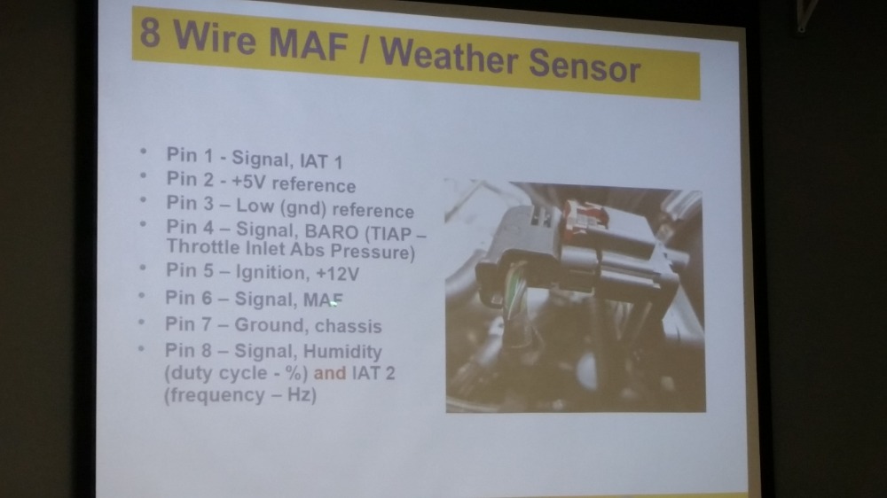

graywave wrote: Just got back from a GM Technology Class tonight

Yes. Honestly all these classes I go to are worth going to. Some information I may have picked up in another class but I always learn something new. They hand out a book with most or all the information they go over.
For instance....I was looking all over the place for information on GM's 8 wire mass air flow sensors but gave up a while ago...They went over those in the class and what each wire was for.

graywave wrote: For instance....I was looking all over the place for information on GM's 8 wire mass air flow sensors but gave up a while ago...They went over those in the class and what each wire was for.
It's a pretty cool sensor. B) The humidity/IAT2 circuit is especially interesting, varying the frequency and duty cycle to generate two signals on one circuit.
I first learned about that sensor a couple years ago at a BWD class. Whoever wrote the material wanted to see how much weight the humidity and IAT2 had for fuel trims, and used a dedicated signal generator in place of the sensor to find out. Turns out, very little. :lol: They cranked the humidity signal back and forth as far as possible, and only changed fuel trim a few points.
Still, seems like something we'd do. :silly:

7 years 11 months ago #23379 by graywave
Ya I need to grab some known goods of this sensor. To bad I don't have a 8 channel quality scope. lol
