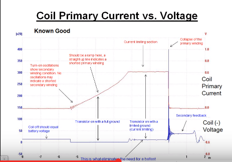

Have the link to the article or was it on paper?
Also check out latest video on SD Premium if you haven't. ScannerDanner explains the basics in his classroom with this case study:
