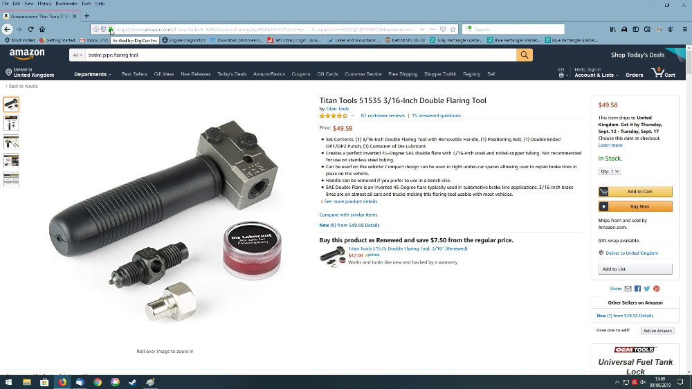

On Car Brake Pipe Flairing Tools
For years I used a puka Sykes-Picavant bench tool for making brake pipes it produced beautiful results but more an more engine bays offering poorer access I found I was having to splice in new sections of brake pipe working on car. This was the answer it produces very nice flares on both steel Bundy and Kunifer pipe and is easy and quick to use in confined spaces. Mine was UK made and branded "Power Hand" but it is available under different brands on eBay and Amazon DIN and SAE are separate tools other versions are also sold for other larger pipe sizes.

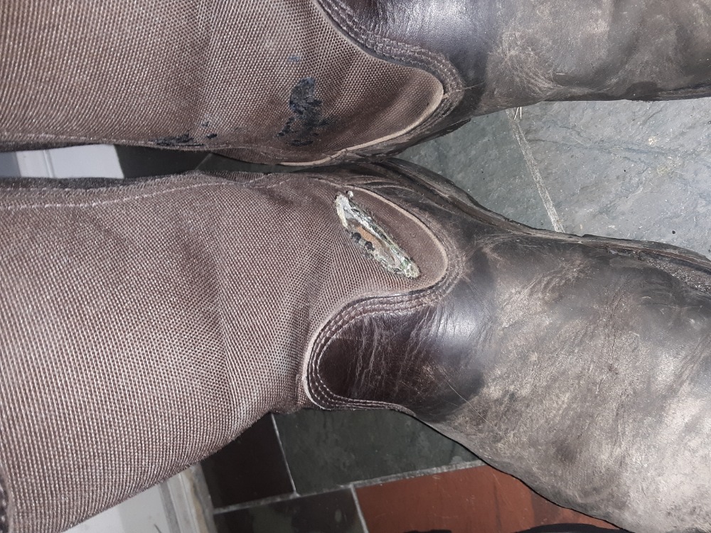

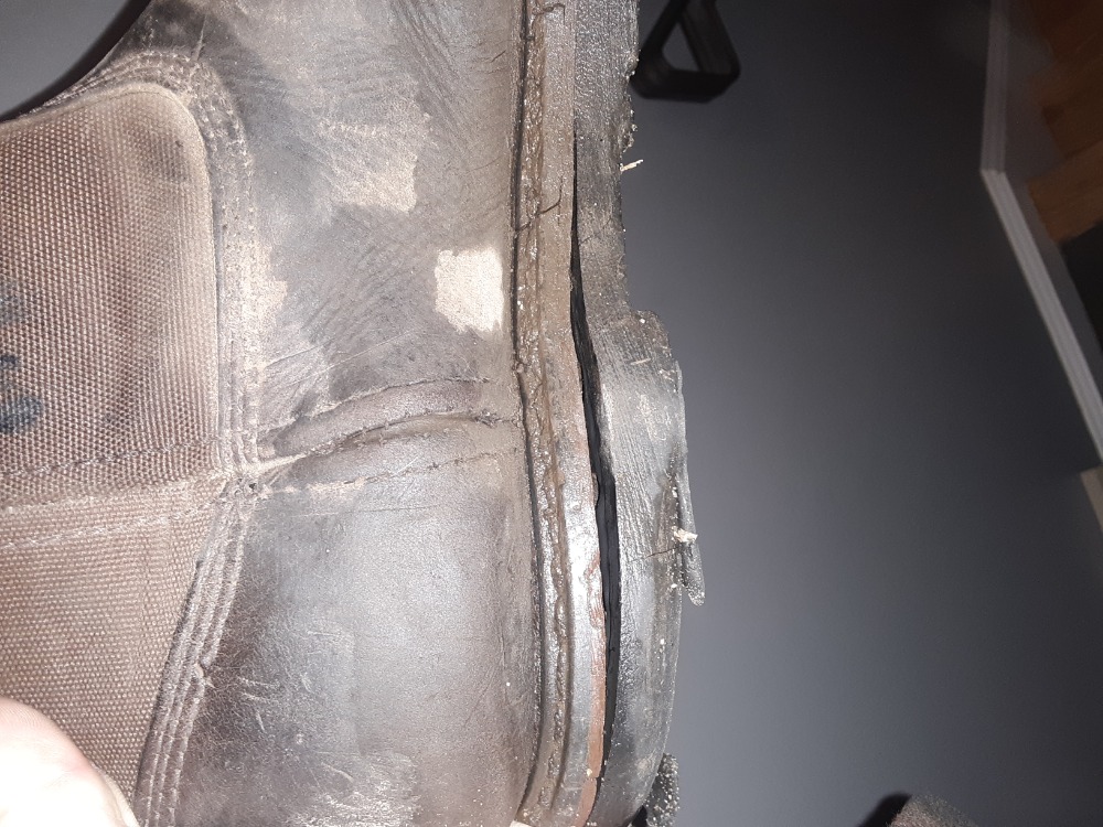

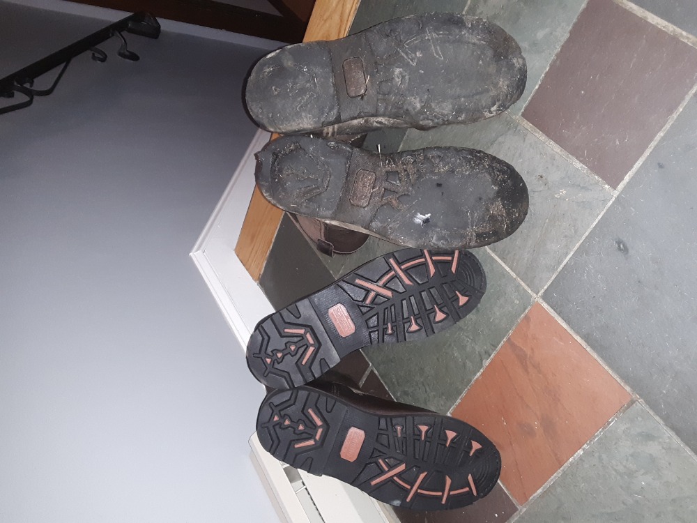

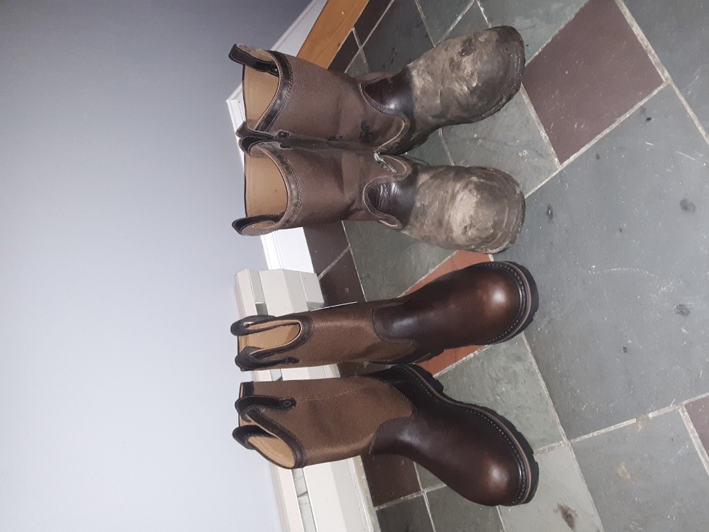

So I absolutely destroy boots. It's a junk yard thing. Not uncommon to go through 3 pairs a year. And for me, wet feet are a deal breaker. So I've been buying a Wellington style boot for years now and I'm retiring my current pair after 3 years.
With burn holes, separating soles and blown out seams I can still walk through 6 inches of water without getting my socks wet!
They're not terribly fashionable, but after destroying every boot on the market, I highly recommend this style boot for anyone who works outside or spends any amount of time in the mud, snow or rain.
I wear them year round.
I'm including before and after pictures since my wife just got me a new pair for my birthday tomorrow :)

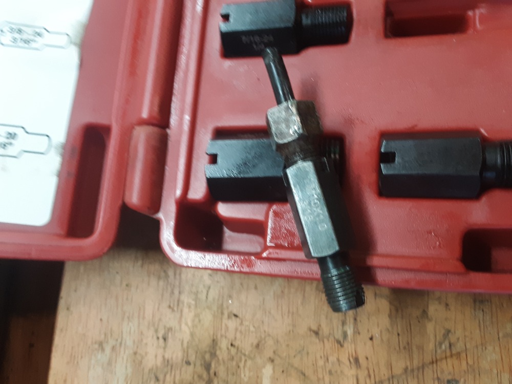

Brake line fitting thread repair kit. Not mine, but I borrowed it and it saved my bacon. Now I need one of my own.
Each tool will work on the male or female side of things.
Especially helpful when that first thread is just a little mucked up and you just can't get the line started.

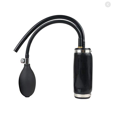

This Phoenix Systems reverse bleeder has also been a gamechanger:
www.amazon.com/gp/product/B00GRV800S/
Twice now it's paid for itself in time saved bleeding clutches. First use was after manual bleeding didn't work out. Second time, we didn't even bother manual bleeding and just went straight for this tool. Five minutes and the job was done.

Oh I want one of those thread repair kits, must be really useful for SAE fittings which can be a pita, DIN tend to be easier

Two great tools I really should get the easy intake it would be great for checking turbo hoses.
I like the brake bleeder -- I have pump up top down bleeder great time saver for major brake jobs but overkill for clutches also a lot of clutch resevoirs on european cars are now mounted inside the car above the pedals.

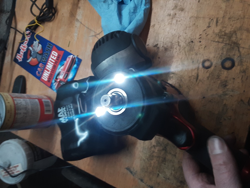

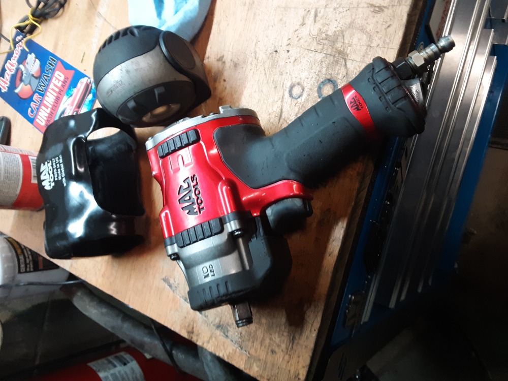

Just scored a great deal on the big boy Mac tools impact gun :)
HIGH PERFORMANCE 1/2” DRIVE AIR IMPACT WRENCH
MPF990501
Two guys at my shop each bought one from the Mac man for over $500 (with tax and such) within the last year.
www.mactools.com/en-us/Power-Tools/Air-D...ve-Air-Impact-Wrench
My Snap-On rep shows up today and asks if I have any interest in the same Mac gun,(he took on trade for a cordless rig), for $100!
I said yes right away, then asked if he had any interest in taking my Snap-On gun in trade. Been collecting dust for over 2 years now anyway.
He gave me $50 for my old Snappy and I walked off the truck with a $500+ impact gun for $50.
