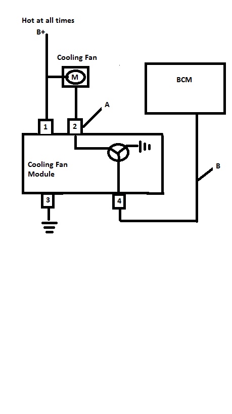

Earlier this month I took my A6 (Electrical) recertification test. This one question has been stuck in my head for the past couple of weeks and I wanted to get some other opinions on how you would have answered this. So here is the question and a couple of options for answers that were available (it was a multiple choice, 2 of them were obviously incorrect)
After charging a vehicles battery a Technician notices the electric cooling fan runs constantly. What is the most likely cause.
A: A short to ground at point A
B: A short to power at point B
9 years 10 months ago #4440 by Tyler
Replied by Tyler on topic ASE Test question
Yeah, I see why this one would stick with you... OK, I'll take a shot.
A short to ground a point A is definitely possible, but why would it happen after changing the battery?
A short to power at point B would also cause the fan to run constantly, but why would that be any more likely than answer A? :huh:
Where's answer C? Where the BCM got 'logic locked' by the low battery voltage? That's WAY more likely than A or B, IMO.

Tyler wrote: Yeah, I see why this one would stick with you... OK, I'll take a shot.
It was after charging the battery
I can't remember off the top of my head exactly what the other 2 choices were but they could be eliminated easily. (opens) All the choices had to do with reading the wiring diagram.

I'm saying A. My reasoning being the battery was discharged because the fan was running continuously. Presumably with the key off, that takes the BCM out of the picture for me.

Noah wrote: I'm saying A. My reasoning being the battery was discharged because the fan was running continuously. Presumably with the key off, that takes the BCM out of the picture for me.
I agree with Noah unless the BCM has an after run program designed into the fan :unsure:

Never mind. A short to power at point B is after the BCM so it doesn't matter what the BCM is doing.
Sorry Noah, I no longer agree :P
They are both good answers, not sure how you would pick the best one.

ScannerDanner wrote: Never mind. A short to power at point B is after the BCM so it doesn't matter what the BCM is doing.
Ahhh yes, good point.
I suppose it comes down to the internal construction of the fan module. More specifically, the transistor. You would think it's ground is constant, considering the module has constant power and ground.

I would say B. because it is a fan Module. If the battery was low the model might not turn the fan on if B was grounded. If A was grounded the fan would run until it drained the battery down to almost 0v's.

My first instinct a a hammer and spanner guy was A but I was unsure so I revised my transistor theory and I am now more sure it is A.
Link to www.technologystudent.com/
However I can think of other reasons why the fan should run continuosly.
