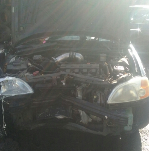

Let's play a game, shall we?
I've got an eye for car parts. I'm the guy who can look at heap of sub frames and point out the 02 Camry left front lower control arm you need, or Chevy Impala front sway bar.
I noticed something funny about this 01 Civic today and asked my co workers if they noticed anything off.
Yes, it's crashed, but something is not quite right about this one.
Can you spot it?
9 years 9 months ago #4701 by Noah
And it's not the "cold" air intake or aftermarket header

:unsure: Dunno , straining eyes here..lol

The Radiator looks like its too small for the YMM.

Nailed it!
That's a 96-00 civic radiator.
The 2001 has a radiator that is the length of the radiator support which the a/c condenser stacks in front of.
The 96 to 2000 civic has a small radiator and small a/c condenser that sit next to each other.
Whoever MacGyvered that bad boy in there didn't have a solution for the A/C, which was just left un hooked.
It must have worked, because they sure didn't wreck it that bad parking it in the driveway for the night!

I thought it was strange that I could see the alternator with the radiator still installed...

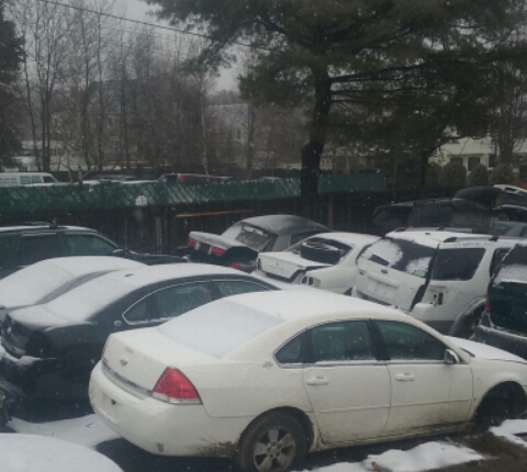

Alright, here's an easy one

Easy one heuh.... :ohmy: Think I'll use the excuse of being European :P

Nevermind, that pic didn't come out as clearly as I thought it did. I'll see if I have one with a little more definition.... :blush:

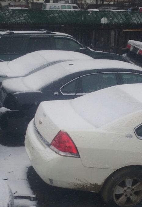

Ummmm, the taillight is missing from the black Impala? :huh:

Negative. :P

I apologize, this may be more difficult to people without exposure to the US car market!

I Just happen to replace a Radiator in one a couple of weeks ago, I remember it because I had to straighten the metal bumper with a torch and a large pry bar to get it to fit.

The white car is missing a lug nut!!

Lol! It's probably missing more than that! But no, that's not it
Nothing missing out of the ordinary on either car.

Sooooo, it's nothing to do with the Impalas? :huh:
I'm gonna feel silly when someone figures it out!

I never said that :P
But the game isn't about what's missing, it's about what's different. :whistle:
