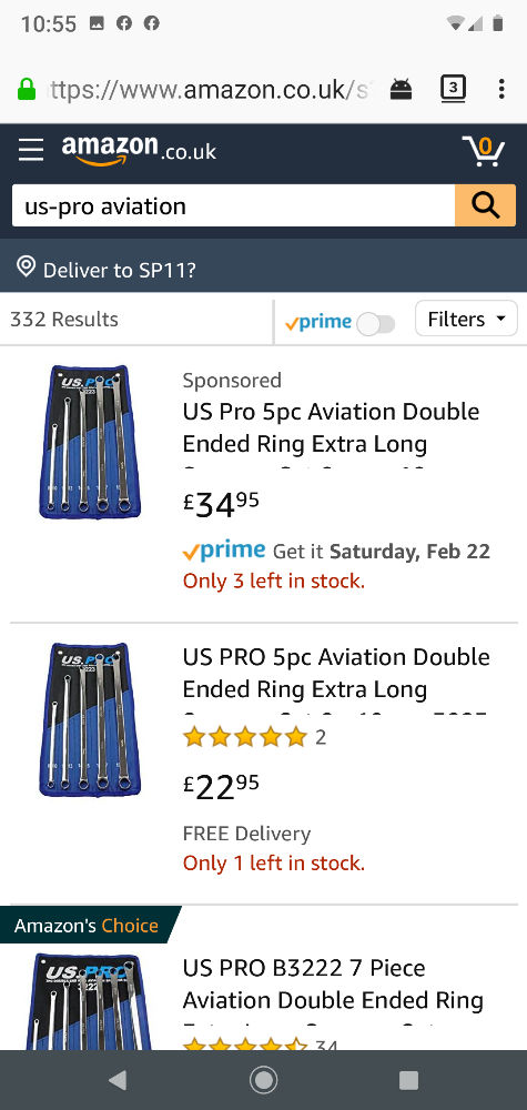

6 years 8 months ago #37671 by Andy.MacFadyen
Replied by Andy.MacFadyen on topic Re:When to use impacts vs hand tools
Yup spanners are made the correct length to suit the required tighten torque for. The bolt size.
But must confess I now have a set of US-Pro extra long aviation wrenches that now have become my tool of choice for a lot of jobs.
