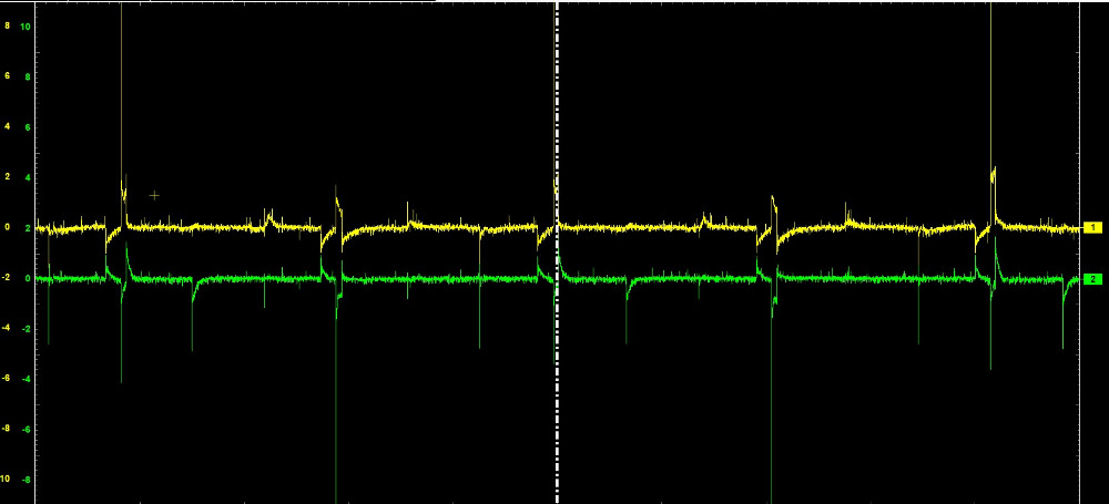

Meanwhile, we're trying out our new Wynn's decarbon service on a '16 Hyundai Sonata. 100K+ miles, never been cleaned. Complaint of a roughness when cold. Here's what the Cody's sensor has to say about the intake pulls:
Will repeat the test when we're done with the service. B)

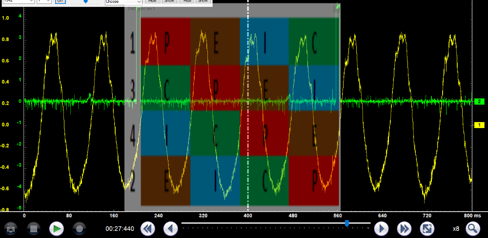

6 years 7 months ago - 6 years 7 months ago #38714 by Chad
Since you asked, Tyler, I have a question about waste spark systems. Firing Kv is always higher on the compression stroke, than it is on the companion/exhaust stroke. This is understood to be caused by higher compression vs. lower compression...(higher compression = greater resistance = higher firing Kv demand). I understand that principle. It is, also, understood that Firing Kv is the voltage that is required to overcome ALL air gaps, (two spark plugs, one under compression, one not). Since the coil only fires once for two spark plugs, overcoming ALL air gaps/resistance, I don't understand how the lower compression on the companion cylinder measures less Firing Kv than the compression cylinder. I know the answer is "Because one cylinder is under compression and the companion cylinder is not". I just don't understand "how". Total secondary resistance would be the same, wouldn't it?
Just thought I'd throw this out there for discussion because I have always struggled to understand this (and still do).
As I'm typing this, I'm thinking of a circuit with two resistors in series (resistors are sparkplug gaps). Applying the voltage drop principle, I can understand how voltage could drop passed the "Compression Air Gap" and still have enough energy to jump the "Non-compression Air Gap". But, how could the coil release "X" amount of voltage to jump the "Non-compression Air Gap", then step voltage UP to jump the "Compression Air Gap"?

Dylan wrote: We use a granulate to clean the intake on GDI's. Works pretty good. Not the most fun thing to do but hey if it works. But I'm curious about the Wynn's decarbon service.
It doesn't really seem to have done much? Other than make smoke. :silly: I'll post the before and after borescope pictures we took. I retook intake waveform as well.
In general, I haven't been impressed with chemical solutions to heavy carbon deposits. As a maintenance item, maybe, done on a regular schedule. IMO, the granulate you use (or just manual cleaning) is the only real solution. :(

6 years 7 months ago #38717 by Chad
Tyler wrote: I'm trying to think if we have any waste spark cars at the shop to experiment with
I'm not sure if I have one in the shop, right now, either. Now, I am thinking about capturing Secondary Ignition, from both the compression cylinder and the companion cylinder, simultaneously, on the same coil fire, with two separate ignition probes. I can't believe I haven't done this, before. :ohmy: I wonder if a time delay between cylinders could be seen? :huh:

6 years 7 months ago #38720 by Tyler
I just remember we have an old Taurus here. :ohmy: I'll see what waveforms I can get out of it. I like the two ignition probes idea.
