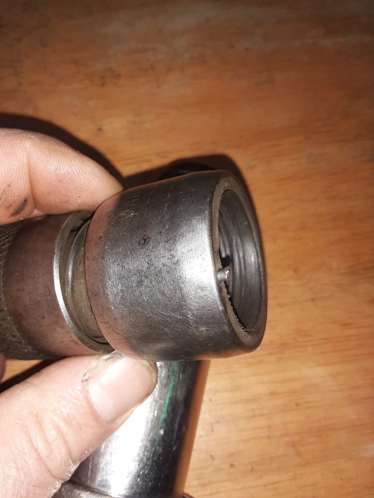

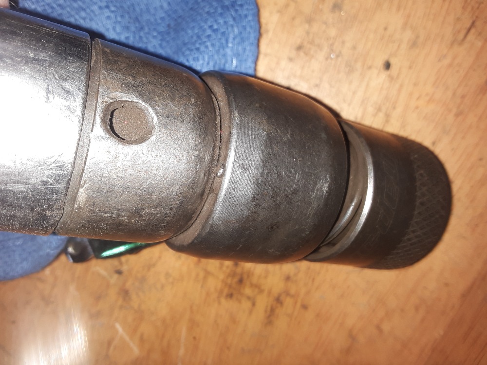

6 years 6 months ago - 6 years 6 months ago #39571 by Noah
Chuck free spin if from a stupid roll pin.
Now that I changed it I make sure it doesn't fall out again. I'll send you a picture. I didn't even know it was missing until my Snap-On rep smartened me up.
The grip on mine is held on with black RTV silicone. Good stuff
Last edit: 6 years 6 months ago by Noah.
6 years 6 months ago #39638 by Noah
This roll pin is what stops the chuck from free spinning.
