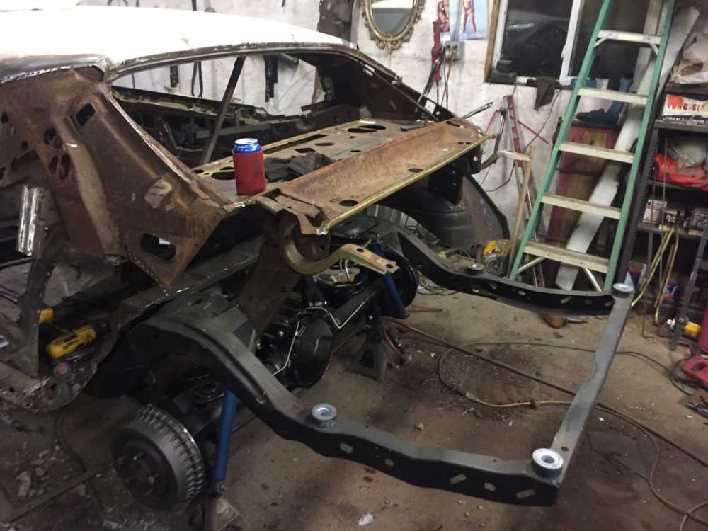

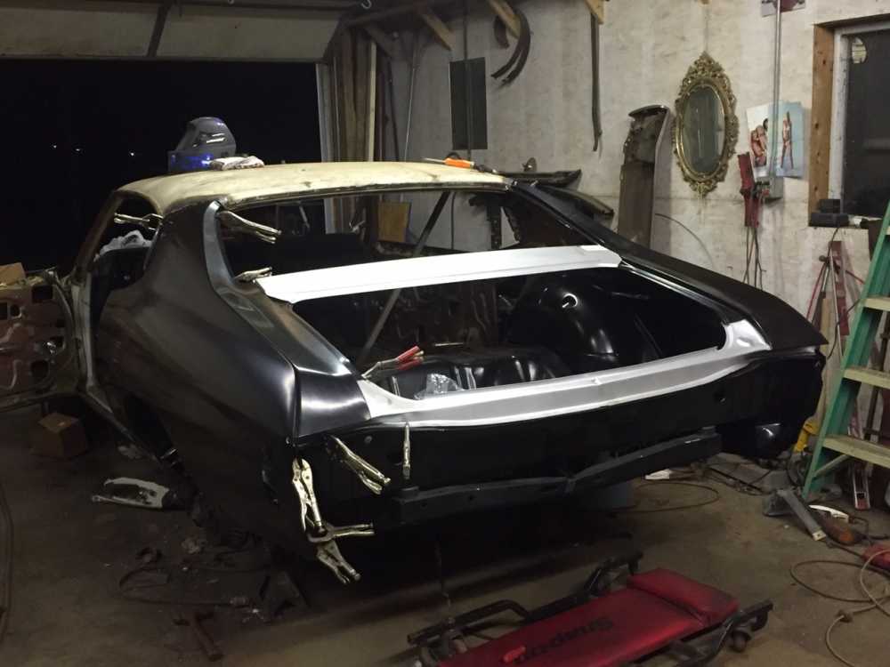

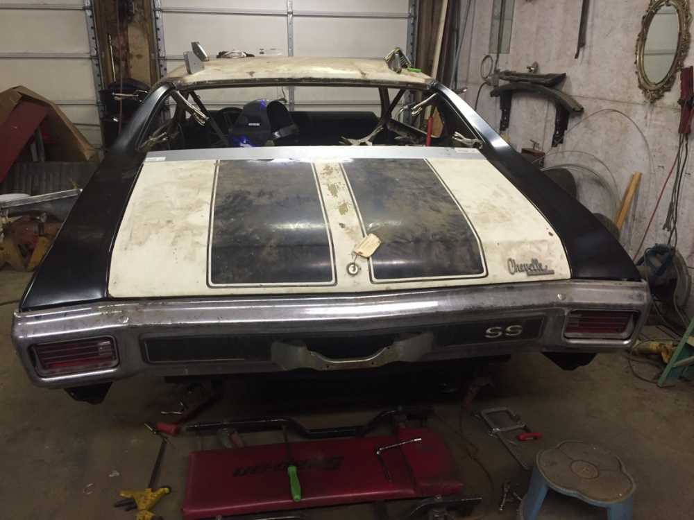

My dream ride. 1970 Chevelle SS. It really is a true SS, I have the build sheet. I've had this car for 17 years. Been collecting parts for 15 of them. Started the overhaul in March 2016. It'll probably be a couple more years to get it done as I am doing it all myself. Funds are less than plentiful these days.
Looking forward to seeing others rides too.

Removing the cancer
New panels being fitted
Testing the trunk lid and bumper fitment before welding the quarters on.
10 years 9 hours ago #1687 by Noah
Replied by Noah on topic Readers Rides
Man, what a cool car! A real American icon.
Frame looks real solid too. I'll be waiting to see where this project heads for sure, thanks for sharing.

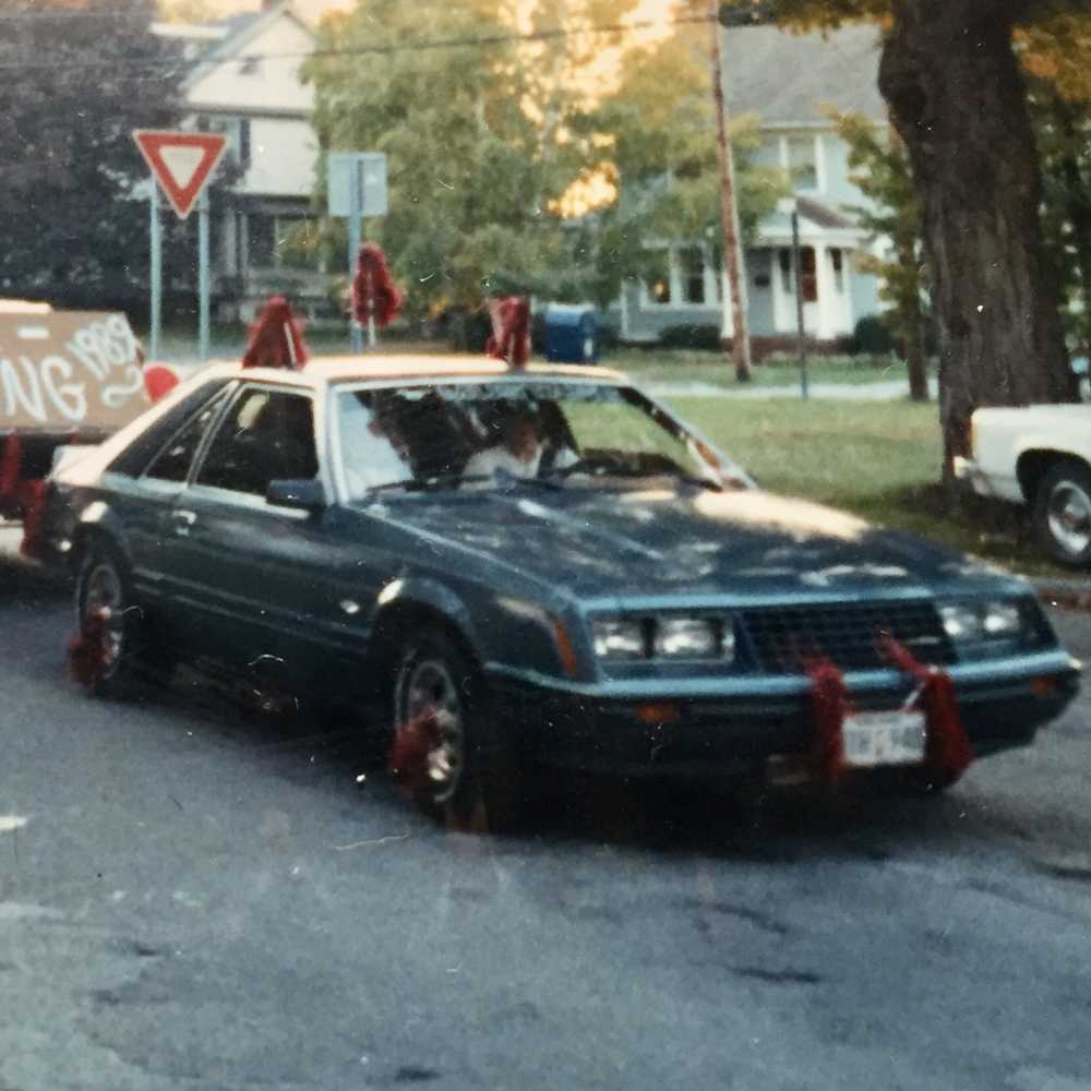

9 years 11 months ago #2189 by jconiber
Replied by jconiber on topic Readers Rides
Hey Noah,
Here is my 1979 Mustang. I bought it when I was 14. It started life as a 4 cylinder with heavy duty radiator and stabilizer bar. I went through it mechanically and my mother drove it until just before I turned 16. That's when I painted it and added the aluminum wheels and white letter tires. The four banger had a problem with blowing the oil filters off on cold starts so it went to the curb. I rebuilt my very first engine to put in. It was a 289 v-8 from a 1965 Mercury Comet. I messed up by rolling the engine over without the timing chain correctly installed and bent three exhaust valves. It skipped a little when it started. Lol, I wasn't happy. The installation was rather easy after I did some junkyard scrounging to compare parts from other Fords. I used the oil pan from a 1984 T-bird, hoses for a Mustang and exhaust manifolds and crossover from a Fairmont with a v-8. The damn crossover bolted right up to the Mustang 4-cylinder converter. Talk about quiet. I used the 3 speed out of the Comet but the clutch pushed so hard your leg would start to shake at a stop light. Eventually went with a C-4. Foolishly, I sold the car when I went to tech school.
9 years 11 months ago - 9 years 11 months ago #2216 by Noah
Nice looking 4 eye fox! Such a versatile platform, everything just fits! And from underneath, they're virtually unchanged from '79 - '04. I think all those old cable clutch systems are notoriously hard.

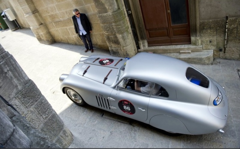

9 years 9 months ago #3882 by Andy.MacFadyen
Replied by Andy.MacFadyen on topic Readers Rides
Not my ride (I wish) just a fabulous picture
I found on the Mille Miglia web site
9 years 9 months ago #3892 by matt.white
Replied by matt.white on topic Readers Rides
What is it Andy?
9 years 9 months ago #3896 by Andy.MacFadyen
I had to look it up it is an 1938 Alfa 1750 with a body by Touring of Milan -- a lot of Italian car companies in the run up to WW2 were building some fantastic shaped cars.
