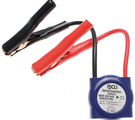

In case of an AGM battery and cars with start/stop system you'll have to perform a relearn. There's an IBS (Intelligent battery sensor)
But you can always use one of these then:

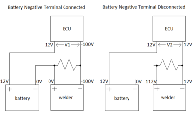

I found this article so I'll post it here:
"Sharing a very good article which I’d come across browsing recently while preparing to undertake the DG platform welding/ strengthening work, it gives the ideal explanation for the need of disconnecting the Batteries of the machinery to safeguard its Engine control unit & other electronics; I’ve compressed/ modified the article slightly to accommodate it here, hope it does helps anyone reading it.
#Speculation runs rife regarding whether the negative terminal of a vehicle’s battery should be disconnected before welding on that vehicle. The reasoning is that it helps to prevent damage to the vehicle’s ECU and other electronics. Many people believe the negative terminal should be disconnected but cannot explain why it should be done. Other people believe disconnecting the battery terminal has no impact on the ECU since the ECU is still connected on both terminals and the affect of disconnecting the battery only isolates the battery and nothing else. They believe the idea to disconnect is simply an old wives’ tale with no valid reasons to substantiate it. So who is right?
Electrical Principles- To help explain what’s happening we need to understand a couple of principles: Ohm’s Law and Kirchhoff’s Circuit Laws. I’m going to explain them very simply as they relate to this problem.
Ohm’s Law: This is usually presented as the formula V= iR where V is voltage, i is current and R is resistance. It tells us that voltage is required for current to flow. If there is current flowing through a conductor then there must be a voltage across that conductor.
Kirchhoff’s Circuit Laws: This law states that the sum of the voltages around a continuous electrical loop must be zero and the sum of the currents into and out of an electrical node is zero. Regardless of the current flowing, regardless of parallel or alternative loops, the voltages around every unique loop must sum to zero and the currents through each node must sum to zero.
Welding Circuit- Below is a circuit diagram that depicts welding a vehicle. On the left is welding with the negative battery terminal connected and on the right is welding with the negative battery terminal disconnected. The resistor represents the car body. Assuming that the car battery voltage is 12V and the welder voltage is 100V. The actual voltages are irrelevant, the point is to see whether welding could damage the ECU and whether disconnecting the negative battery terminal would reduce that risk. All voltages are measured with respect to the battery’s negative terminal. The box labeled “ECU” is the engine control unit, the device that is to be protected.
V1 is the voltage across the ECU with the negative battery terminal connected whilst welding. V2 is the voltage across the ECU with the negative battery terminal disconnected whilst welding. Kirchhoff’s laws and Ohm’s laws resolve the voltage at each point. The left side has a closed loop through the ECU where Kirchhoff’s voltage law easily verifies the voltage across the ECU. The right side has an open loop where Kirchhoff’s current law dictates that no current flows through the ECU and Ohm’s law determines that the voltage across the ECU is zero. Similarly Ohm’s law could be used in isolation with the open circuit interpreted as an infinite resistance.
So from the diagram we see that: V1 = 112V & V2 = 0V
It’s seen that in the left circuit the ECU is suffering from over-voltage and could be damaged. It is designed for 12V yet has 112V across it. The right circuit, with the negative battery terminal disconnected, there is no voltage across the ECU and therefore it does not experience any over-voltage.
The ECU damage is most likely when first striking the arc and not during steady DC current flow. When you first strike the welder it yields a step function which would generate a reaction different to what the steady state DC resistance would predict. A step function is made up of many high frequency components. Not only are there many high frequencies present, but the voltage would be high when first striking the arc. Before welding starts the voltage floats up to the open circuit voltage which is typically between 30 to 100V. When first striking the arc the full open circuit voltage is applied between the welding rod and the earth clamp.
One might argue that adequate earthing will maintain the body at zero potential throughout. Ohm’s law tells us that if current is flowing there must be voltage regardless of your earthing. Further, earthing does not control the resistance through the body and thus does not necessarily prevent potentially large voltage drops.
From this evaluation it is confirmed that welding a vehicle/ DG platform does risk damage to the ECU and disconnecting the battery’s negative terminal will mitigate that risk.
Why Does This Happen?- The problem lies with the ECU and the welder sharing a single conductor – the vehicle’s body. For the welder to push current through the body, it must impose a voltage across it regardless of how good your earthing is (Ohm’s law). With the battery connected there is a closed electrical loop where the voltage across the vehicle’s body could add to the battery’s voltage and cause an over-voltage condition at the ECU. With the battery’s negative terminal disconnected, the loop is broken, both terminals of the ECU will float to the same voltage and no over-voltage will occur regardless of the voltage across the vehicle’s body."

Great topic . I disagree with that article and will explain later. As a side note I am a leave the battery connected welder...

Ben wrote: Great topic . I disagree with that article and will explain later. As a side note I am a leave the battery connected welder...
Cool I like people who disagree :) Interested in what you think about it.
