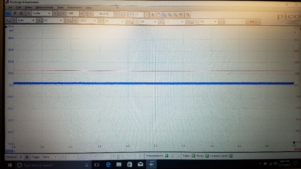

Did some exhaust welding today. Standard MIG welder. Battery connected. Blue channel is an inductive amp clamp around the battery cable. Red channel is voltage across the battery terminals.
The three second Mark is when I began welding. The seven second Mark is when I stopped.
I apologize for not providing pictures of waveform zoomed in, honestly there was nothing to see anyway.

YES. This is exactly what I've been meaning to do! B) Many thanks sir, much appreciated.
