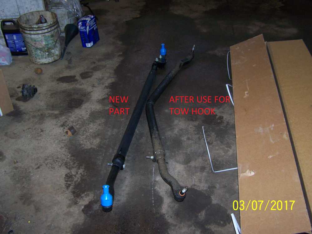

I have sen a lot of things come through the shop that just make you shake your head and say why. i had a 2015 Ram that got stuck on a job site and the customers guy's towed it out but the choice of where to attach tow chain was not good.

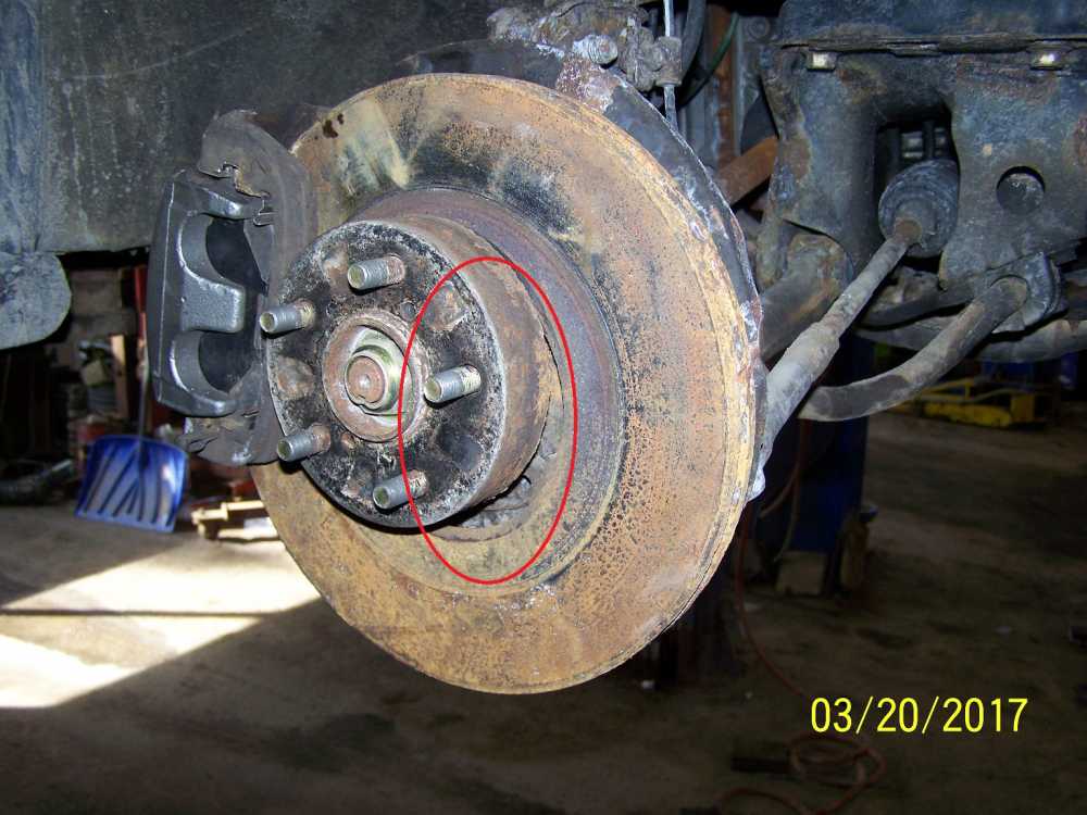

Then had a Guy came and said his buddy had helped him do his brakes and they did not feel right after here is why. I advised him to maybe find another Buddy next time to assist him L.O.L.

Seen both of these disasters -- I have seen two examples of the panhard rods on Mk1 & Mk2 Fiesta well bent due to puting a tow rope in the wrong place.

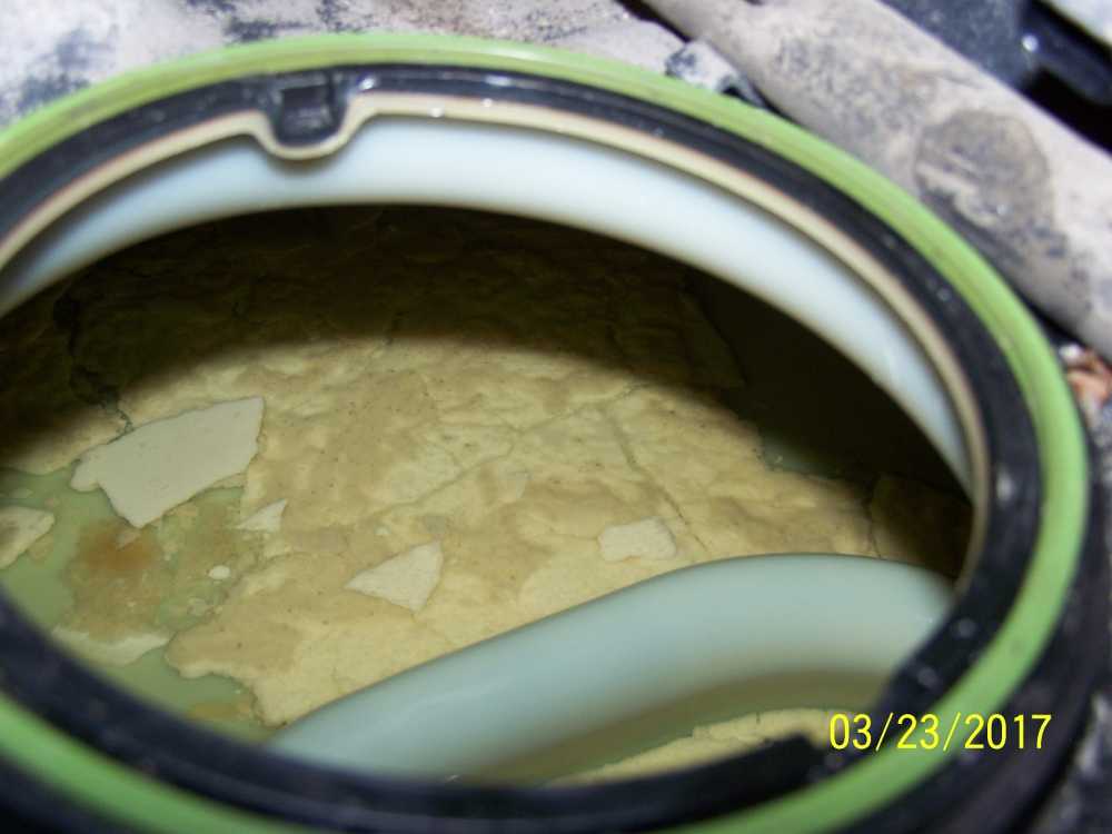

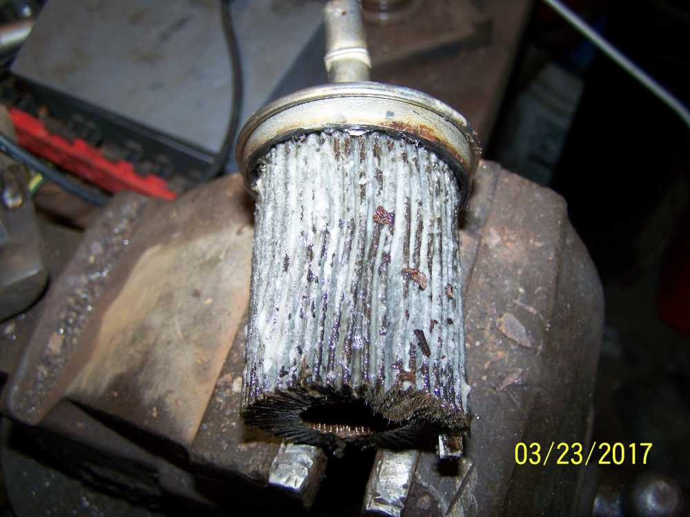

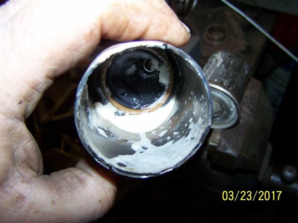

Andy have you ever seen this one had this one come in for no start I guess some one was mad at my customer this is sugar in the tank and the filter

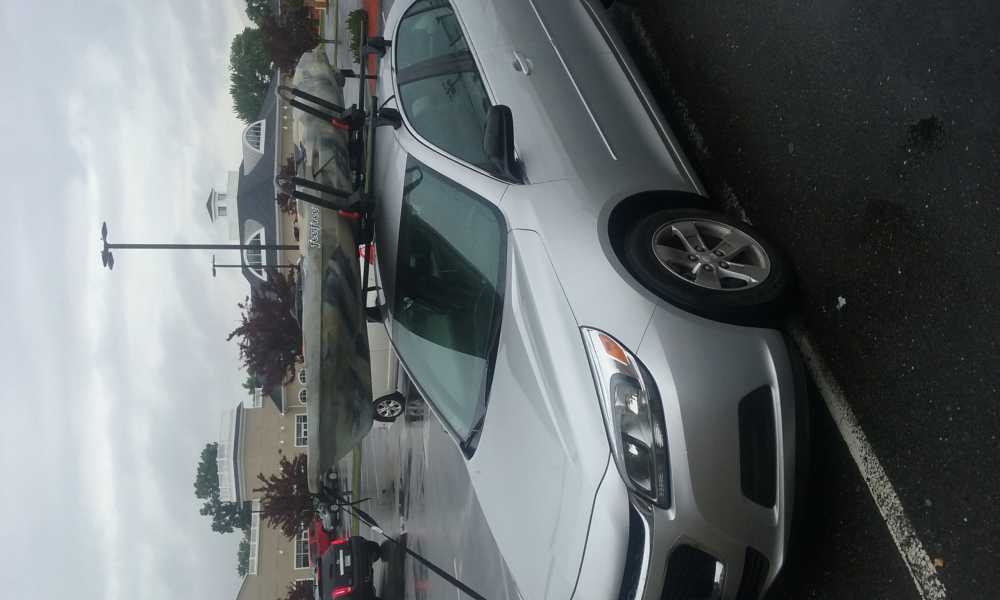

Not my picture, but I have had vehicles towed in like this:
9 years 7 months ago #7817 by Noah
Replied by Noah on topic diy repair blunders
This is one of my favorites! Why even bother with the Kayak rack if that's how you're going to use it? :unsure:

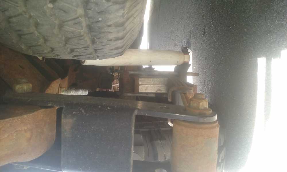

9 years 6 months ago - 9 years 6 months ago #8550 by Noah
This 2000 'ish S10 pick-em-up is a case of lift blocks VS lift shackles.... literally, they're negating each other! (Sorry the pic loaded sideways. For perspective, this was taken from behind the driver's side of the rear bumper, looking forward along the driver's side frame rail)
The lift block only "lifts" the truck if the axle is BELOW the leaf spring. When the axle is ON TOP of the leaf spring, these blocks lift the rear end closer to the frame, thus LOWERING the truck!
Which is only serving to compensate for the extended shackle, which is supposed to push the axle away from the frame, RAISING the truck!
But hey, at least now it has a needlessly rough ride thanks to the tension on the leaf springs. And not to mention a wacky new pinion angle! :lol:
And those U-Bolts don't look dangerously close to the road (especially for a "lifted" truck!)
EDIT: And the best part, this is the second time in 10 years I've seen somebody do this and just completely not understand why the truck isn't taller :woohoo:

9 years 6 months ago #8558 by Tyler
Replied by Tyler on topic diy repair blunders
:lol: :lol: So much effort to make your truck WORSE! It looks like the ground clearance for those U-bolts is measured in millimeters...
Let me guess - this botched suspension is not what the vehicle even came in for, is it?
