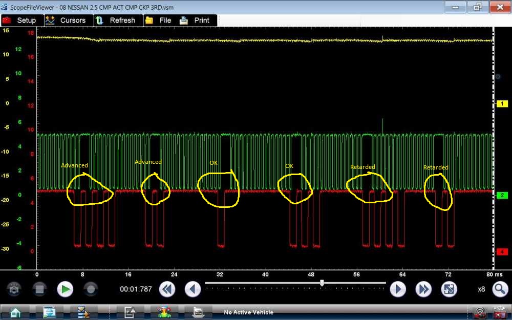

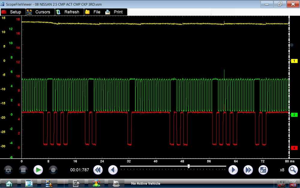

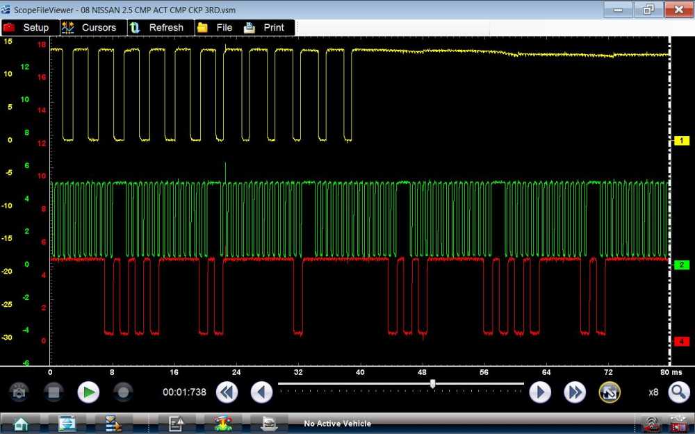

Here are a couple of shots of what I have. I keep getting a P0011 code and some other random weird codes that i think was a bad connection at the computer, but the P0011 I think is the timing chain. Yellow is the Cam actuator, Green is the CKP red is the CMP. It also looks like the cam is moving around without being commanded to. Probably slop in the timing chain.

Hey jim! Thanks for posting your scope captures. I see what you mean about the known good waveforms being different.
I think I know why - the sensor signal polarity is reversed. Your capture shows the CMP being 5V most of the time, and pulses to 0V as the reluctor turns. The known good waveforms are the opposite, maintaining 0V most of the time. The CKP is similar, with your capture showing 5V sync notches, but the known good showing 0V notches. I don't have an answer for that one. :lol:
Still, I do see what you mean about the timing shifting around. I've scoped these signals before, and I remember seeing the downswing of the first CMP notch (doesn't matter which cylinder) squarely intersecting a CKP sync notch. The known goods out there support this. For anyone else following along, I marked up one of your captures:
Is this the same thing you were seeing? If so, then I think you're on the right track with a chain problem.
