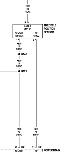

If you have scan data available, then I'd start with a look at the TPS readings, and the IAT. No substituted values are allowed on Global OBD, so seeing something like -40 degrees on the IAT would reflect the P0113 IAT Circuit High code.

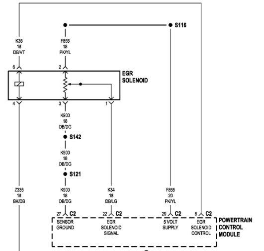

As far as wiring checks, I'dprobably start with the EGR or the TPS first, just 'cause they're easily accessible. Check voltage on all three TPS wires, and all three potentiometer wires on the EGR, backprobed with the key on. We're looking for a 5V reference, signal and ground on both. We have both Circuit High and Circuit Low codes for both the EGR and TPS, so it'll be interesting to see what you find.
What you see on those wires will tell us where to go next.
Here's a couple diagrams to give you a better idea of what to look for on the TPS and EGR.

Thanks a ton. I have the pdf manual and was looking at those exact same pictures! I appreciate you putting them up, though.
Also glad it's not intermittent. It took me months to find a intermittent short in my Ford Freestar. So frustrating, but so awesome when I finally nailed it down and located it and fixed it!
Here's the readings from the TPS and ERG. I was using a quality DMM but not a scope.
TPS: I wasn't able to back probe it (no room for a pin) but I "front probed" the connections on the harness.
3. 5 volt supply: 3.6V one time I read it, 4.7 another time I read it.
2. TP Signal: 3.6V one time, 4.7 the other; the same reading as the reference signal (keep in mind this is unplugged from TPS)
1. Ground: 60 mV
Is that signal wire odd? I thought it was supposed to run up to 5V at WOT, not at idle?
ERG: was able to back probe it
Potentiometer section:
2. 5V supply: 5 V
3. Ground: 1.2 mv
1. Solenoid signal: started at 30 mV, rose to 300 mV, then "no signal" then repeated; rising and resetting every five seconds or so
Solenoid:
4. Ground: 1.2 mV
6. Solenoid Control: started at 30 mV, rose to 300 mV, then "no signal" then repeated; rising and resetting every five seconds or so
Not sure about that oscillating signal. The 5V signals and grounds make sense, but not sure about the oscillating signal.
Thanks for any help!
