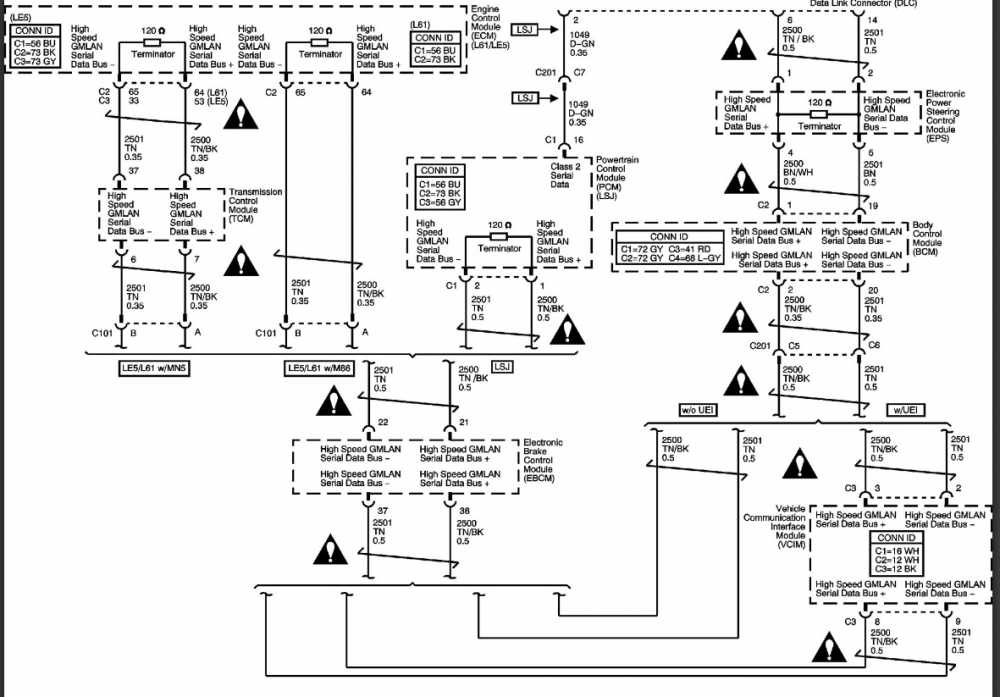

I got curious and decided to go diagram surfing on this one, getting an idea of how the network is laid out. Here's what I found for an '07 G5:
Just like you found, the VCIM is optional, and the OE diagram includes the RPO numbers that go along with that option. The interesting part, though, is that the diagram doesn't show an option for no EBCM. :huh: As far as the diagram is concerned, this year of G5 HAS an EBCM. Worse, according to the diagram, it has to be there or there wouldn't be communication between the PCM and the scanner. :blink:

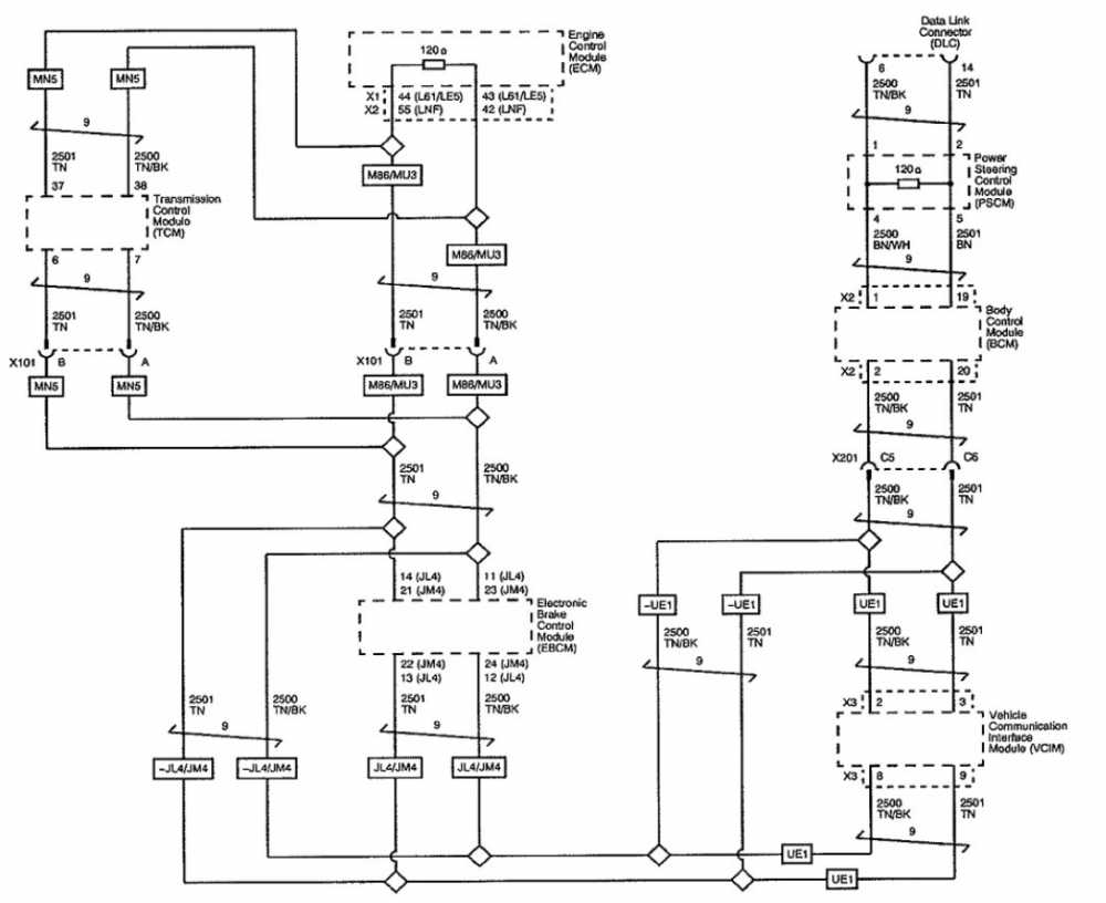

For giggles, I went one year newer and looked at the same network diagram:
Now we see an option for EBCM.
Could you check your RPO sticker, and see if JL4 or JM4 is on it? If I remember correctly, the sticker will be in the trunk, under the carpet, on the left side of the spare tire well. This'll tell us if the vehicle originally came with ABS or not.
