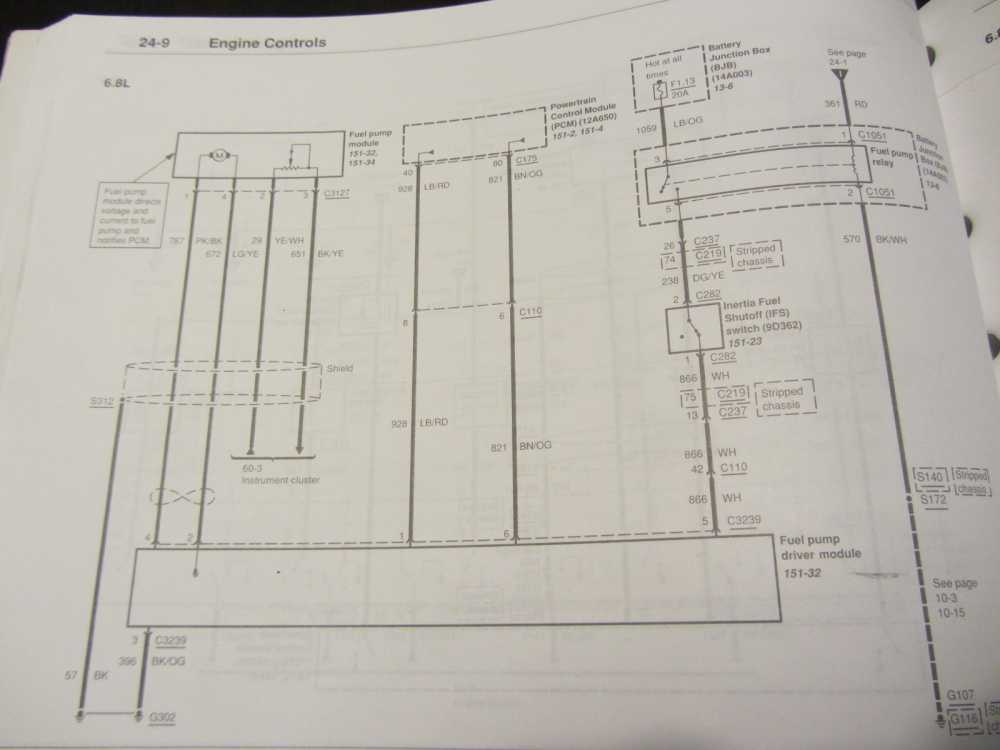

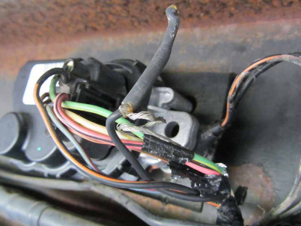

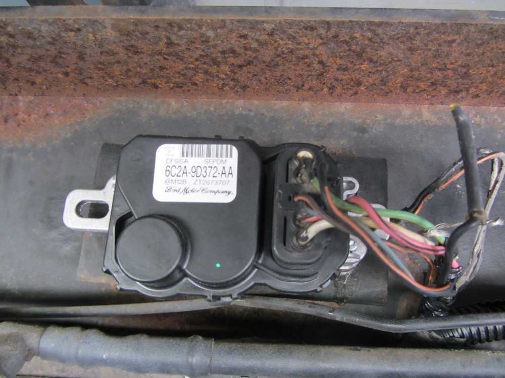

Here is a picture of the wiring by the FPDM which I have removed some of the electrical tape to look at the grounds. Is it common to have the wiring look as such, looks kind of funky to me. The FPDM is mounted on a plate coming off of the frame, so I am wondering if this is causing some problem with ground. Also, the wiring diagram is below and shows a twisted pair of wires, I think fuel pump power and ground. These I believe were wrapped with electrical tape that had some sort of foil underneath. Is this common as well? This thread is a follow-up to an earlier thread. I had different results the other day..everything checked out okay, but had FPDM ground = 0v KOEO and 2-4v cranking. Not sure where to go from here??

First thing I see is the pump not getting run, since the ground voltage never changes from system voltage. Second is the elevated ground voltage on Pin 3, waaaaaay too high. I can see why you were interested in looking at the grounds! :lol:
You're right on about the twisted pair of wires for the pump, and it looks like the shield for the pump motor and level sender ends up grounding in the same location as the FPDM. That splice in your picture looks OE to me - that may actually be S312 in the diagram.
Anyway, I think you've found the problem with the FPDM ground. :cheer: Just to test that theory, you could backprobe that pin and add a jumper wire from B-. With a good ground, the module should work correctly. If it does, then pursue a high resistance problem on the FPDM ground.

Do I need to re-wrap that twisted pair with some sort of foil tape? I like the idea of jumpering from battery ground. I'll give this a try and report back.
Eh, probably should, but I dunno where you'd get the foil tape. :lol: How much of it did you remove? If it was just an inch or two, I'd just use regular electrical tape and call it good.

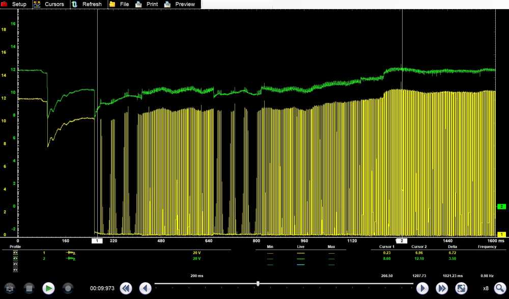

You'd think so! But that's what makes the FPDM different from most setups - it almost never gives the pump a steady ground, even during cranking. Here's a cleaned up version of the known good captures I posted in the first thread:
Green is pump power, yellow is pump ground. Cursor one marks when the pump starts running, and cursor two marks when the engine actually started. The FPDM grounds the pump pretty heavily at times, but never constantly. This is why your DVOM is showing you around 7V.
Thanks for this. These known good plots seem really useful, especially for referencing after you have made potential fixes. I will go ahead and make a dedicated ground, tape up my wiring and report back. Hopefully p1233 will go away for good! Many thanks for all the insight!
