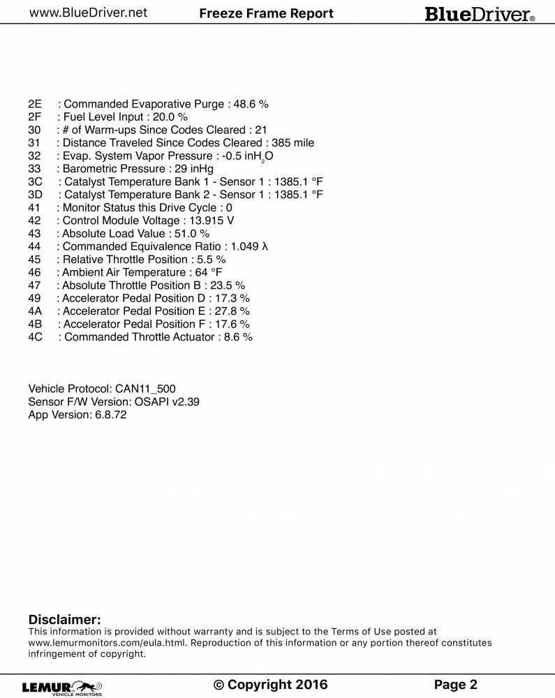

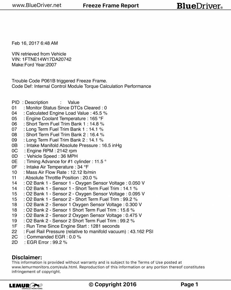

1/ Created shared folder on dropbox where i uploaded all freeze frames, live data etc.
www.dropbox.com/sh/qm0v64t3v3nn0k2/AAAoh...p-rE4r2rHLzISQa?dl=0
2/ Brake booster test went like this: If i unplugged the booster hose, car would crank but not start. If i plug the hose with finger and start the car up, then remove finger, car would keep running, there would be only small drop in RPM.
3/ Cave in to my wife and went for another smoke test and car diagnostics, this time at Pep Boys. They said i need new MAF, which i replied it is already new, so they said to try another brand, that HITACHI one i 'm using might not be 100 % compatible. Long shot but i did returned HITACHI to O'reilly's and get the other brand they had, remanufactured Cardone, long story short, did not make a difference.
4/ Car stalled again yesterday (uploaded new Freeze frame and live data to dropbox link above), but this time for the first time there is another code pending with P061B and that is P2198. It is only pending so i will try to drive it to work tomorrow to see if it will illuminate MIL or not.

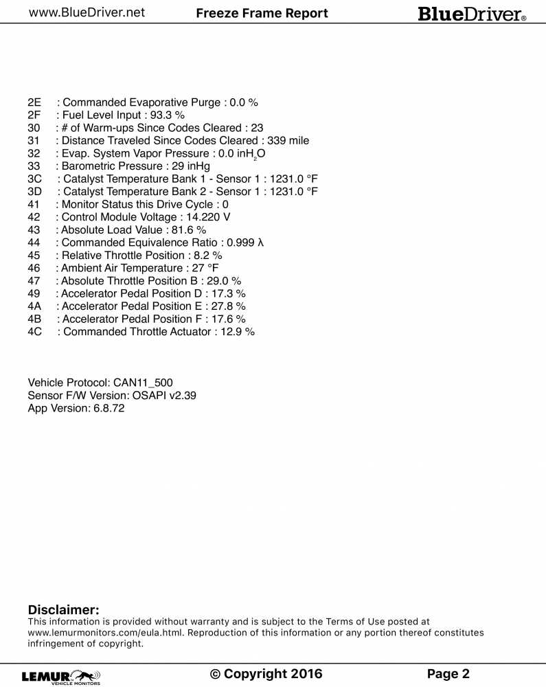

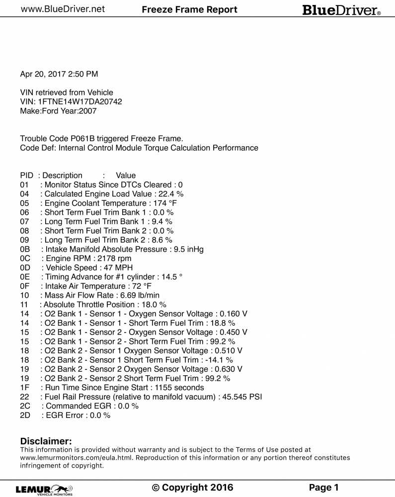

Hey hans! I haven't forgotten about this thread. ;-) Thanks for the e-mail and the freeze frame upload, much appreciated.
The P2198... I think the code definition for that one is Bank 2 Not Switching, Stuck Rich :unsure: Not sure how that one is connected yet!
I'm still convinced the answer is in the freeze frame somewhere, so I'll be looking those over. Somehow, the PCM isn't happy with it's torque calculation, and I figure the reason has to be in one of it's main engine load inputs.
9 years 5 months ago - 9 years 5 months ago #9310 by Tyler
Replied by Tyler on topic 2007 Ford e150 4.6L V8 code p061b only
Talking out loud here, for whatever good it'll do. This is as much for my benefit as anyone else:
1.) On a couple of the captures, the calculated load and the absolute load don't match. February 23rd is the best example... 22% calculated load (low load, close to idle), MAP is 9.5 inHg (low), MAF at 15.45 lb/min (or 115 g/s, which is relatively high), and 81% absolute load (WOT or close to it).
My understanding says calculated load is based off the MAF (which sorta match in the February 23rd capture), while absolute load is based on the MAP (which does NOT match). Why does the PCM think the engine is under such high load? :blink: The MAP would need to be reading closer to 25 inHg for the absolute load number to make sense.
2.) The no start symptoms kinda match a lack of fuel problem. I was wondering about some kind of air restriction issue initially, but I think your brake booster test rules that out. Now I'm kinda wondering if there's actually a fuel pressure problem. :unsure: Hypothetically, if the fuel rail pressure sensor were lying (stuck at 40-ish PSI, for example), then the actual rail pressure might be quite different. This might explain the stalling, the lean trims (not enough fuel pressure), the P2198 (too much fuel pressure), and the no start.
Try this: Next time you anticipate a no start, try adding some carb clean to that same brake booster hose. If it runs off the carb clean, but won't otherwise, then we're going in the direction of fuel pressure.
Last edit: 9 years 5 months ago by Tyler.

Was able to trigger p061b on demand. Uploaded a video and appropriate scan data and live data from May 13th. Before i trigger P061b i pressed gas pedal lightly 3 times in sequence, so it is seen on live data and easily identified. 4th spike pedal goes all the way to the floor and car stalls. Might be in conjuction with triggered P0171, hopefully this is game changer for us. Afternoon, after my chores will try to do brake booster carb cleaner tip.
EDIT: So this only worked on cold engine, when i was returning back from customer estimate, i tried it on my driveway again but this time car revved like there's no tommorrow and continue idling. Uploaded live data as well, stamped May 13th, 9:56 am
Last edit: 9 years 5 months ago by hans.andersen. Reason: Cold engine only, new data uploaded
9 years 5 months ago #9519 by Tyler
Hey hans! Loving the data you're uploading, much appreciated.

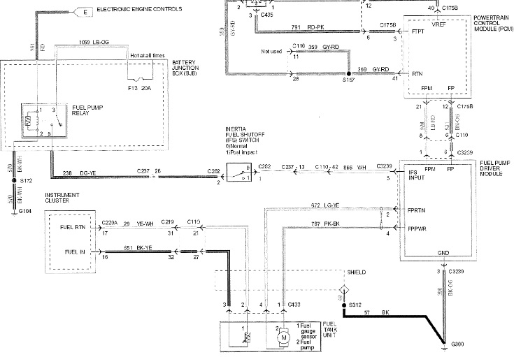

That video sure makes it seem like the engine is running out of fuel... This sorta makes sense in light of the lean codes and no start cold. I'm starting to wonder about the Fuel Rail Pressure Sensor, and if it's telling the truth. The sensor itself is a bit too expensive (around $100) to just take a guess at, but I can think of some quick tests to try if you're game?
Here's a diagram of the fuel pump electrical circuit, for reference:
My thinking is that, after sitting overnight, the fuel rail pressure will be zero. The rail pressure sensor should agree with this, but just getting in and turning the key on won't work, since the pump will prime and raise the rail pressure. What we need to do is disable the pump BEFORE you turn the key on. The easiest way I can see to do this is to pull fuse #13 in the Battery Junction Box (or the relay, doesn't matter). That'll kill the Fuel Pump Driver Module and prevent pump operation. Then, check the fuel rail pressure with your scanner and see what it says.
The other ways to check the rail pressure sensor would be removing it from the rail and using a hand pump to check it's rationality, or hooking a pressure gauge to the Schrader valve on the rail. Not sure if you have a hand pump or a gauge set, and both of those tests would probably require removing the doghouse. :-(
