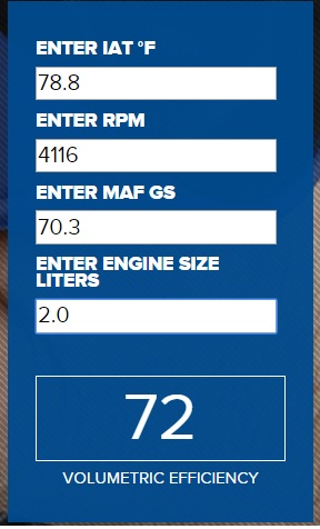

9 years 6 months ago #8999 by gav09
Replied by gav09 on topic 00 tracker wot rpm bog.
Dothedew92 wrote: DRIVING WOT.
Ect 186
Stft 0
Ltft 4.8 (blurry so don't quote)
Map 28.3
Rpm 4116
Speed 27
Adv. 21. (Take 2) 21.5
IAT 78.8. 78.8
Maf 6.8. 9.3
Tps 92.5. 99.6
02 S1 .020
02 S2 .035
I'm assuming the Maf data is in lbs/min and not gr/s correct?
If so looks like the engine is breathing ok.
The o2 sensor is your clue in the data. You are running lean at WOT. You need to get a fuel pressure gauge and see what the pressure is at WOT. I'm guessing that the pressure will drop very low under load.
