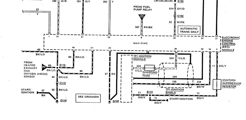

need a wiring diagram of the pip sensor?? also what is the spout connector for?? its been forever since I worked on one of these. im going to try and help my brother out it stalls when hot. im thinking he maybe losing ignition
9 years 6 months ago - 9 years 6 months ago #9020 by Tyler
Replied by Tyler on topic 1990 ford tempo.
Ugh, not one of these stupid TFI modules. :lol: Here's what I've got:
The PIP is internal to the distributor, as far as I know. The SPOUT is the PCM's spark advance signal - take the shorting plug out, and it'll go back to base timing. I can't tell you about the other wires without doing more research.

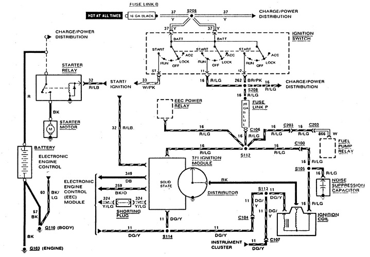

EDIT: Found a better diagram.
Last edit: 9 years 6 months ago by Tyler. Reason: I like big diagrams and I cannot lie
