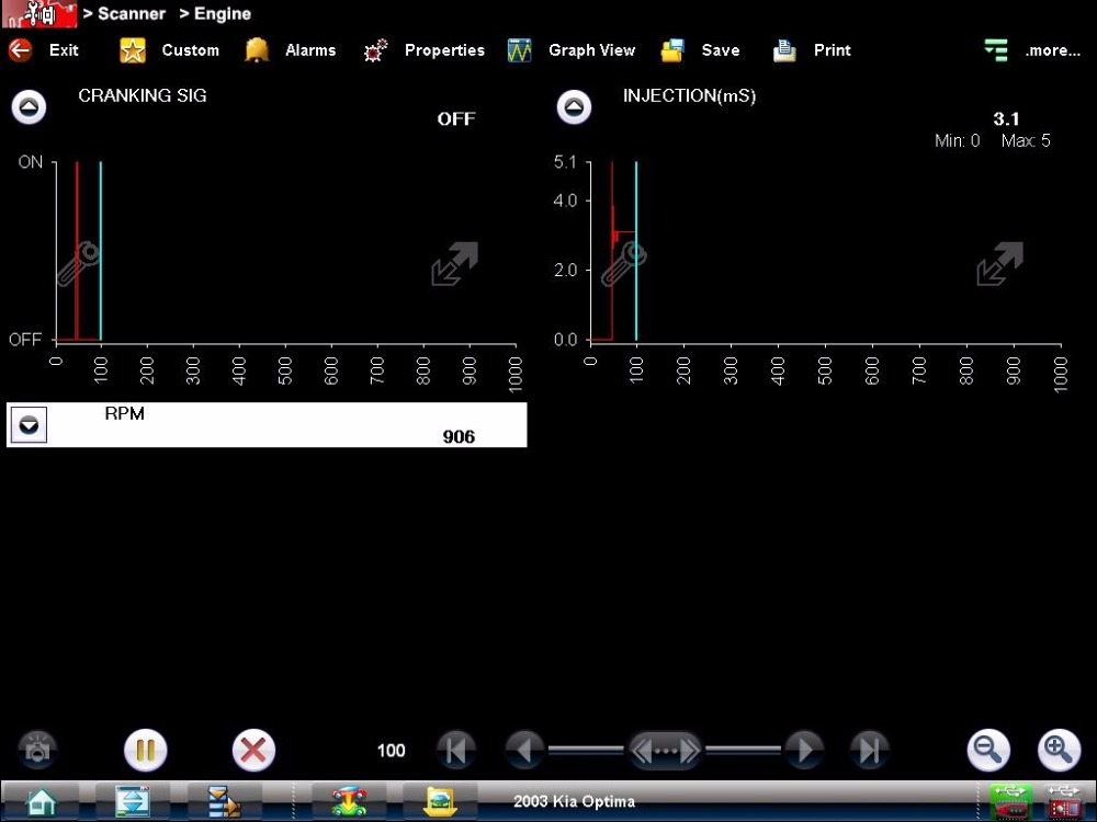

they changed the ecm, maf, cam sensor the injectors. Diagnostic procedure: volt drop test both sides good, battery 12.4v, cranking rpm 430, cylinder compression test 165psi, fuel pressure 55psi, injectors pulse 3ms, injectors flow 4oz 1min, crank and cam relation correct, timming mark correct, cat no bad pressure, new ignition coil, good ignition timming by pressure transducer, all Mitchell test pass, ecm good power, ground, voltage and reference voltage. All the sensor have a good signal. only start when u block the fuel line, fuel pressure goes up to 100psi.
why the car start only when I block the fuel return line????
9 years 6 months ago - 9 years 6 months ago #9055
Hey carlos! Just to be clear, 3mS is the injector pulse width you saw on the scanner during the cranking? That number sounds low to me.
Which might explain why the car starts with the fuel return blocked. Jacking the rail pressure up to 100 PSI forces enough fuel through the injectors at that smaller pulse width to get things started. You could verify this theory by adding carb clean to the intake instead of blocking the return. Once running, does it run well?
If that 3mS number is correct, then I'd suggest looking closely at the ECT and IAT. These help determine cranking injection pulse width, and could potentially cause the ECM to underfuel the engine during cranking. An easy test of the ECT and IAT is to let the vehicle sit overnight, and see if they agree with each other (within a few degrees) in the morning.

I've got an '01-ish Optima in the shop right now. If it's a 4 cylinder, I'll see what the cranking on time is and post back tomorrow.
