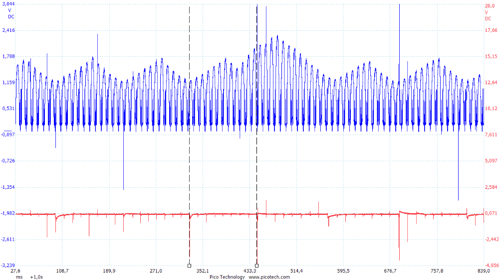

* Latest test was logging of the intake port pressure of cylinder 7 (with an external MAP sensor) and the signal from an inductive clip on spark plug wire of cylinder 7:

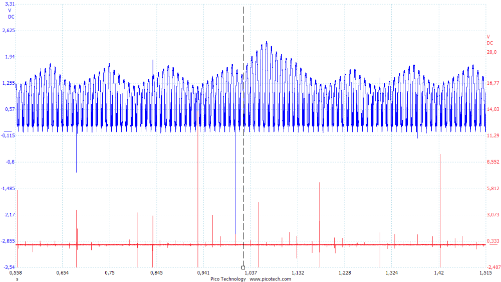

Also I logged intake port pressure 7 and the signal of a capacitive clip on spark plug wire 7:
The inductive and capacitive clips I have rigged together pick up quite some noise, so please just use these signals to relate the pressure signal with the spark in cyl. 7.
The pressure log shows that the flame in intake port 7 starts aproximately two firing events before spark 7 occurs. This is about 180° crank rotation before firing of cylinder 7. At this moment, intake valve 7 is still open. This would suggest, that spark 1 crossfires into cylinder 7.
My Question now is: If this is a crossfire, how can this happen without showing up on either capacitive or inductive signals of spark plug wire 7? How can I proceed with this problem? How can I determine if this is distributor-related or wire related?

Thinking about how to confirm your pressure testing results... What about using a test light to short spark out of the distributor cap, one cylinder at a time? If you short a cylinder and the backfiring stops, then you know where the stray spark is coming from. Not sure if this is practical, depending on distributor location and how intermittent the backfire is.

I agree with you, if my pressure log is right (IF!), then this seems to be a R/H bank (Cyl1) to L/H bank (cyl7) crossfire.

The flame in intake port 7 occurs at idle in average about every 30 seconds, sometimes twice in a short interval.

Further intake port pressure logs on cyl 7 with grounded ignition wires led to the conclusion, that sparks 1 and 8 cross into cyl 7 and cause the occasional flame in intake port 7. With grounded spark plug wire 7 I could also observe some rare flames in other intake ports which I could not identify because these occasions were very rare (and quick).
Considering the fact that spark 1 crosses into cyl 7, this problem cannot be a spark plug wire routing related issue. Spark 8 into cyl 7 maybe, but spark plug wire 1 is very distant (and on the other bank) from spark plug wire 7. Further from the the observation that other cylinders have the similar problem (although much rarer) I concluded that this is a distributor-crossfire situation. I am very sure the spark in the distributor "crossfires" in a radial manner, from the central terminal to other cylinder terminals. The latter are the ones that lead to a cylinder with some vacuum (intake valve open), where the spark gaps are less isoltated by air than in the comression situation.

* A radial crossfire in this particular distributor cap will require the spark to jump aproximately 1". From the observations and conclusions drawn, this obviously represents less resistance than firing the spark in the correct cylinder after the compression stroke (in this case with high compression of 10.4 and a stochiometric, non-rich mixture). This is hard to believe for me, but probably the only possible explanation.
* A crossfiring spark at the intake stroke can be so weak, that it is not distinguishable from noise (at least with my Bosch capacitive and inductive clips).
