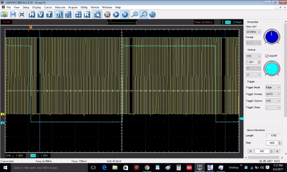

Cam / Crank pic didnt upload correctly previously.

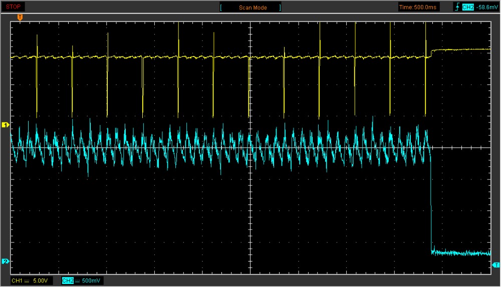

Finally, the car acted up for me. I was monitoring the VCM(Variable Charge Motor) with my Hantek1008c scope during the cold start. Motor position voltage went to 4v and did not see motor control to make motor move to this positon. During normal idle operation, motor position voltage stays at approximately 1v. Will need to see this happen again without misfire on cold start to see vcm position value. VCM position stayed 4v after fast idle dropped and misfire disappeared. The vcm position did not change until I snapped the throttle. Unsure on when this vcm position was commanded to switch but I never saw it unless it happens when the car is off when ECT, IAT and Ambient temp reach near same temperatures. After fast idle dropped or sometime thereafter vcm control was taking place, but the position voltage was not changing. I am now very focused on this VCM, but would like to capture more data, Unfortunately, it will only control it for a cold start scenario for lower emissions. I must now wait till later for my next cold start event. Will try my best with my piece of crap scope to capture and save this data.

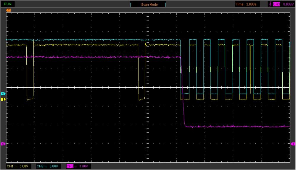

Today I gained access to a smoke machine and smoked the intake with it cold. No leaks found, miraculously it sealed up to drop the flow rate on the smoke machine. Is it even possible to have two enough valves closed to seal the intake from the exhaust.... Tried also spraying the intake during cold start with water, nothing found. Borescoped the injector opening to check for carbon on intake valves, none found. Removed cylinder 4 plug and pressure tested coolant while cold, no leakage of coolant to cylinder found. Swapped VCM (variable charge motor) from known good car, didn't fix. Side note, I don't understand the VCM control voltage data collected, as it appears it tries to command the motor to move, but the position voltage stays at 4v on cold start until throttle is touched, then drops to 1v. Then, PCM goes to duty cycle motor control wires on and off at exact same time, which would cause no motor movement. Only during the cold start period, I see just one control wire cylce in what looks like an attempt to move the motor... scope capture attached.(yellow and blue trace are motor control, purple in position voltage)
