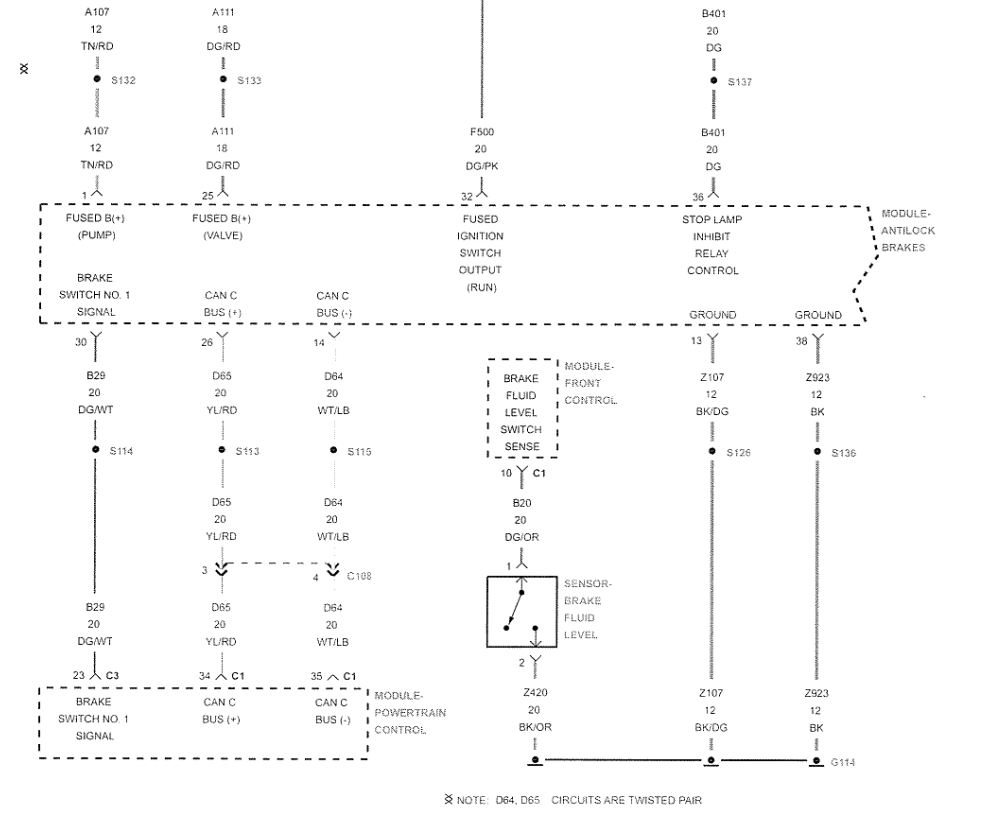

9 years 5 months ago #9421 by W8up4Rick
Hello, I live in Northwest Ohio and have a very clean garage kept 2007 Dodge Durango that I am working on. I am trying to troubleshoot a C1008 Brake fluid level sensor circuit too high trouble code. This vehicle came to me and the owner of the vehicle has replaced parts trying to get rid of his brake light on the dash. It says that the code sets when the brake fluid level sensor reads 4.9 Volts or more for more than 5 seconds. The odd part is when I measure voltage with my DVOM I only read 4.8 Volts and that corresponds with the Brake Fluid Level Sensor (V) PID on my Solus Ultra scan tool. I've done voltage drops on the ground side (.5mv) and Reference side (4.8V) from the brake fluid level sensor to the ground and the Front control Module. I've also done resistance checks of the wires and both had .3 ohms. The level sensor itself has 9.9 Kilo Ohms of resistance when Open and when i use a magnet i can get it to close and get .3 ohms resistance. I am able to watch my scan tool with my sensor plugged in and can use a magnet to close the circuit and the cicuit will close and read "low" on the PID. I can also use a screwdriver to push the float inside the resevoir down and the voltage will go to ground and indicate a "low" fluid reading on the scan tool. The owner requested that we gamble and throw a used Front control module at it and that didn't change anything.
He has also replaced...... (before bringing it to me)
The brake fluid level sensor.
The master Cylinder with reservoir that included another new fluid level sensor.
The brake booster (had brake fluid in it).
I am not sure what else to test, I was wondering if anyone had experienced this issue or had any advice on where to look next.
Thanks in advance,
Rick

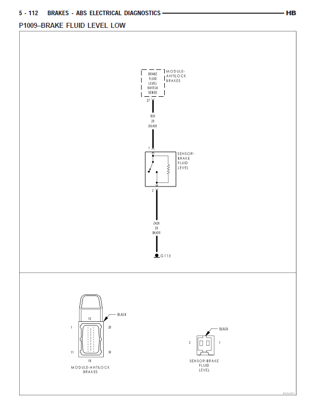

I've been following this since you posted it as it's an interesting case study. I searched around a bit the other day but didn't find anything concrete so I didn't post. I hope that I'm not posting the obvious but thought I'd share my observations. I found the following diagram at the BBB database:
www.revbase.com/BBBMotor/Wd/DownloadPdf?id=139274
Page 1 shows the fluid level sense circuit. I couldn't find anything more specific about the FCM. At first glance the level circuit appears very simple. It looks like an open/closed switch connected to the FCM. However, if the circuit is monitored then I figured that couldn't be the case. I searched around for a FSM for the 07 but was only able to find one for an 04. In browsing that manual it shows this same circuit (but with the sense line connected directly to the ABS module instead of an FCM) but with a small added detail. Inside the sensor is a resistor. See below:
This makes sense (no pun intended) if the circuit is going to be monitored. It also explains the resistance of 9.9 kohms you are seeing across the sensor terminals, as well as the code setting criteria of seeing over 4.9 volts 5 seconds. Obviously, it has to see less than 4.9 volts and it's likely sending the 5v reference across that circuit for monitoring. There is a troubleshooting tree in the 04 manual and while it doesn't mention what the resistance spec should be, it does say that if it's over 11kohms that the sensor should be replaced. Seems to me if you have any corrosion or other problem in the sensor connector pins, at the ground (G114), or even at the FCM, or possibly at the TIPM, you could get the code you're getting. Since the code is being set by the FCM it makes me not suspect the TIPM. Can you get a resistance reading from between the FCM, at the sense line, through the sensor, and G114?

8 years 3 months ago #22121 by billb
Spent better part of 2 days doing point to point wiring checks on my 2007 Durango with 5.7 and constant Brake light on dash. Had replaced the master cylinder with a new Cardone master cylinder (made in China) and finally found after using my Fluke meter that the old sensor gives 2,000 ohm when full and the new sensor from Cardone gives 10,000 ohm when full. Finally swapped the old for the new sensor and it works as expected.
Seems the circuit requires a small bit of current to go through to ensure everything is connected. This worked for me and hope to save someone else some time.
8 years 3 months ago #22125 by John Clark
[quote="billb" post=22121...Seems the circuit requires a small bit of current to go through to ensure everything is connected. This worked for me and hope to save someone else some time.[/quote]
That means that there is, indeed, a resistor in the sensor and it's not just an open/closed sensor.
