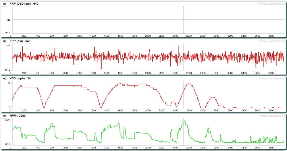

Hey bruce, sounds like you're on the right track with a fuel pump to me. :cheer: It it's available to you, try graphing the FRP and FRP_DSD (desired) and see if they agree under a load. This confirms that the PCM is commanding fuel pressure, and isn't getting it.
If it helps, here's some scan data captures I took off an '07 E-350 with the same 6.8L. Dunno what happened with ScanShare, but bump the decimal point on the fuel pressure PIDs one spot to the left. ;-)
www.scanshare.io/share/-82L7m209kyxGFOz5...1,2,3,4,5,6,7,8,9,10

Thanks. Looks like yours didn't drop below 61 psi under load and the desired stayed the same.

bruce.oliver wrote: Thanks. Looks like yours didn't drop below 61 psi under load and the desired stayed the same.
I didn't see desired pressure on the pid list. I'll check again tomorrow
Sorry I didn't have any heavy load or WOT data - this was a municipal bus, so they tend to frown on speeding. :lol: But I'd be very surprised to see the desired go lower than 65 PSI during heavy loads.

Nice fix, sir! :cheer: I think it's probably safe to say this engine always wants 65 PSI, then?
