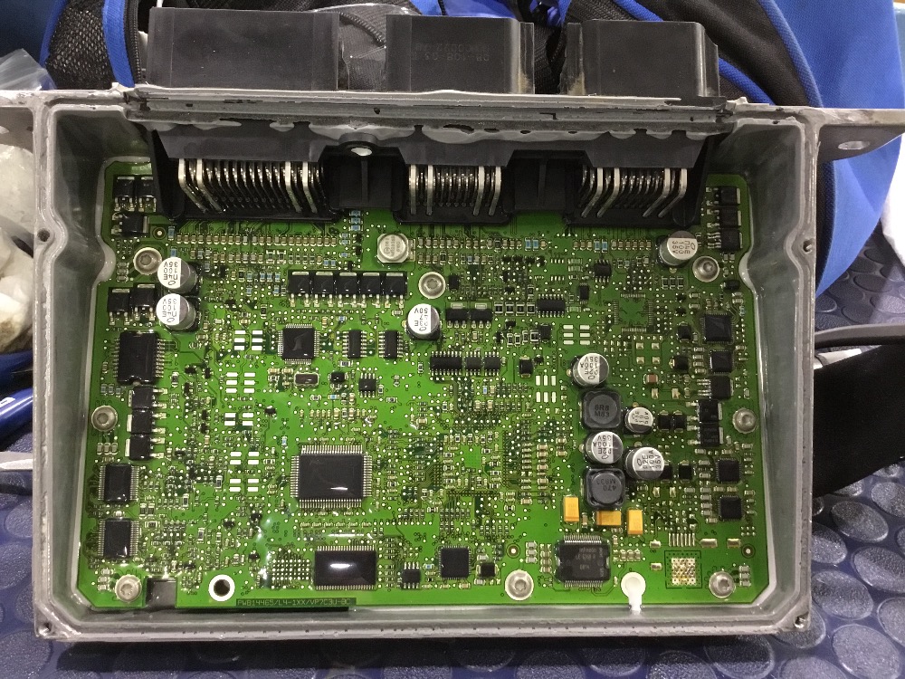

I couldn't resist cracking it open. I don't see any obvious heat damage. Following the traces from the pin looks impossible without removing the board. It looks to be glued in so I guess I'm done looking inside. I was hard enough on it just opening it. Looking to send it off to SIA in Illinois . I need to make a decision today.
