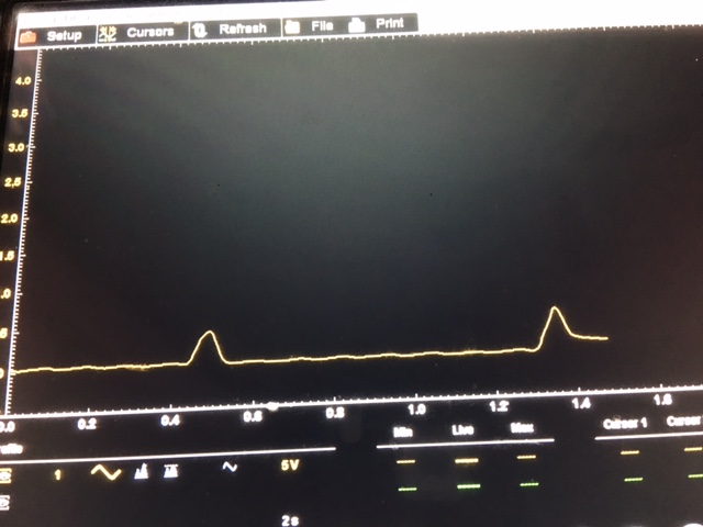

Working on this truck a few days now. The truck just cut off while driving. It blown the number 19 main fuse (this was for the fuel pump} it was replace and now the truck wont start. We connect the scan tool and getting no reading from the obd2, I check the power and ground, they are good. we check for spark, it's good. The pump will prime sometime so we jumped it and found-out that there's no pulsing from the injectors
got the ford wiring diagram to check the camshaft sensor out because i know most of the time it the cam that controls the injector pulse but I don't really understand it like that. You see am Just learning, trying to get in this field, but anyways I'm seeing the wiring that goes to the computer from the cam sensor and another going to the knock sensor. I put the probe on the one that saying cam pos in but not getting any waveform. On the crank I saw one of Paul's video on the 4.6 and was able to connect the scope to the crank positive and negative to get a good waveform. Oh I have power on both wire on the injectors but the computer not pulling them to ground. I hope this is enough info to get some feedback, please if you need more just let me know what you need, I'm grateful for any and every bit of help I can get. I've attach a picture of the cam sensor after testing it again.

you are so right. there no check engine and anti-thief lights on the dash.where do I go from there?
I have good cam and crank wave forms but just no injector pulse

So I tried the verus again to see if I could communicate with any other module and was able to with everything other then the anti brake and pcm. I tested all the power and grounds. All passed so I did a resistance check on all the ground all pass but pin 76 on the ECM with had 342.5 pin 76 runs to pin 87 on the ecm relay with runs power to the fuel pump from the ecm pin 80.

maybe try unplugging the abs module? might be messing with the communication network. any codes in other modules??
