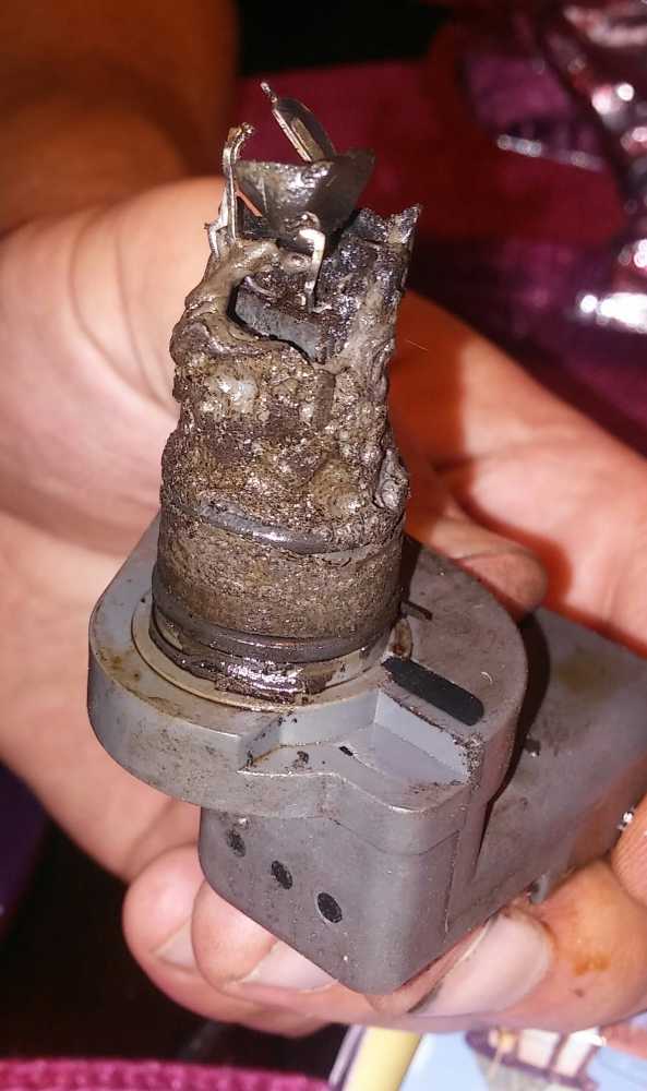

I have a 1997 dodge neon and we have gone through 3 crank sensors and every one of them get chewed up. We put one in go a few miles and then the car dies out. Please help

You meen physically gets damaged or electrically burns out? Is it a VRS or Hall effect? Has anyone checked supply voltage?

How about some pictures of the chewed up sensor?

Here it is
10 years 2 months ago #952 by Tyler
Replied by Tyler on topic 1997 dodge neon crank sensor
WOW, that's... melted? :blink: Not what I expected to see at all.
Kinda looks like there was some kind of physical damage, too. Imma look at TSBs and iATN.

The other two that we put in were just chewed up. I don't have pics of the other two though. I have googled this problem and there is absolutely nothing about it.

If the other ones are just beat up and not melted, I'd say Chris is right on about having to shim that sensor.

Automatic trans? Thinking extreme heat may have been a factor.
As far a the physical damage goes on the previous sensors it's most likely an air gap issue between the sensor and flywheel. To check that set the sensor in with out the o ring and have some one rotate the engine by hand and see if the sensor pushes up out of the hole.

Far out. Is that reading directly off the crankshaft? Did the original one fail the same way or has the burning out problem started since an original was replaced?
