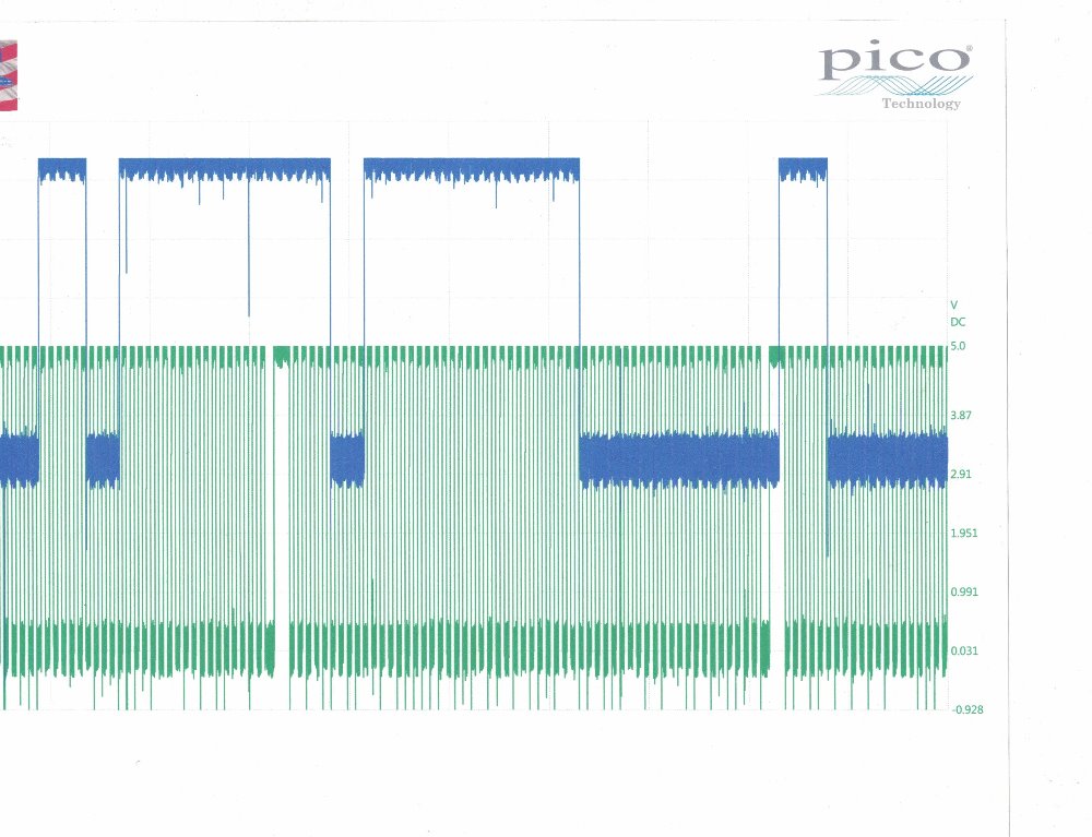

As the title says guys. I have this truck in here and cannot find a known good pattern anywhere. I believe the chain is stretched or tensioner is failing b ut can't prove it. Can anyone assist?

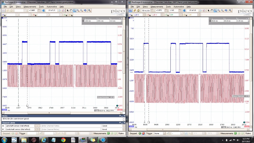

This is from a 07 suburban but I don't know what engine code it was. It had a broken guide and jumped a couple teeth.
9 years 5 months ago #9600 by gav09
Replied by gav09 on topic 2008 Tahoe 5.3 vin 0 cam crank pattern??
The one on the left is the known good.
