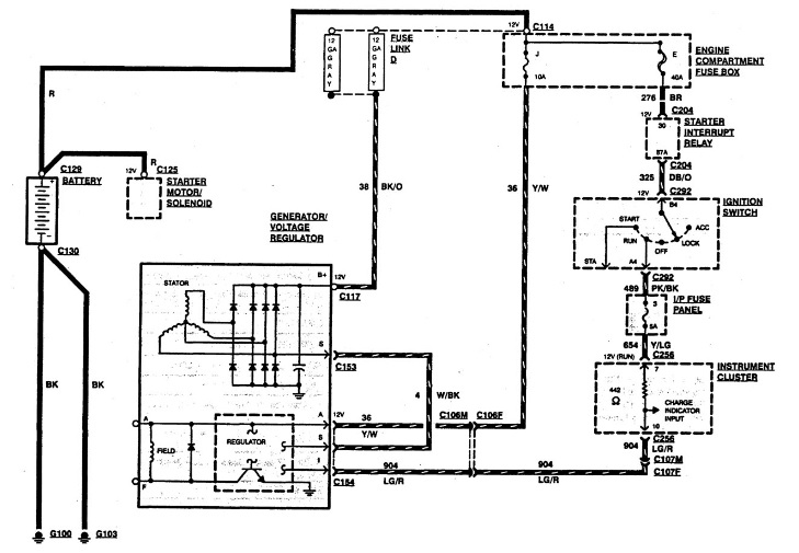

Hello again. This time I have a 95 Lincoln Town Car Cartier with the 4.6 motor and 46k and a intermittent starting issue. Sometimes when I try and start the car it will crank over. Usually when I turn the key to the on position I will hear the fuel pump prime up. It seems when the battery is a little low, it won't prime when I turn the key on and this is of course when I just get it to crank and no start. I can attach a fully charged jump box to the battery and I will get the fuel pump prime with the key on and the car will start. I check the battery voltage and when I get the no start/crank and it is around 11.4 to 11.8. My question is does the fuel pump need the full 12 volts to get it to prime or is something else at play. Or possibly that 22 year old fuel pump is on it's way out?

9 years 5 months ago #9734
Replied by Tyler on topic 95 Town Car cranks but no start
Hey Slimmer71! I'd be interested to know if the check engine light comes on when you get a lack of prime with the key on. It kinda sounds like the PCM isn't getting powered up (and therefore isn't running the pump prime), but raising the system voltage brings it to life. 11V in the battery is definitely low, but it should still be enough to get a prime out of the pump.
The system voltage with the engine idling is 12.4V? :huh: That's a possible indication of a weak charging system. The battery only reaching 12.2V after charging is concerning, too. It might be best to address the battery and charging system first before going into your fuel pump issue.
Here's a quick shot of the charging system diagram:
A quick and easy check of the alternator and cables would be to verify battery voltage at the main battery post on the alternator, and a voltage reading at the case of the alternator. The main battery post voltage should be pretty much the same as at the battery, and the case should show 0V.

- Simmer71
- Posts: 11
9 years 5 months ago #9821
by Simmer71
Replied by Simmer71 on topic 95 Town Car cranks but no start
No check engine light at all. I had the battery and alternator tested and the alternator is good but the battery checked bad. The voltage dropped when placed under load. That battery was about 3 years old but the car sits alot and gets started maybe once every 3 months or so. I am thinking that did it in. I bought a new battery and have been driving the car for a few days and the car starts everytime now.
