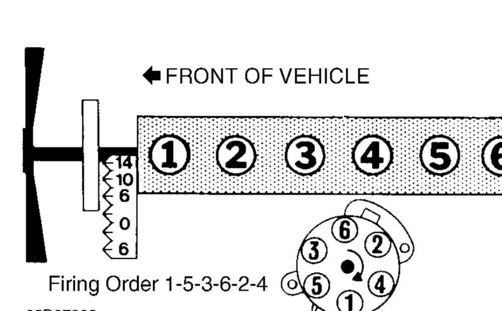

does anyone have the correct procedure howto install this new distributor so when i install it this vehicle will run again this distributor is brand nes and i do believe i might not have gotten this distributor installed correctly / i grounded the fuel pump and it cranks like it wants to start but its not started yet can someone plz help with a diagram showwung the correct installation position for this TFI distributor and again thanks for all your help Gerald
9 years 5 months ago - 9 years 5 months ago #9740 by Chad
Replied by Chad on topic 1996 Ford F 150 4.9 L6
Roll #1 up to TDC on the compression stroke. Drop the distributor in with the rotor pointing directly to where #1 would be if the cap was on. As the distributor shaft lowers into the engine, it will turn slightly as the teeth of the gears "mesh up". Take that into consideration when beginning the descent.

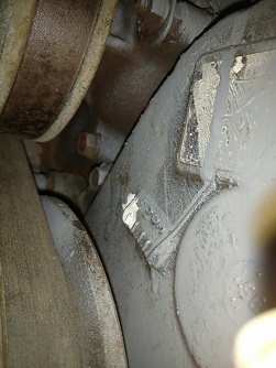

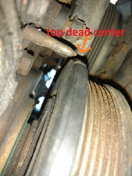

here is pictures of the distributor and hamonic balancer at top dead center

9 years 5 months ago #9744 by Chad
If you are sure you are on compression stroke (remove #1 spark plug and plug the hole with a finger. Roll the engine by hand until pressure forces your finger out), and at TDC (visually, if you can, watch the cylinder come up and VERY momentarily pause be for going back down. (That pause is TDC.)), then, configure your plug wires on the distributor cap to match the firing order in the Diagram. Make sure #1 cylinder is where your rotor is pointing. (in your picture, it looks like the rotor is pointing to #5 on the diagram)

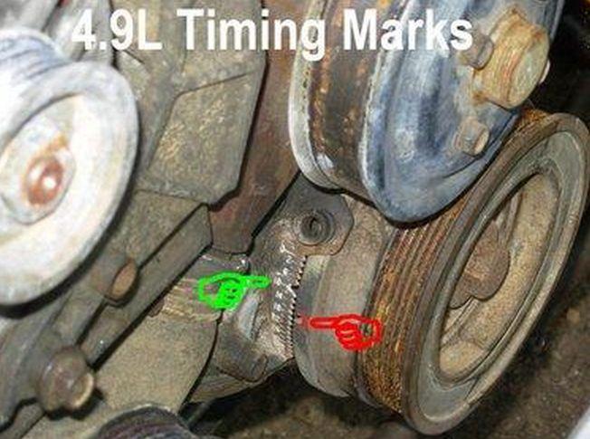

this pointer is on left side of engine if i put it on the numbered marks on right side of engine my piston is on bottom dead center ive checked timing marks on both timing gears i wonder if the harmonic balancer has slipped heres a pic of right side line up marks

Does yours look like this?
A google search brought me to this thread on another forum.
stop-the-star-program.3084.x6.nabble.com...iming-td5027709.html
9 years 5 months ago #9748 by Chad
Copy and pasted:
Just check timing on a 93 Ford F 150 4.9L V6. Now theres two places to check the timing one from driver side and one from passenger side, both sides have timing marks. Which side is the correct side to check the timing? I went with the ones on the passenger side.
The passenger side is correct. Pull the SPOUT and check that it's 10° BTDC. That engine family has been around since the mid-to-late sixties, and the driver's side pointer is obsolete and unused since the mid-seventies.

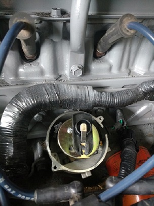

The rotor inside of the distributor is in line with the outside marks heres a pic

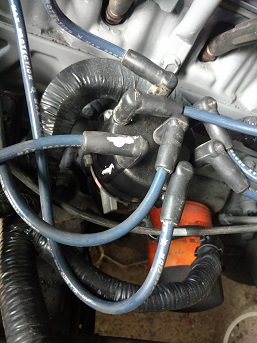

ok here is a picture of how i have this distributor installed now / according to the diagram posted earlier in this case study//// please check to make sure im on track thanks again
9 years 5 months ago - 9 years 5 months ago #9812 by Chad
That doesn't look too bad. If the #1 cylinder is STILL at TDC of the COMPRESSION stroke, then put the cap on, put plug wire #1 were the rotor is pointing, put the rest of the plug wires on, accordingly. If all is well, it should fire up. If it doesn't, turn the distributor, slightly, one way or the other and try again. It might take a little tweaking of the distributor position to get it to fire up. When it fires up tweak the distributor to get the best idle for warm up.

Replied by toadyboy1957 on topic 1996 Ford F 150 4.9 L6
as long as i use quick start it staryts and runs for 3 seconds then shuts off which tells me i have a fuel delivery issue / i tried for 30 minutes had to use quick start every time but it turns over really fast and all cylinders are ffiring so onto fuel

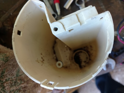

9 years 5 months ago #9836 by toadyboy1957
NO wonder its not pumping new pump ALL crudded up
