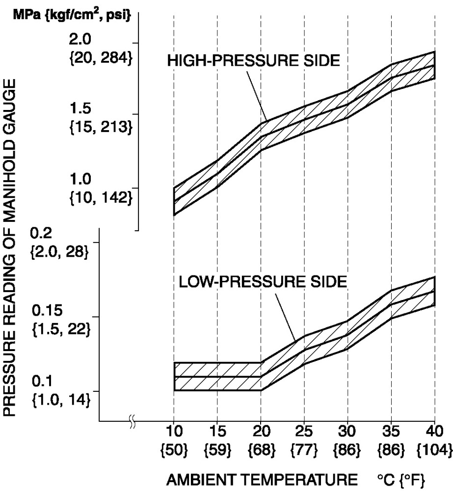

9 years 5 months ago - 9 years 5 months ago #10043 by Ivan
Replied by Ivan on topic Re:AC work
See attached normal pressure chart from a typical modern system. The Hi pressure switch on my Mazda is set to open at 484 PSI. You can safely crank up your test pressure to 150 psi, which is more that enough. Nitrogen is best because it does not contain water vapor.
Pulling vacuum on an a/c system main purpose is to get rid of water vapor that gets inside when a component is open or removed. Once total pressure gets to 0 psi, ambiant air containing water vapor will seep inside and will get trapped. If not removed, this water may freeze exiting the expansion valve and clog the tiny orifice, due to low temperature caused by the evaporation of the refrigerant in liquid state, in this area of the system.
Under hard vacuum, water will boil around 40 F, (instead of 212 F at atmospheric, sea level pressure) which is normally below ambiant temperature. This is why it is recommended to run the vacuum pump for about 30 minutes, to get rid of this water vapor. It is also strongly recommended to change the filter dryer.
Vacuum for testing leaks will probably work for cracks due to damage. But, for seals, o-ring and the like, it may not work because these components won't seat the same under vacuum or under normal operating pressure.
