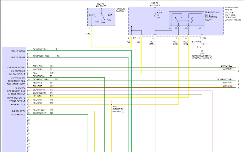

hello i have a 2001 dodge caravan 3.3 this van is in limp mode there is no power going to the eatx relay i used a test light to try to get the relay to open but it didn't doing any thing checked the wires form none broke can you please help me? thinks

Check fuse #15 (20 amp) in the Inteligent Power Module.

yes i checked the fuse it has power on it but no power is going to the relay pins 86 and 30 there is power on 87 but not on the rest.

For your viewing pleasure.

Are you sure it is power on 87? Looking at the schematics, if fuse 15 has power, then relay terminal 30 should have power. I think that your relay is backwards. Not that it matters. It will work both ways. Just trying to clarify pin identification.

fuse 15 has power but 30 on the relay does not have power only one pin has power that is 87
