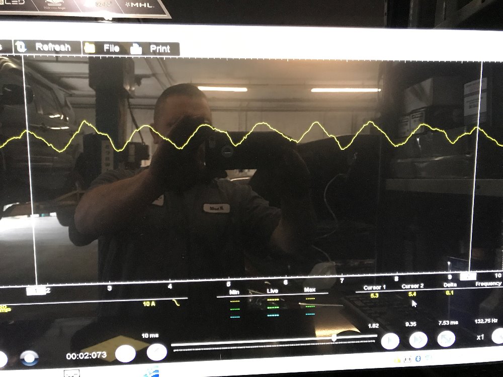

Hello everybody! Have a non Honda like issue here.... 2009 Accord 4cyl. 75k on the clock. Extremely well maintained. Woman came to shop saying it runs terrible. She came out to the car with me and sure enough... extended crank... started on 1...then 2... then finally all 4 began to hit and the car idled. Mash the throttle and the engine attempts to slowly rev- pops out the air box and will barely make it past 4500rpm. She was lean for sure so. Only codes stored in memory are a p0171 and P0300. Here is some data:
-STFT +46.9 at all times
Maf- (nice and clean) 2.8gps at idle, 1.25v at idle- hits about 3v when it makes a feeble attempt to rev
AFR- 16.2 at idle- hits 27:1 under snap throttle. If I blast some propane into intake- I can get trims into the +20 range and AFR drops back to 14.5ish.
Fuel Pressure- 50psi
Injectors at idle 3ms- snap throttle 15-17ms
I checked for vacuum leaks even though in my opinion this is way beyond a vacuum leak- found nothing. I honestly thought for sure I was going to have low fuel pressure but not the case. Even under snap throttle bogging- fuel pressure stays at 50psi. I did a quick current ramp of pump and I need a little assistance as to what I'm seeing. Am I correct in thinking that pump rpm is right around 8000? Does the waveform look ok? I was expecting to see less rounded humps. I asked the lady if there was any chance she filled it up with E85 but she doesn't remember putting gas in the car in the past two weeks. I took a sample and its brown in the jug and smells like gas so I'm not sure on that front. Thanks for any advice!

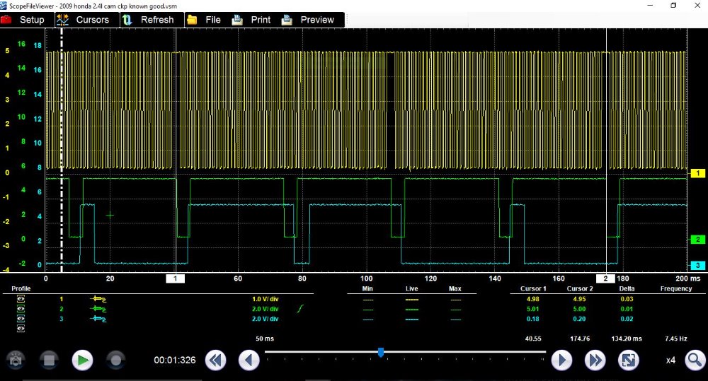

I just had one of these in the other day with a jumped timing chain. All I had was a p0300. Thing wouldn't rev either. If you don't have an in-cylinder pressure transducer you can grab both cam sensor signal and the crank signal and see if they are off.
Here is a known good you can reference with.
CH1 (yellow) = CKP
CH2 (green) = Intake CMP
CH3 (blue) = Exhaust CMP

That fuel pump waveform looks OK to me. You're on a pretty fast time scale, so it's not unusual to see rounded peaks like that. 8000 RPM sounds a bit fast, but there are newer pump designs out there that spin faster than what I'm used to. *shrug* If the pressure is in spec, and you saw good flow when you pumped the tank out, then I wouldn't sweat it.
