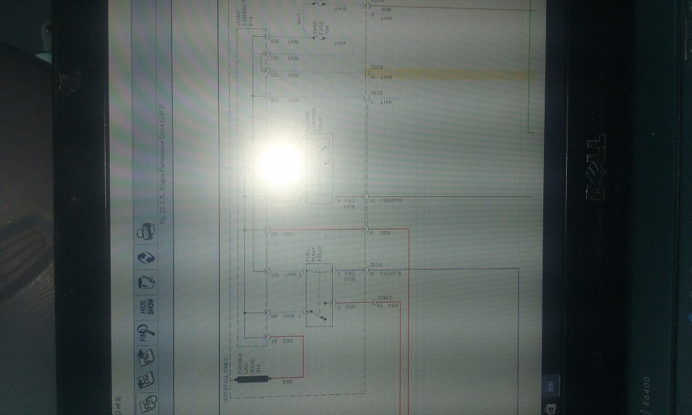

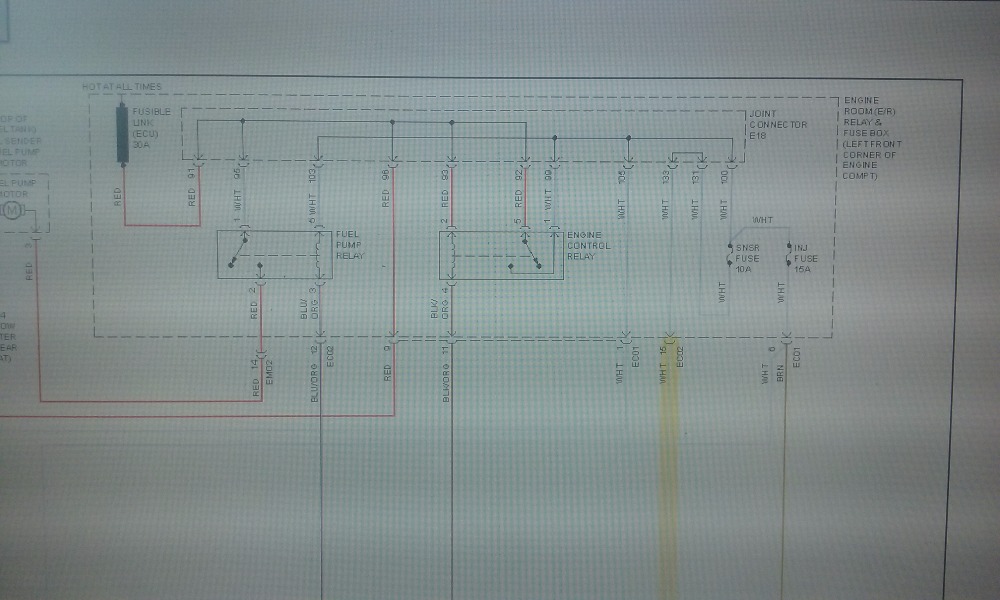

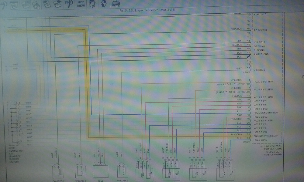

i have a 900milliamp draw ive isolated it to fuse 2 in under hood fuse box then looked up diagram on bbb (i dont have access to my mitchell here at this shop) i then disconnected the sensors till i got to the mass air flow sensor and the draw went away.... i disconencted ecu and checked for short to ground but had none i have power and ground at maf all the time and maf is warm to the touch . is the ecu causing this? im currently looking at the jojnt connector and it doesnt look like my diagram am i missing something does anyone have a better diagram?

9 years 4 months ago #10188
by Ben
Replied by Ben on topic Re:05 hyundai tucson battery drain
great thanks noah thats what i wanted to know

9 years 4 months ago #10191
by Ben
I didn't have time to fix it yet but I found the problem it has no power to the main relay and to fix that someone jumpered from 1 joint connector to the 1 that the main relay powered up so that circuit was energized all the time I'll repair that main relay circuit and this will be fixed. thanks for the diagrams Noah that was what I needed bbb diagrams were in rough shape for this car and I could read that section of it
